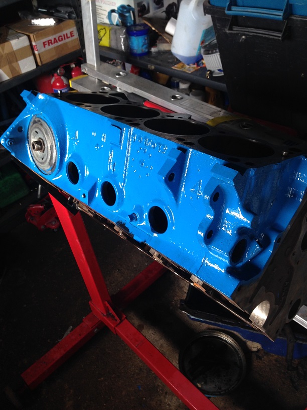

Then the block got stripped of all the old paint and a good wash down to clean the bores from the re hone. And the Block got a new lick of paint.

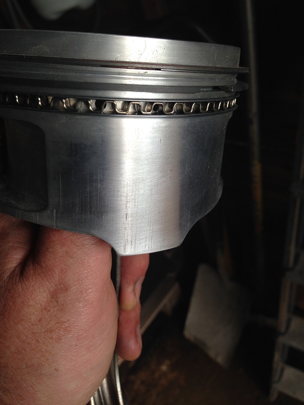

I gave the pistons a bit of a clean up, not great but better than how they came out. And Total Seal rings fitted.

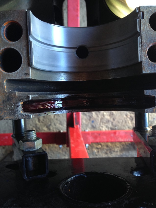

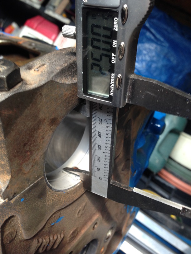

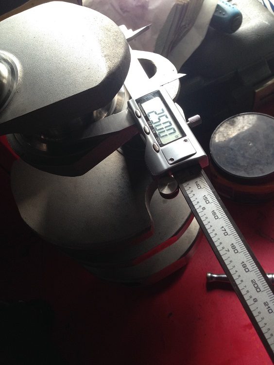

A measure up of the mains and crank, and plenty of Bearing Guard on the shells.

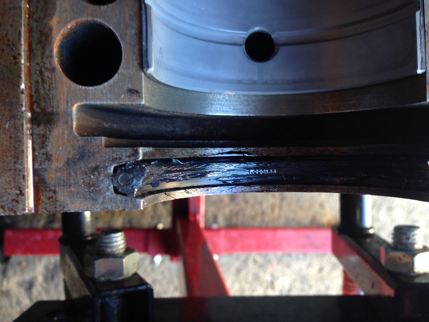

Almost forgot about the rear oil seal going in.
Used my trusty High Tack Gasket Sealant in the groove then placed seal into grove gluing it in. Then Greased around the seal.

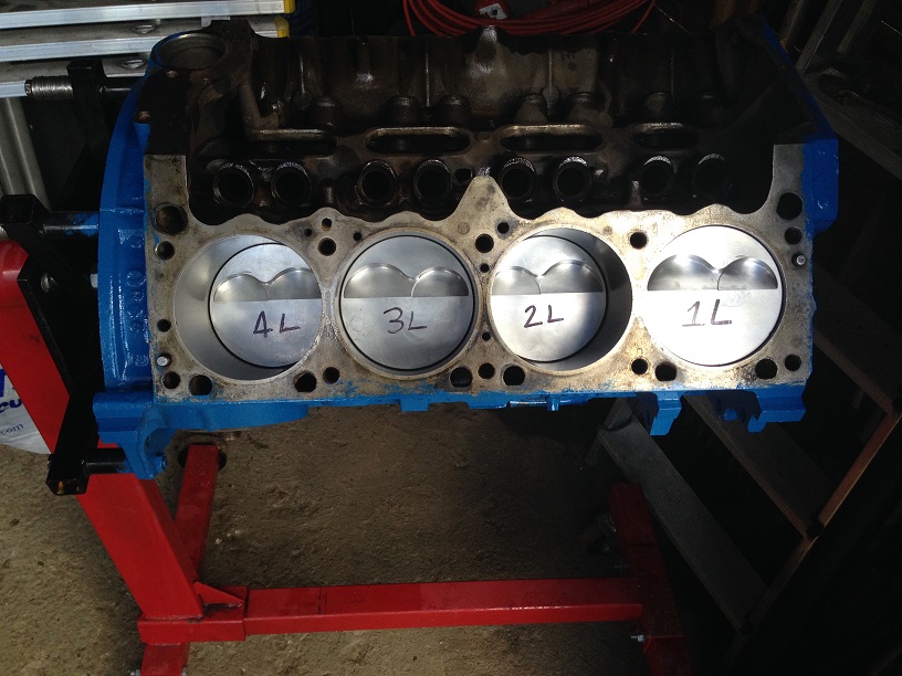

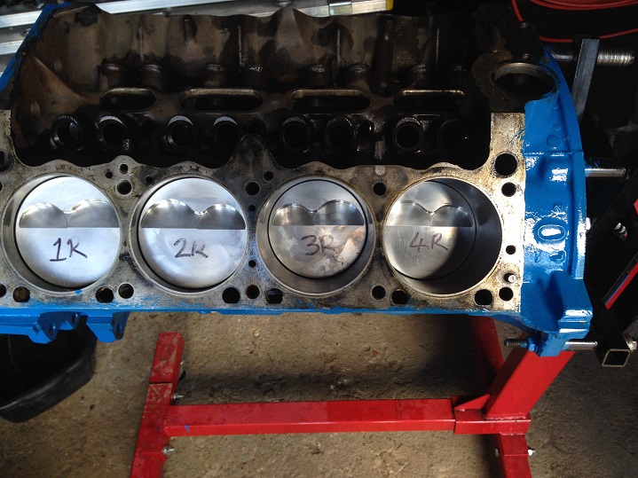

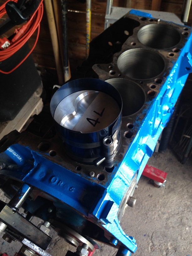

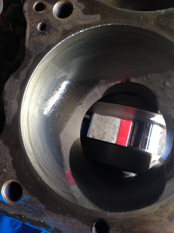

Time to pop the Pistons in at last. The Bore got another good dosing of oil as did the ring compressor. Yippee the Pistons are finally in the correct cylinders. And as you can see there is a noticeable PTW clearance now.
