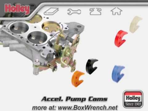

I've got a 29 and 35 shooters, 6.5 pv and numerous jets but 35 seems quite big for your car. Put your vac gauge on and tune it for max vac, what are the idle screws set at ? Also you could try different positions on the pump cams.
What do you mean by this mate?
Jon
Holley use various pump cams to alter the timing and duration of the pump shot through the accelerator jets. These quite often have two or sometimes three holes in a cam so the shot can be advance or retarded to help with tuning
