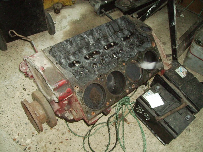

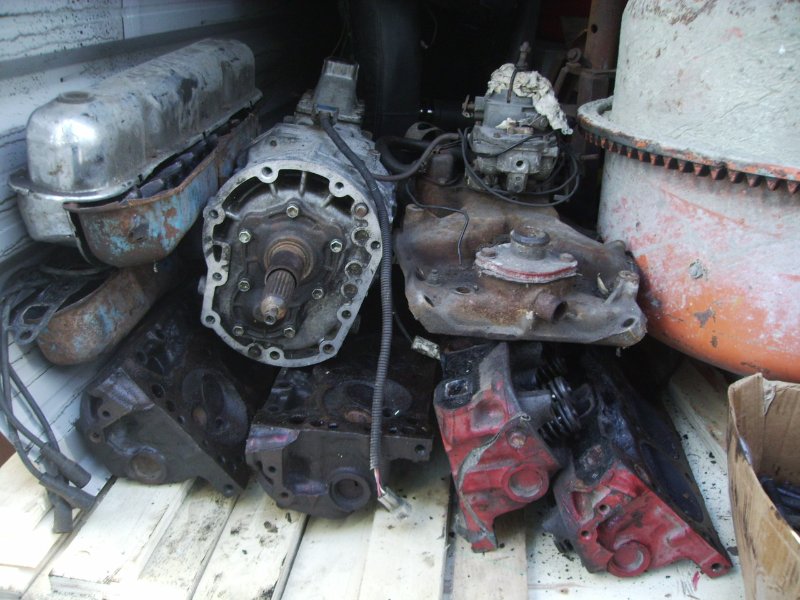

boy it was hot out today, 34 degrees in faversham apparently. anyway i got yesterdays haul unloaded and packed away, some in my van and the short block in the garage ready to tear down. it looks like a load of crap but it'll be just fine
- IMG_0012.JPG (140.27 KiB) Viewed 2328 times
- IMG_0011.JPG (113.96 KiB) Viewed 2328 times

my van's another shed until i get round to getting an mot on it again. there's a stack of box profile roof sheets under all that you can see, they were cheap and i'll use them sometime

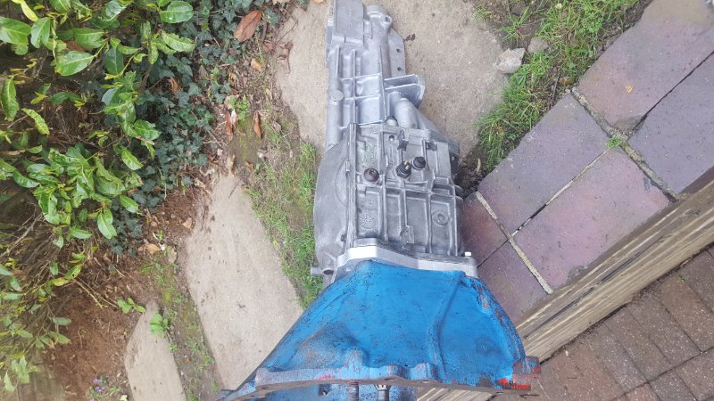

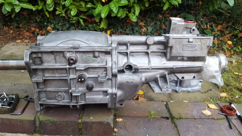

i have a small update at last. i bought the tunnel rammed 318 from blue's valiant along with bellhousing,flywheel and clutch. also i sold the supra gearbox for a profit and bought a 5.0 mustang t5 box for £200 less.

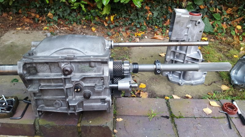

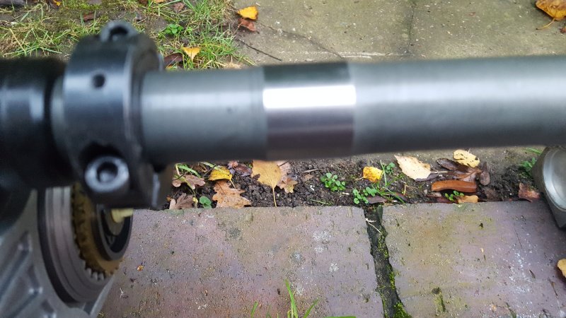

T5
mustang T5 has centre back shift box
GM has truck s10 front mount Gm shift box, good for TVR, or rear mount GM shift box But the rear mount on the tail housing has a offset mount. its about 35 degrees off from parallel with the ground these T5s were run at an odd angle and suffered oiling issues
GM holdens used a rear mount shift box with a ford shifter
or another version so far back it overhangs the yoke ford style shifter box but you need a special small yoke
Aussie ford used mid back (mustang style) or rear position depending on year
aussie tail housings are world class so can cater for a reverse idler and brake on 5th gear
aussie tail housings have the speedo drive in the same place on the tailshaft housing as US spec gear based speedo but the gears are backwards due to the hole for the speedo bullet being in the other side of the tailshaft housing, only causes you an issue on a LHD car you need a very long speedo cable and aussie drive gears
post 2000 ford T5s use a tone ring electronic speedo with the hole up near the main case
the output shaft has a bulge where the speedo gears should be but no hole for the speedo drive in the tail housing. a split collar and some thin steel shim can be used to hold the speedo drive gear clip as the bulge is not drilled for the clip and the metal is hardened so drilling is quite hard.
aussie T5 all used a different pitch to the gears so only top covers cases and tail housings and bearings work
but the tail housings certainly help with stick positioning and conversion to geared speedo drive.
jeep or big block throw out bearing carrier fits ford IBR both aluminium one and steel one. if you have the option swap to the steel bearing retainer but you may need to reshim the box, keep in mind two lengths of input bearing retainer and 2 lengths of input shaft.
ford racing CobraT5 used a different bearing retainer a pocket bearing or cone bearing not standard rollers
ford boxes came with long and short input shafts
the long one is long enough to put you in a position where
a standard 318 bellhousing on an 18 -20 mm adapter puts the end of the input spline level with the face of the flywheel and leaves the spigot end of the input shaft floating in the crank register area occupied by the spigot on a normal torque converter. i.e just short of the inside the crank based standard mopar spigot bush
no bother
get a mustang and a dodge dakota roller spigot bush and swap the ford roller into the dodge carrier
whack it into the register in the end of the crank and position the roller so the spigot end of input shaft rolls in it
OR and this could be internet codswallop there might have been a t5/mopar/jeep cross over from AMC based engines to mopar engines ford pattern T5 bell ...but i have had trouble establishing if there is and its no use to me with a hemi 6 which seems to combine small block 318 and slant 6 pattern block to bellhousing set up into its own unique mess i.e some 318 holes with slant 6 positioned dowels so i didn't pursue it too far
i might have said all of this once before if so apologies
that's as far as i got....
dave

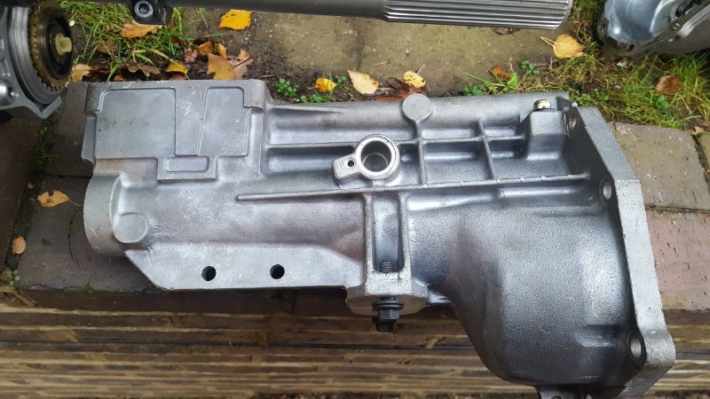

- 20171119_154813.jpg (126.57 KiB) Viewed 2276 times
- 20171119_154836.jpg (138.78 KiB) Viewed 2276 times
- 20171119_154857.jpg (122.55 KiB) Viewed 2276 times
- 20171119_155001.jpg (111.43 KiB) Viewed 2276 times
- 20190324_143814.jpg (141.77 KiB) Viewed 2276 times
- 20190324_145051.jpg (150.66 KiB) Viewed 2276 times

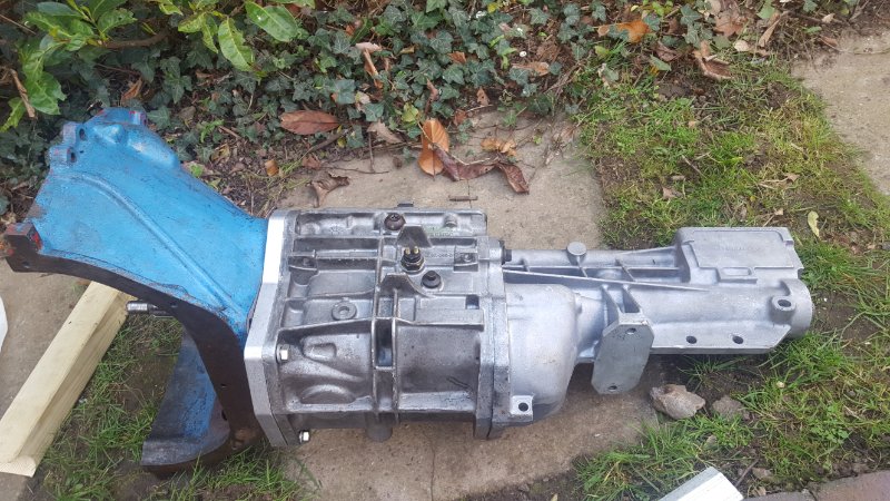

Re: 68 valiant signet 2 door
hi dave,
yeah i've looked into the t5 swap. apparently a mopar v6 (3.9 i think) bellhousing bolts to a small block and to a t5 but i've got a small to zero chance of getting one of them here so the adapter plate route is what i'll do. as for a spigot bush/bearing i'll make a bush on my lathe, i knew it'd come in handy.
cheers, neil.

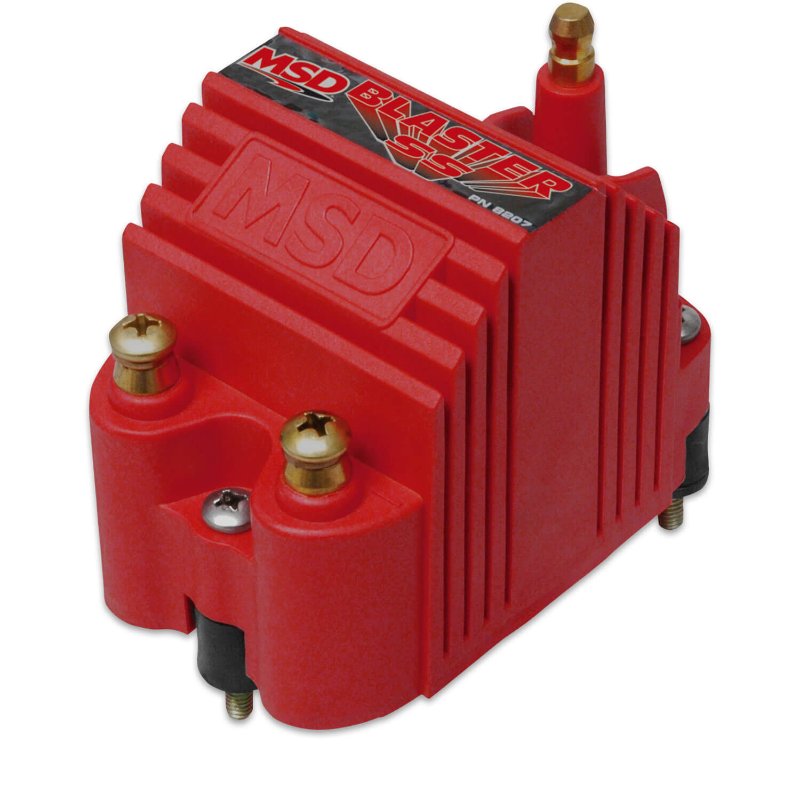

the coil and hei module arrived from china so all i'm waiting for now is the 'heat sink' grease goop for between the module and whatever i bolt it to (bottom of the dizzy probably).
my new coil and hei module, does the coil look familiar?
