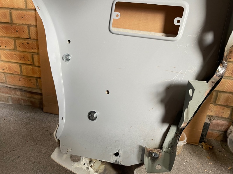

Scrub that , I’ve spent the last 20 hours and managed to get my new fenders to sort , well sort of !
Much much better than last weekends effort
Still will need some cutting and dressing on the left side but not to horrible.

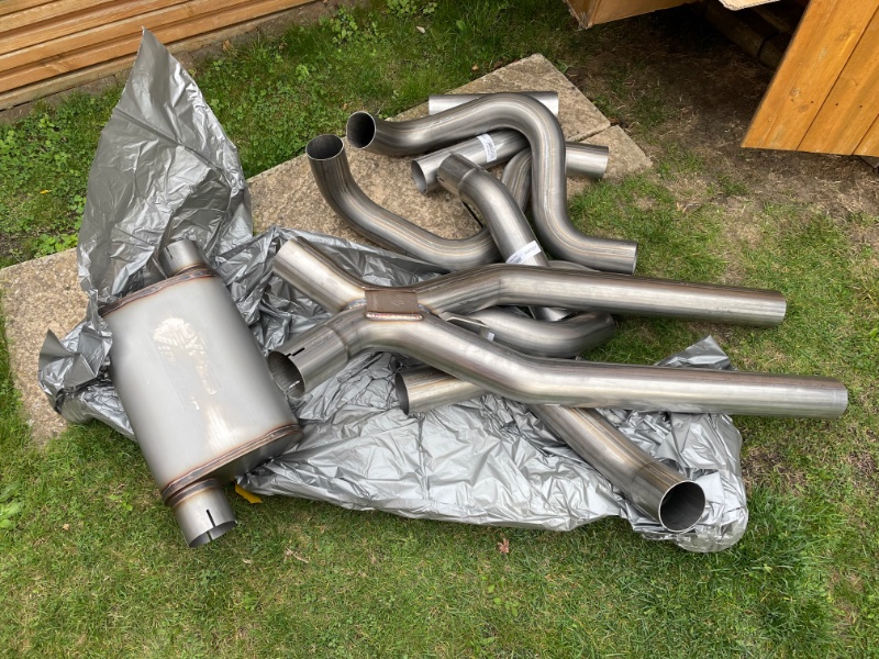

My Pypes exhaust system looks rather nice
Maybe a tad too large but meh !

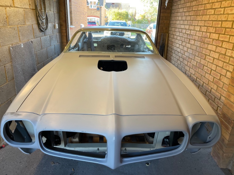

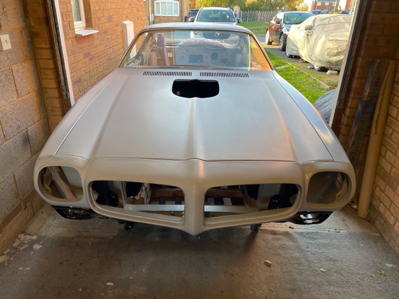

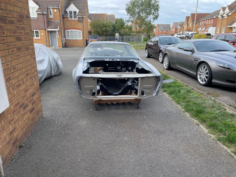

Well after another weekend Ive almost got the front short of aligned !
Absolutely crap way for building a car,
Shims and spacers, bending panels and a hundred different permutations to end up with something that’s just about acceptable,
Bit of an eye opener really,
The actual body tub is far more accurately built than my Challenger but this rubbish front subframe assembly and all it supports is totally crap,
Front chassis rails and inner wings all fully welded are far superior,
Its hardly surprising that they wasn’t successful in Trans Am racing, and ironic that they have the name !
The white car is the actual car that started my obsession way back around 1977’ ish
One ride in this thing and my Escort RS days were over ,
It’s taken me 48 years to actually own the very same model and specification, but not the actual car,

Re: My very last restoration!!!
So block huggers apparently won’t work with a 4 speed
Bugger, so going for Doug’s Long tube stainless,
And a hi torque mini starter to combat heat soak
This bloody car is ruining me!

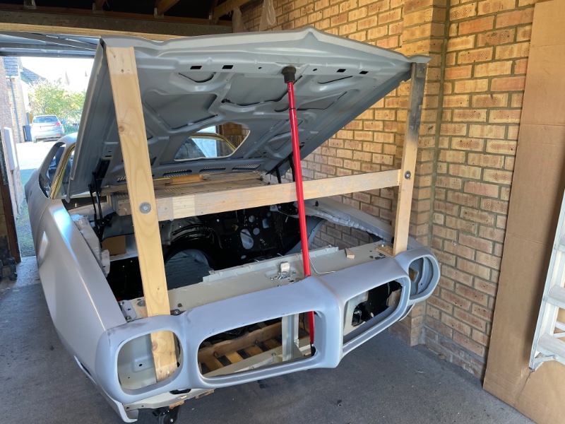

My Doug’s stainless headers and new mini starter were delivered today!
Excellent service from Summit as always,
And managed to get the front end pretty square over the weekend, so all good !
Had to fabricate a second pair of hands to assist with hood holding!
Going to take a break from the turd now,
Haha
Cheers, however done a couple of small jobs this week so far
My front quarters require a modification to the front edge,
Early cars like mine have a steel lower front panel,
Fiddly little bracket to remove from original fenders and retro fit in the new ones ,
My brackets had some corrosion so required some neat repairs,
Just test fitted them , all good,

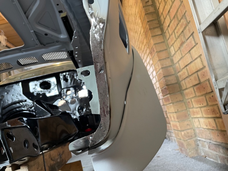

Back on the FireTurd today
Following a test fit of my fender deflectors which didn’t fit as the factory punched hole were completely in the wrong position?
Struggled to get an accurate template with card, thin Ali etc
In decided to take a moulding from my original fenders
Proper faff but didn’t want my panels to resemble Swiss cheese!
Worked perfectly
Finished replacing the lower front panel brackets
And almost got the car built back up,
You can see the strange profile on the fenders that made it difficult to copy, hence the GPR !
Worked perfectly

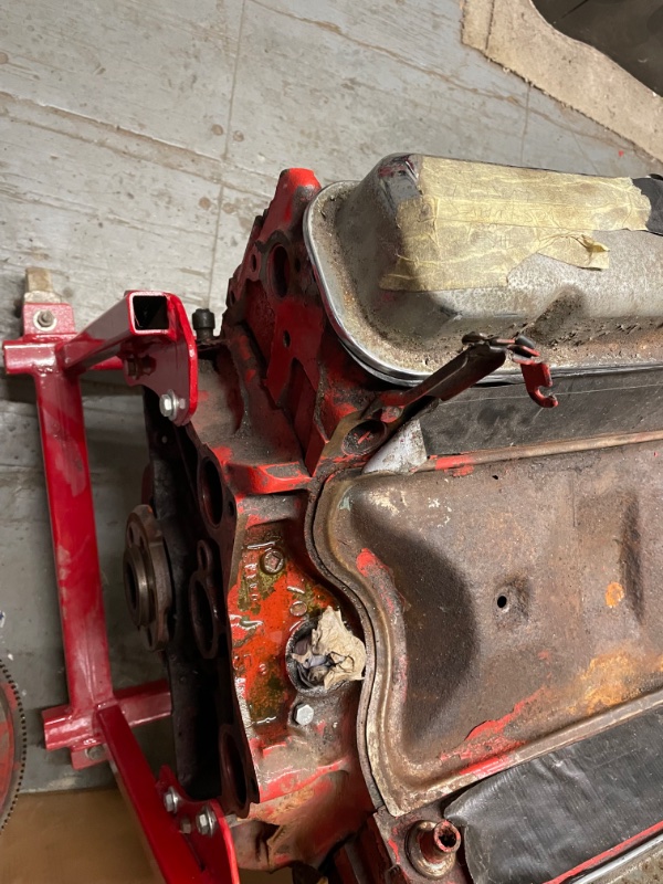

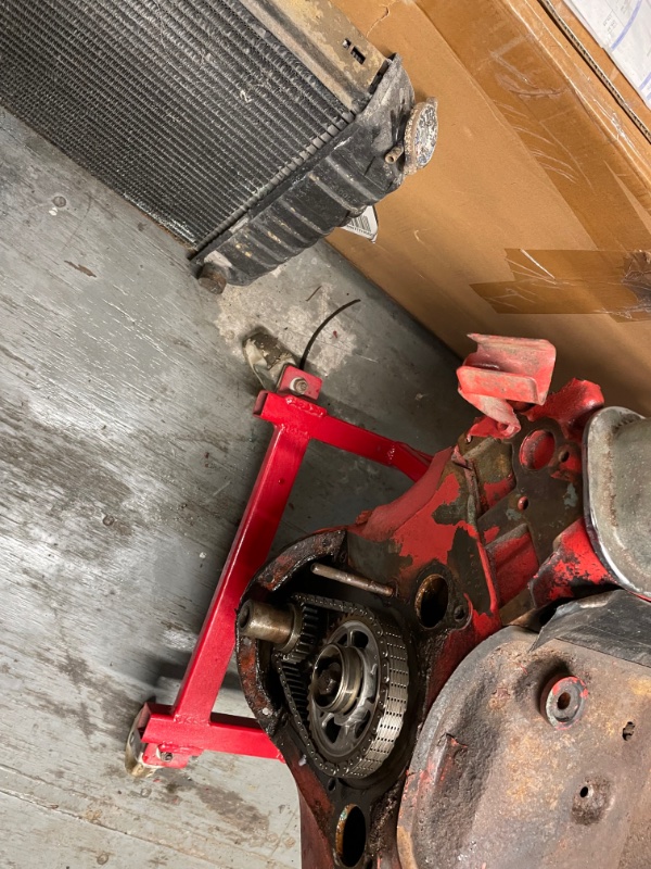

And I’ve finally started to pull the mill apart
Heads off next week hopefully
