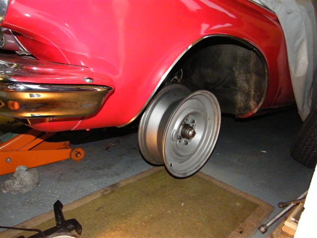

Thanks to Chris from Sheffield (previous owner of Jerry & Marc's new 63 Dodge project and a couple other spot-on Mopars before that 8-) ), we had the opportunity to bag a set of early 15" steels for the Polara, to go with the large dog dishes we bought some time ago.
Not exactly the style of wheel that would have been common on the Polara 500 when new as they came with the 14" steels & full wheel covers like we've got, but you cant beat the look of the early steels with the correct caps for these early cars, as anyone who know what they're talking about would agree :D
Just as we were finallising payment and arranging with Tim H to get them painted, I read on FBBO that these early wheels dont fit with disc brakes :shock: so I asked around a bit and despite being told they should be ok we asked Chris to send us one to try so we could be 100% sure. The wheel arrived last Thursday and we finally got round to trying on, on Sunday afternoon :roll:
Thankfully the 'expert' across the pond who was adamant that they wouldnt fit, didnt know quite as much as he thought he did, and the wheel fitted fine over our SSBC calipers and discs \:D/
I'm sure it doesnt look like much of a big deal to most of yous guys but we've been after a set (these are 15x5.5 & 15x6) for the last few years and it's good to find a set over here and not have to buy from the States.
So a big thanks to Chris for giving us first dibs, and puting up with our deliberations :scratch: :lol:
This will free-up the other (late 60s) 15" set we bought a few years ago from the States, so we can use them on the Satellite. Just to wind up anyone who doesnt like steels & dog-dishes :lol:
So just need to get them painted and find some tyres... :? £££££££££££££
Trust me, it'll look better painted,  with the dog dish and a tyre fitted

Plenty of clearance....

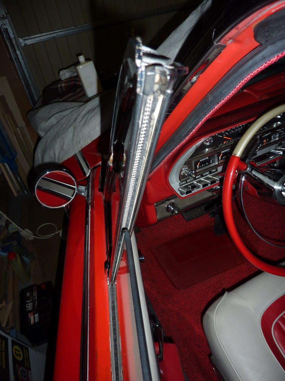

Wasn't sure whether to tack this request on the end of this thread, or start up a 'wanted' thread...
anyhoo..
There’s a couple of the window weatherstrips I would like to replace.
1. The one that attaches to the front vertical edge of the rear roll up window. This fits inside a st/st channel that’s fixed to the glass. Approx 18” long.
2. The vertical one that’s inside the long channel run of the vent window frame. Approx 36” long. Leading edge of door glass runs up this.
I had a look last night at a few sites, google links etc and could only find the first one for the rear roll up window. This is on Metro Molded Parts site, part no VS7-A/FL. $39.35 / pr.
Couldn’t see anything on Kramers, Steele, Herb’s etc for the other one. Didn’t look at YR1 yet tho as they never used to do early stuff.
I took some (poor) pics below.
Has anyone been able to source the w'strip that goes in the front vent window channel?
I have got some generic reinforced U shaped w'strip (from the NEC last year) for the channel that guides the rear edge of the door glass. Maybe that would fit? will have a look in case.
