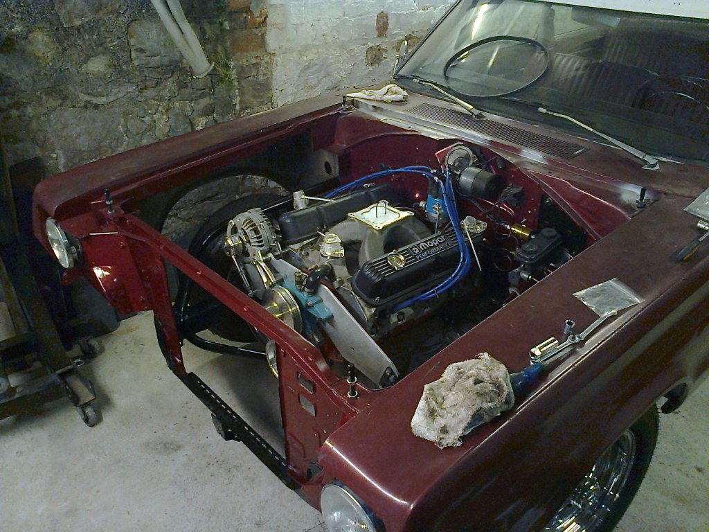

Just got the motor back in this evenin :D

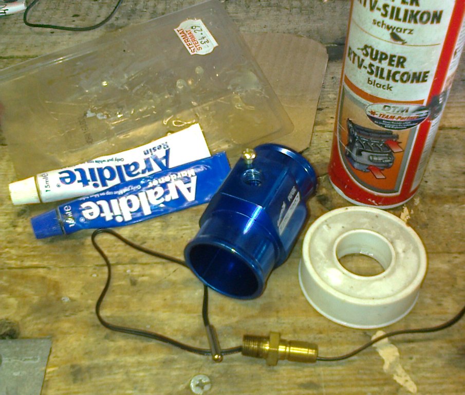

I'm off to the garage now to make a bracket for the water temp & oil press to sit in the mouth of the cowl hood, and to fix the probe for the fan controller into the top hose.

db wrote:...... and to fix the probe for the fan controller into the top hose. :thumbright:
Plenty of PTFE :thumbright:
Or has it got it's own collar to sit in :shock:
Fitting fan sensor.jpg (135.43 KiB) Viewed 1362 times

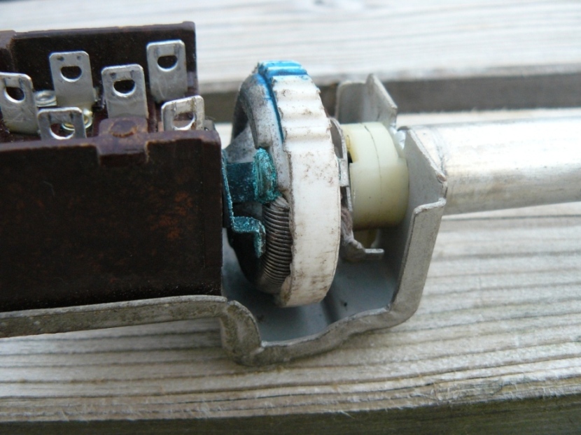

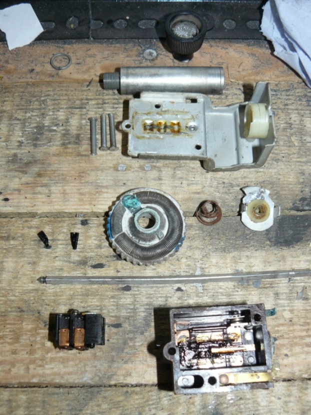

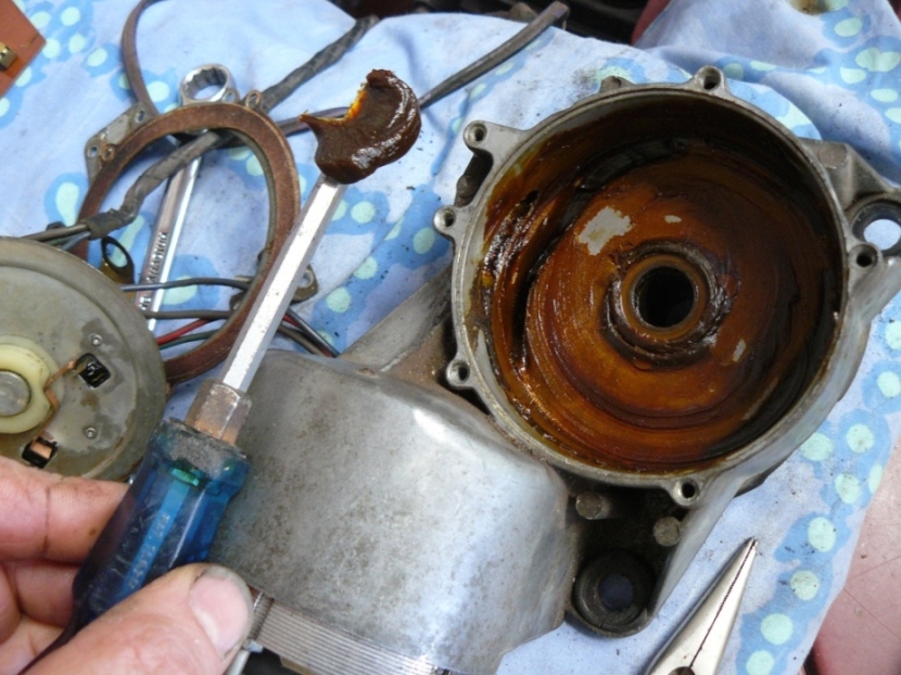

Anyone ever worked out why the wiper motor and switch have to be so bewilderingly complex? Were they designed by comittee? :scratch:
We found the light and wiper switches had packed in, along with the wiper motor.
I've stripped the lot, cleaned/ fixed as necessary and they all work lovely now :D
The Wiper motor had beed packed solid with grease which had baked to a nice treacle and seized the gearing!
The wiper switch control shaft was stuck in it's housing because the aluminium had worn and the resulting ally powder was jamming it. I had to fully dismantle it though just try to figure out how the hell the wipers actually worked. Bizarre!
The light switch was in a sorry state. Corroded to hell and the rheostat (dash light dimmer) had come apart. I cleaned it all out, cleaned all the contacts with WD40 and scotchbrite and re-laid the rheostat on a bed of araldite. It was originally riveted together, i had to replace these with bolts. I had to grind the bolt heads to fit and sleeve one contact with heatshrink. Sorted :thumbright:
