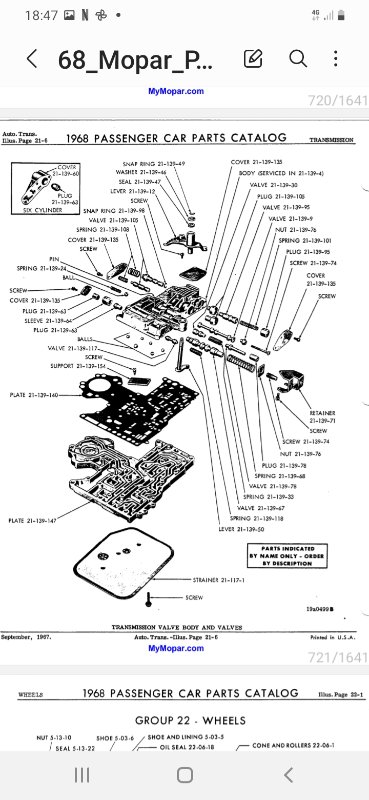

Re: Johnny's Dart repairs
Section 21. 1 Auto trans......
Screenshot_20260604-184622_Samsung Notes.jpg (62.43 KiB) Viewed 447 times
Screenshot_20260604-184634_Samsung Notes.jpg (77.97 KiB) Viewed 447 times
Screenshot_20260604-184720_Samsung Notes.jpg (71.57 KiB) Viewed 447 times

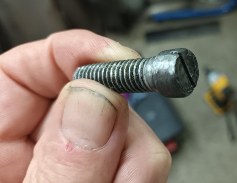

More pics of rouge bolt.
Posts: 7613
I did a google image search and it came up with it being typical of a Mopar trans casting.....may narrow it down to at least knowing it is part of the gearbox and hasnt crept in somehow....

Bit more AI digging
Posts: 7613
Im doubting this now as Blue doesnt recognise it and it says it has a square head. .....mmmmmm......Im intrigued now ....

I've got both band adjustment screws, I guess I'll find out later as I get further through putting it back together.
Posts: 14582
I notice the front servo lever isn’t in, Could that rogue bolt be being used as it’s locating shaft?

Blue wrote: Thu Jun 04, 26 7:54 pm I notice the front servo lever isn’t in, Could that rogue bolt be being used as it’s locating shaft?
I've got the correct pin and blanking allen grub screw.
I'll have another good look tomorrow

Mystery bolt identification solved.
It was the bolt I used with the slide hammer to remove the oil pump front cover in the bell housing.
It suddenly came to me. Old age issue.
The clue was it didn't smell of auto trans oil. #-o
