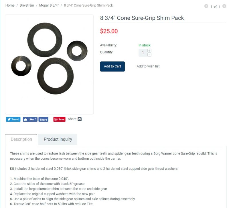

Shim kits for cone-type SureGrip are available from the guru Doctor Diff. Will probably add one to my next surface-freight order

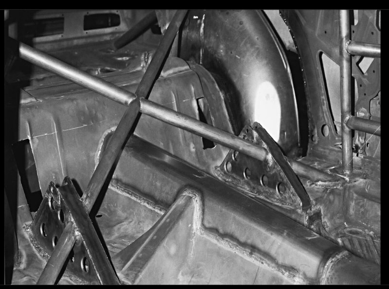

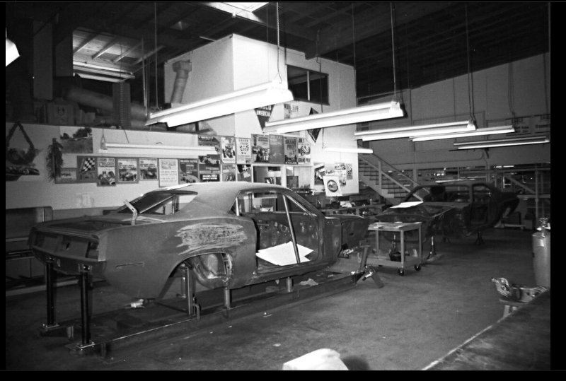

Race Cuda shells on the Chassis jigs at AAR . Looks like panel beating has been started on rear quarters
Interior. Note tunnel mods ! No surprise that I had propshaft contact issues trying to replicate the ride height ! Maybe another job for the winter.
Fabbed brackets on floor will be for upper axle links to reduce axle tramp. I believe they accomplished this by installing shock absorbers horizontally in this position.
Looks like wheel tubs are in the process of being moved inwards.

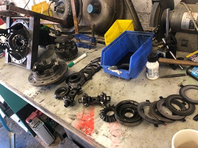

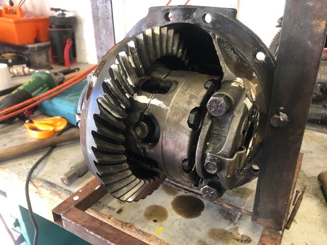

Clutch-type SureGrip disassembled for recon. I had to re-use the ring gear bolts from the donor diff as the bolts on my existing gearset have larger-dia shoulders to locate in the later size carrier holes and will not fit in the earlier carrier.
diff ready to install

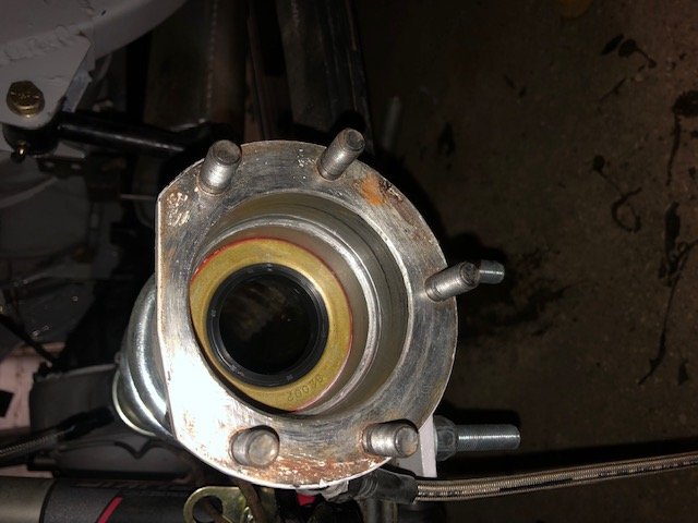

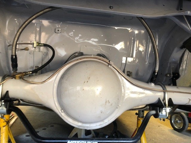

New seals in the axle tubes
And new, additional breather on the right hand side of the axle. Good opportunity to drill a hole, and weld a steel -6 fitting to the axle whilst everything was apart

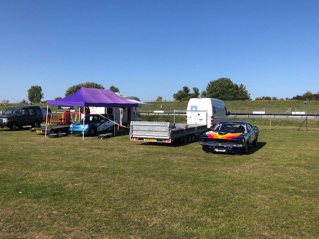

Thruxton Friday evening 20th September - parked up in a nice spot with Gary and Charles and their Mini . CSCC race weekend .
None of us had ever driven at the track before so a couple of laps by bicycle were in order.

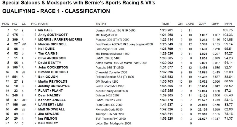

Qualifying was early, at 9am . Always a learning process at a new track. Thruxton looks uneventful on paper, but it's very fast, and the shape/exit of many of the corners are not particularly visible as you enter, due to the contours of the land. I made a few small errors on the first laps that I won't be repeating in a hurry... you could run out of tarmac really quickly here.
Race One I ended up holding myself up behind a V8 TR7 that was slightly slower than me , but which I couldn't quite pass - being very wary of going offline on the faster sections.

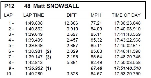

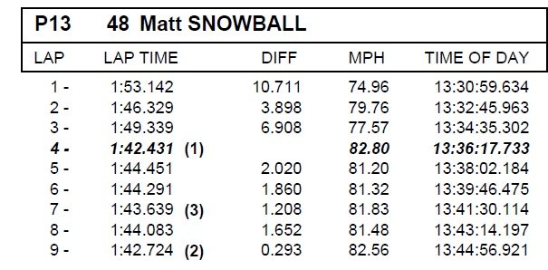

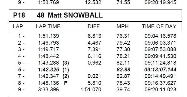

Lap times from race 1 :
I didn't improve on my qualifying time at all , which was disappointing.

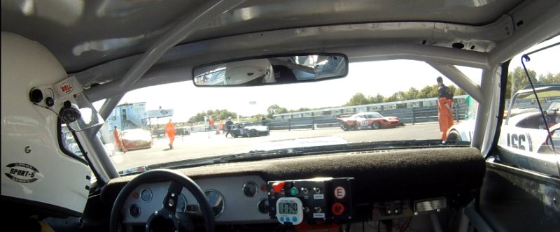

here's two laps on You Tube (Cheng is in front of me - he's on old tyres which explains his relative slowness) . The second lap is the fast one. Still much room for improvement though. I was so happy with Allard corner (right-hander just after the pit straight/ finish line) that I got increasingly untidy through the chicane following it...

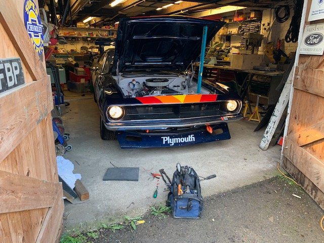

I'm at Donington next weekend with the CSCC, and the regs require working headlights.
Fortunately these units drop pretty much straight in, and I'd already installed the necessary wires in the car's loom.
Still got to trim round them. I was going to install more polycarbonate rings cut from sheet, but I've just seen these which might do nicely.

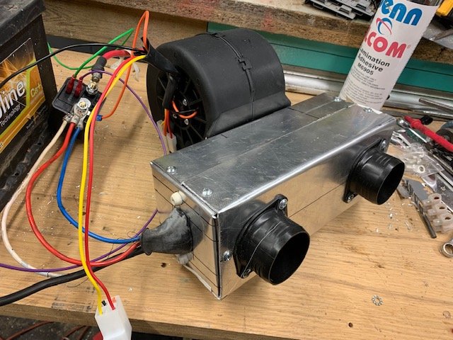

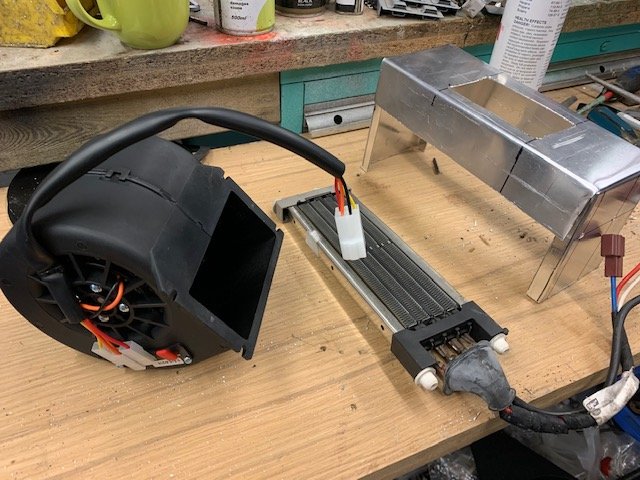

I've been pretty lucky with the weather so far, but it's going to be wet or cold at some point and the car currently has no demister. I could go standard hot-water style, with hoses running to a small heater in the interior, but though i'd try something a bit simpler and more compact.
Many new cars have an ceramic electric element used for the screen demister when the engine's cold.
Need to get one from a car about 10 years old as the newer ones are too high-tech with built-in digital control circuitry.

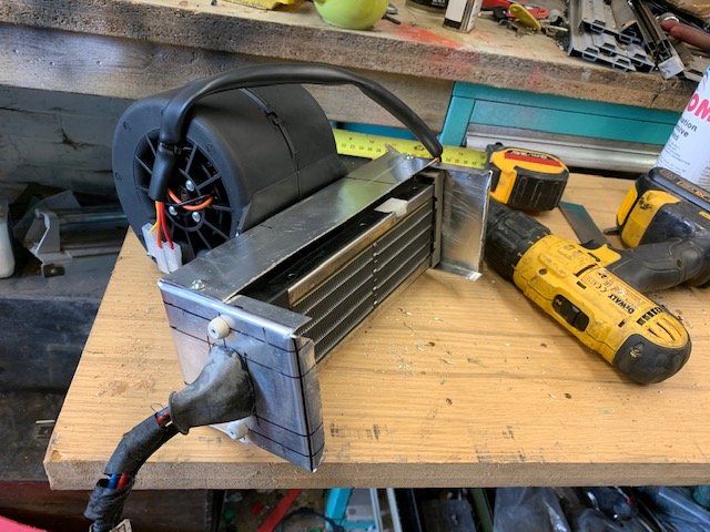

Add a fan from Car Builder Solutions, and some sheet ally.
And it works ! (With apologies for hasty sheet metalwork...)
There's plenty of airflow, and it gets quite warm. The unit is pulling about 40 amps, which the charging system *should* support, and there's already a handy terminal stud on the car's main battery cable near where the heater will go.
That's 2/3 of a horsepower...switch off when overtaking
