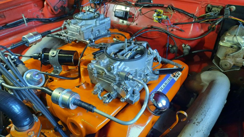

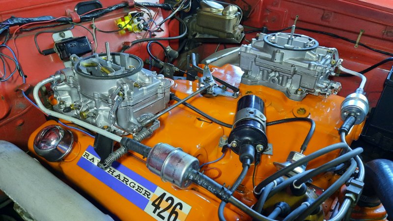

The fact that we haven't posted on this thread for so long shows how reliable the car's been over the years, so we were a bit surprised and disappointed that it started playing up around the time of the 2022 Euronats :roll:
Just put this on fb so I thought i should get it on here before I get told off ;)
Haven't used the 63 for over a year as we've been chasing a misfire which became a no-fire! :roll:
We replaced all the ignition parts (Firecore distributor, coil and leads) but found the dizzy didn't rotate freely #-o so with a fair amount of help from our MMA mate Ian Mitchell (Herts meeting regular), we got it stripped and rebuilt back to where we could fit it.
In the meantime, Geof Hauser gave the carbs a once-over... not the full refurb we wanted but a quick clean and check there was nothing obviously wrong with them.
Ian came over last weekend to help install the dizzy correctly :oops: and we got it started and idling without a misfire for the first time in ages \:D/
Took 'her' out today to make sure it didn't misfire or stumble under load. Which it didn't thankfully.
Driver side plugs are still very sooty and the carbs don't really respond to mixture screw adjustments so they still need a proper looking at, but happy the car's up and running again :D
I did add a couple of short vids on facebook but you'll have to make do with this obligatory engine shot ;)

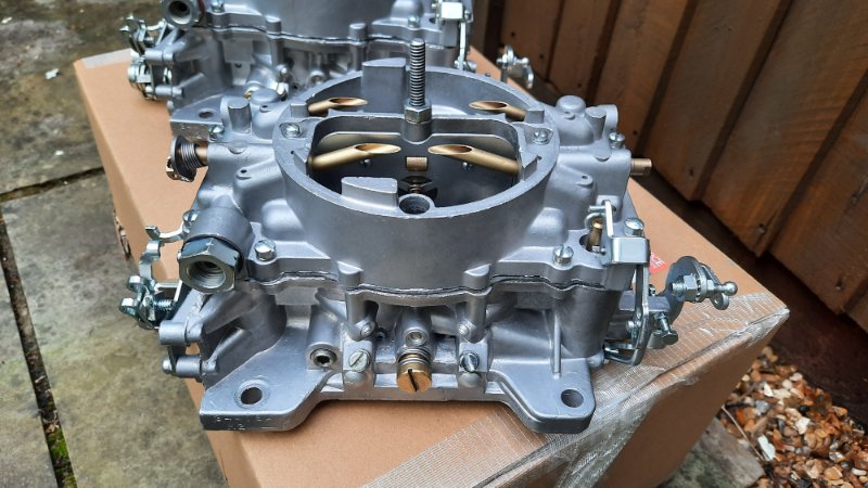

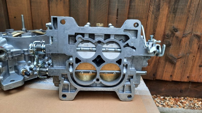

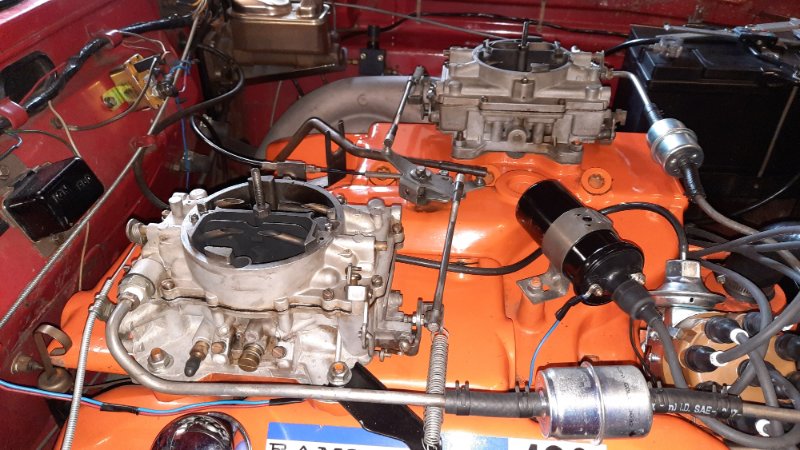

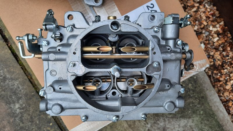

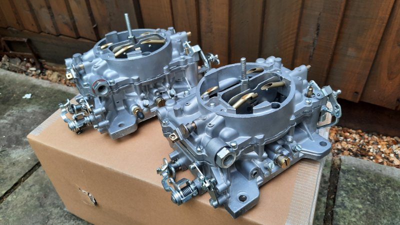

So... a couple of months back we got to the point where we realised our original (to the engine) carbs really could do with a proper rebuild. They were supposedly rebuilt 20 years ago just before we bought the car but judging by how the rest of the engine was thrown together, they probably just had a rudimentary clean up at best :roll:
As no one we knew wanted to get involved we had to take the chance on finding someone ourselves and settled on the safer option of a UK company rather than shipping them over to the States or Canada. Best option we could find was Coln Engineering down in Gloucester. They had some experience with Carters which is quite a rarity over here so we took the plunge and dropped them off with them the week after Easter.
https://www.colnengineering.co.uk/
After discussing what we thought was needed, and what they could offer, we agreed to have them disassembled, ultrasonic cleaned, spindles rebushed, steel parts replated, reassembled and bench set-up and tested. We supplied a rebuild kit from Mikes Carburetor Parts https://www.carburetor-parts.com/
which arrived within a few days and a screw kit from Laysons Restorations
https://www.laysons.com/
which took a few weeks... true to form, but at least it arrived! :lol:
I'm still waiting for any photos that Coln took during the strip down and rebuild but here's an idea of what we started with...
Then after 5 weeks (3 weeks waiting and 2 weeks work) they came back good-as-new 8-)

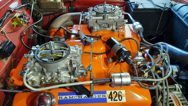

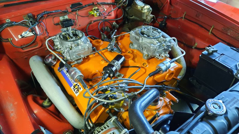

Then today, with the help again from MMA-mate Ian, we got them fitted with new fuel lines and spent a bit of time (understatement) setting the idle mixtures and getting them balanced.
Then on the 2nd turn of the key 'she' started right up and was idling smoothly within a few seconds - rather than the usual few minutes after a few turns of the key!
Road test started off well too; no stumbling or pinking under load, but after a while we did notice a bit of hesitation under load :-k

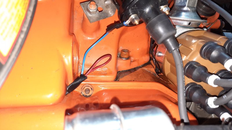

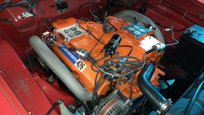

Back in the garage, earlier suspicions of a vacuum leak were confirmed by spraying some WD40 and brake cleaner around the base of the inlet, in the only place it's accessible (centre of this photo, where the inlet meets the head). We confirmed there was a leak using the the rubber tube in the ear method - we could hear a similar noise to when we put the other end of the tube in the carb, for balancing :shock:
So just when we thought we were all set to use it for Brooklands, we now need to replace the inlet manifold gasket(s) and may as well do the valve cover gaskets while we're at it as they are tricky with the inlet in place.
One step forward, one step back, but getting there :roll: :lol:
