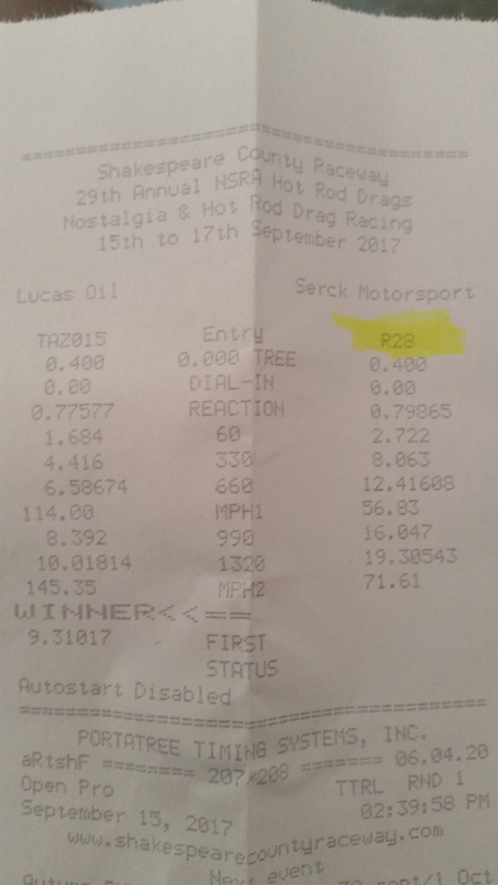

The Proof:

See what your saying but in reality my fiberglass hood with its massive scoop is not really the height of aerodynamic efficiency. I'd be interested to see your timing slip, as if your crossing the line at the same speed I'd expect out ETs to be the same, not 1 second apart.
Being honest I was expecting and would have been happy with something in the 17s. The 19.3 to me proves that the motor, though reliable is a performance dog with a crap CR. All I can find is that in 77 it was dropped to 8.5 1 at 145hp. Given that it's an unknown entity and an old rebuild, then I'd expect my HP numbers are quite a bit lower than that.
