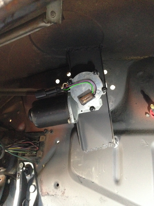

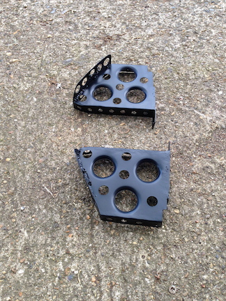

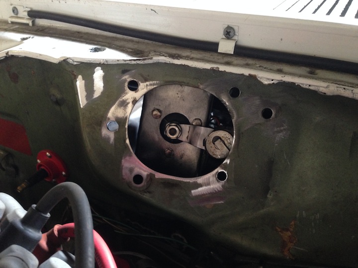

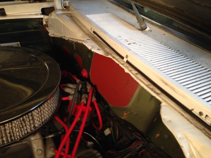

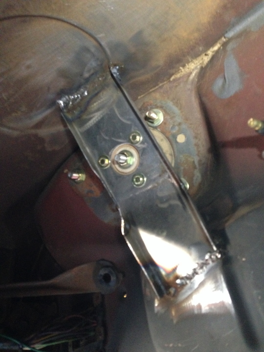

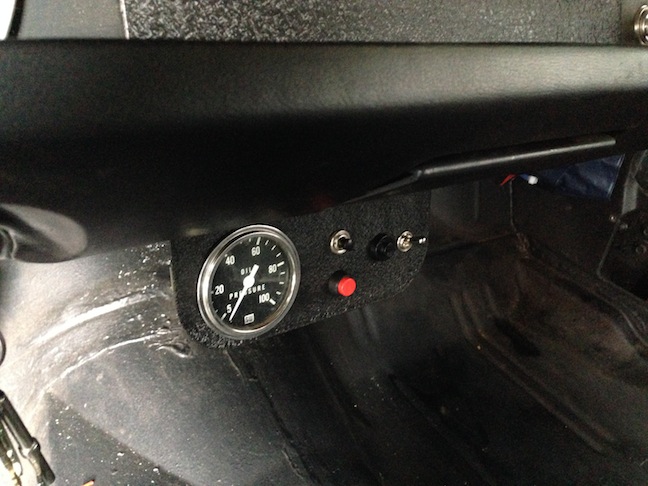

I had to get Dave 999 to figure out how to work the Astra wiper motor from a toggle switch as it has weird park wiring, a couple of relays sorted that out, cheers Dave! Made up a panel to hold the wiper, horn,washer switches and an oil pressure gauge, this is a temporary fix for now. Well pleased with the results and I saved 2lbs into the bargain...
Posts: 14502
Loadsa room!
It was me who questioned the sale of your old bits Blue.
Now I know why.
Great idea to move it all inboard to create room for working on the engine.
And save a bit of weight !!! ;)
You can always empty the bag for racing as well !
very clever :thumbright: :thumbright: :thumbright:
master at work

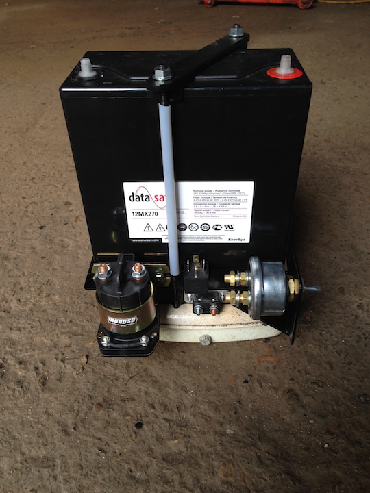

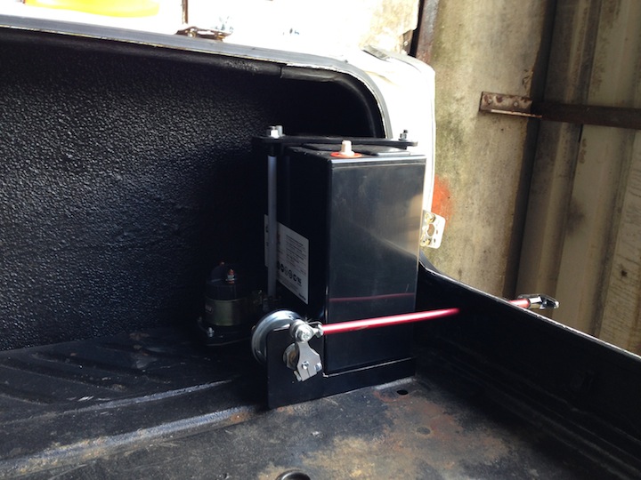

Made a battery tray that also holds the other electrical gubbins I need to have in the boot. The battery is a power vamp gel which has a hefty output for it's size, then there's an alternator cut off solenoid, fuel pump relay and circuit breaker and the master shutoff switch.

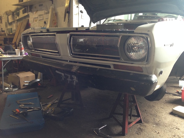

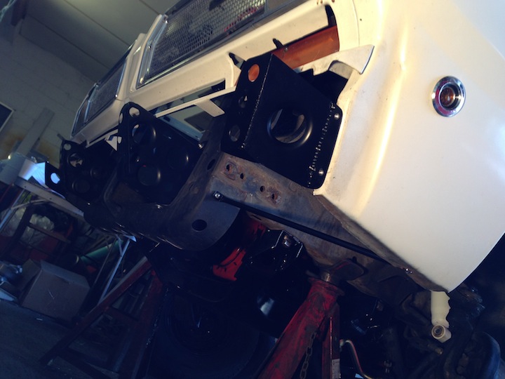

Front bumper brackets, they weigh 4 fifths of not a great deal so I think that's light enough. Bumper is a very used fibreglass item which will be fine when I've repaired it, it's held on by 4 Dzus fasteners, and the whole shooting match weighs a little under 3 lbs, so that's a 25lb saving over the original item. I also replaced the solid steel wing stays with ally tube.

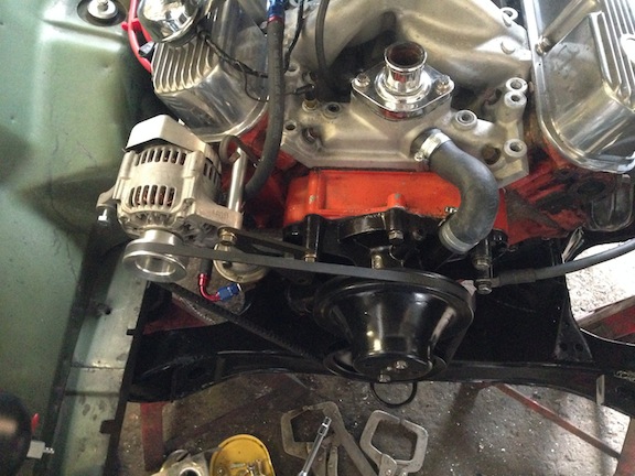

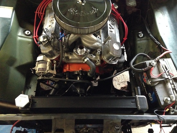

Denso alternator fitted, needed a spacer and a custom offset pulley for everything to line up, Trev can now supply these parts, just need to wire it up now, in fact a general tidy up of under hood wiring is long overdue. Fan, catch can and rad all fitted back in, need to find a suitable top hose next.

Liking the battery tray very much :thumbright: What type of paint did you use for your ally rad?
Posts: 14502
Painted the rad with Eastwood black satin radiator paint from Frost.
