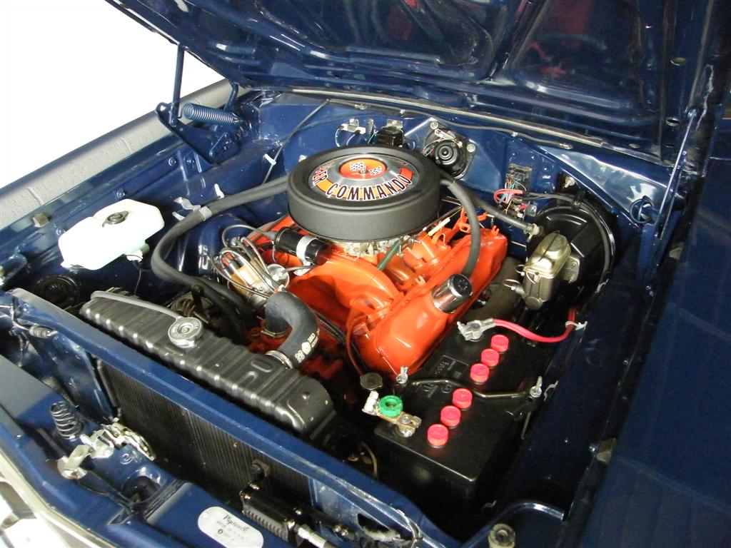

- At least the air filter assy fits under the hood, on top of the Edelbrock Performer - something we werent sure about till a couple of weeks ago. Phew
- DSCF1128 (Large).JPG (134.82 KiB) Viewed 2852 times
