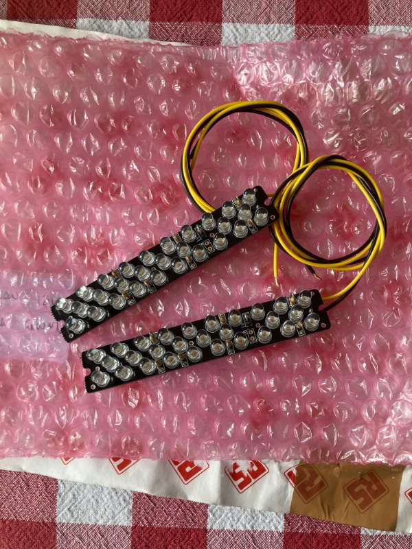

In other news, postie just delivered something I’ve been looking forward to getting.
I can finally look to get rid of the dodgy rear indicators that someone bolted onto the bottom of the rear overiders. They look like bowlacks dangling off the bottom of the car…
Always hated them, these should look nice and stock once I figure out how to fix them to the inside of the lenses.

I’m assured that the yellow LED installation is pretty straight forward, but hadn’t really considered exactly how I’m going to fix the panels inside the rear lenses…
LED Flashers.
I would mock up first before any changes and check that the Indicator relay will still work using LED's - they don't draw much / any Current so the Bi-metallic Flasher Relay may not work... you may have to add a resistor or two to make it function.....
