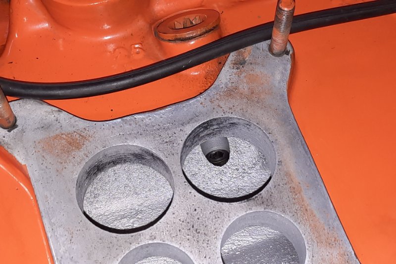

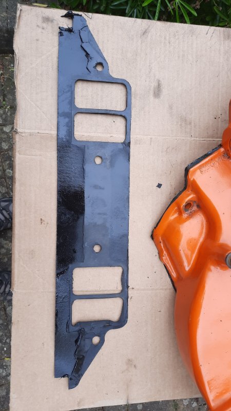

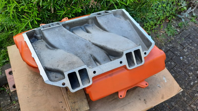

With the inlet off, we could see the main cause of the vacuum leak was most likely in the area we suspected (near the distributor) as the gasket had delaminated.
As it's virtually impossible to get the valve covers off without removing the inlet #-o , we also replaced the valve cover gaskets as there's always been a bit of an oil leak from them too :roll:
So, 4 weeks after finding the vacuum leak, armed with new gaskets and inlet bolts and washers, we got the valve covers back on, cleaned up the inlet, put a fresh coat of Eastwoods stainless steel paint on the exh manifolds and set about fitting the inlet...
The new inlet bolts came with spring and flat washers but it took a fair bit of jiggling and on / off and back on with the inlet (not good when you've already fitted the gaskets) before we realised that the washers dont fit in 6x counterbores inside the manifold, so the washers were stopping the bolts from engaging in the heads properly. Couple that with the fact that the 8 screws are 4 different lengths and they only fit if you put them in their intended locations #-o
Seems obvious really, and we did know that, but we had already noted what length bolt came out of what hole and it wasn't until we felt there was something wrong that we found that at least one of the bolts was originally in the wrong location so wasnt fully engaging with its thread in the head. This probably wasnt helping with the vacuum either, as it's inside the manifold :banghead:
This pic shows one of the 6x screws inside the manifold, accessed by removing the plug above. You can see the counterbore where the cap head is - this is where the washers were getting caught up and preventing the bolts from engaging fully...
20240516_195626 - Copy.jpg (97.53 KiB) Viewed 35890 times
After 5 hours of wrestling with the inlet and its 8 bolts, finally managed to get it all torqued down and ready to put the carbs back on, again :roll:
