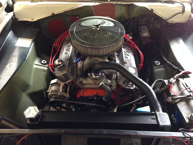

I've got a thing about flexible rad hoses, I hate the things, I admit it I'm a Hoseist. Factory style moulded hoses can usually be found when converting to an Ally rad. The stock bottom hose fitted with a little trimmed off each end. The top was way off. I made a wooden template that slipped over the rad and the thermostat housing and headed off to Customville, basically any hose that met the 2 points on the template would fit. Took about 2 mins of looking through their stock to find something that would do it. If you need to do the same The bottom hose is a Gates 20958, the top is a Dayco 70975

Fantastic!! - I was planning to pop in quickly to Villain's Saturday morning for the very same thing :thumbright: That rad look's very much like my Northern rad - is it?

Blue wrote:I've got a thing about flexible rad hoses, I hate the things, I admit it I'm a Hoseist. Factory style moulded hoses can usually be found when converting to an Ally rad. The stock bottom hose fitted with a little trimmed off each end. The top was way off. I made a wooden template that slipped over the rad and the thermostat housing and headed off to Customville, basically any hose that met the 2 points on the template would fit. Took about 2 mins of looking through their stock to find something that would do it. If you need to do the same The bottom hose is a Gates 20958, the top is a Dayco 70975
A simple, effective way to take all the guess work out of ,a parts bin rummage :thumbright:
Posts: 14502
Mark, My rad is a no make 26" that I picked up at the swap meet. I would imagine a Northern of similar size would be much the same.
