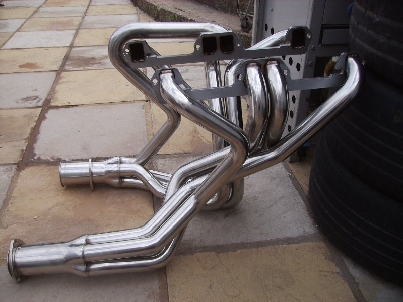

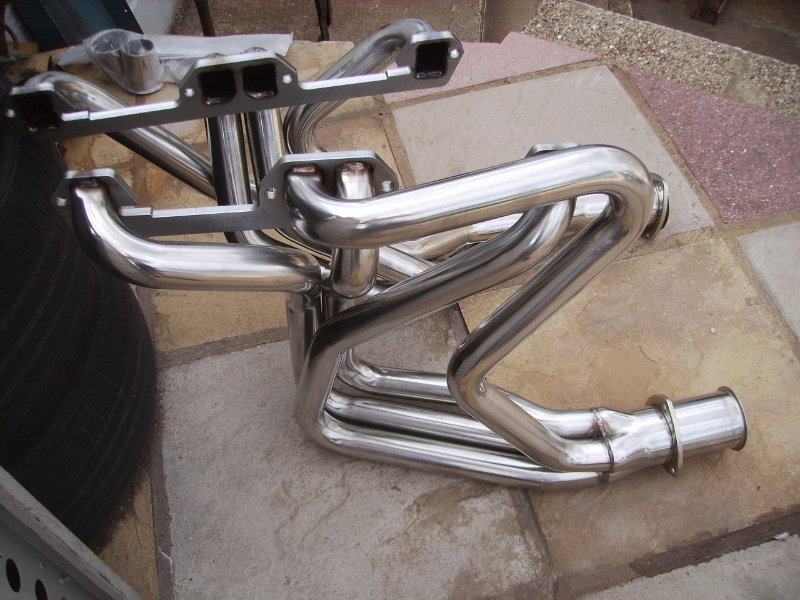

my stainless headers arrived to day from ebay (in america). not quite 2 weeks via the 'global shipping program' they use so not bad. the box was ripped open one end though so the collector bolts were gone and the gaskets are all bent up. a bit of tape around the ends/corners is all it takes for boxes to stay intact, but oh no that's too hard . anyway the headers are ok and not dinged up, i'll be doing that when i'm getting them to fit . here's some pics and 1 of the ss springs now i've spent 1/2 an hour getting the shipping stickers off

showed a mate the shiny headers earlier and he said where's all the bolts and did you notice the gaskets are bent and those 3 tubes look out of whack. he's right and the box they came in was split open one end, but i was so excited with my new shiny bits i didn't properly check everything. no header or collector bolts/nuts, no collector gaskets, damaged main gaskets and the o/s header appears to be bent. whether it's enough to be an issue with fitment i don't know yet. i've sent a message to the seller explaining (with pics) so i'll wait to see what they say.

the header issue is resolved as the ebay seller is sending a partial refund so i can replace the missing bits myself
