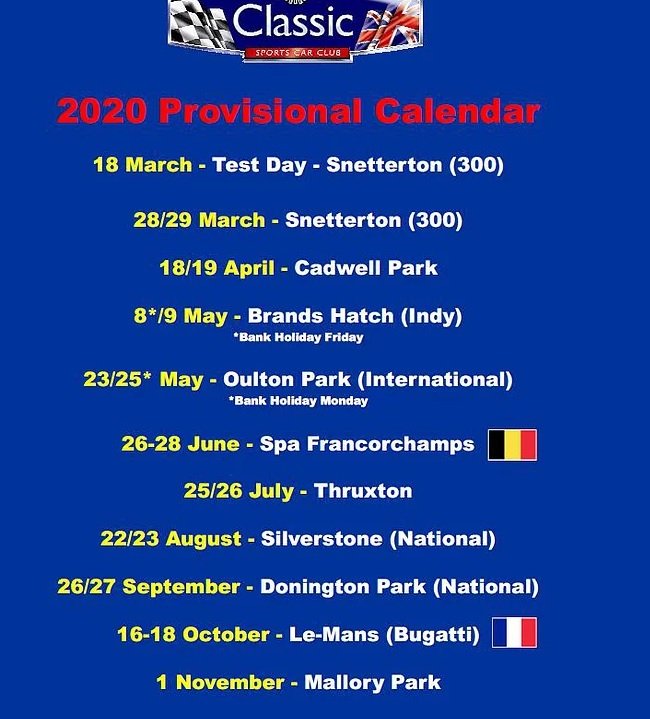

CSCC have just released their Dates. I'm intending to do as many races as poss with Bernie's as well - hopefully there won't be too many clashes.
cscc dates.jpg (78.77 KiB) Viewed 3763 times

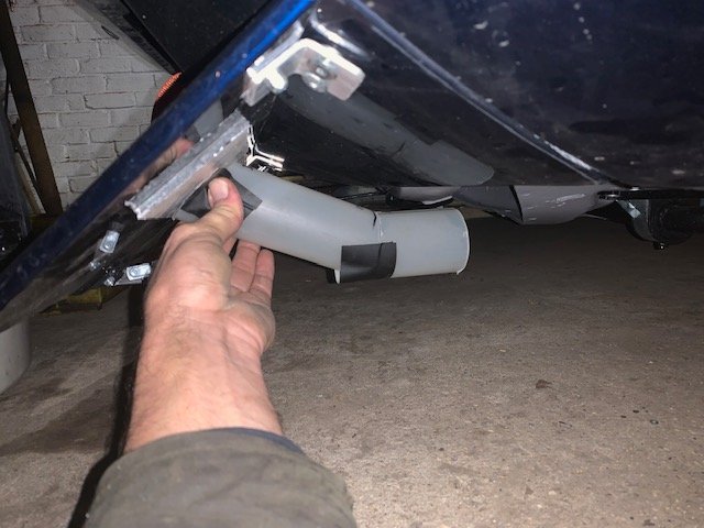

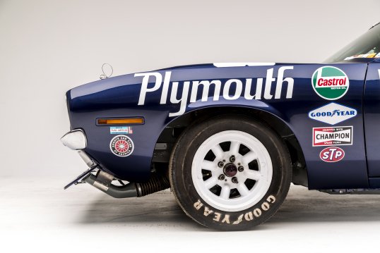

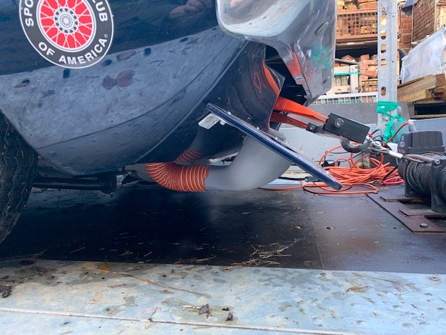

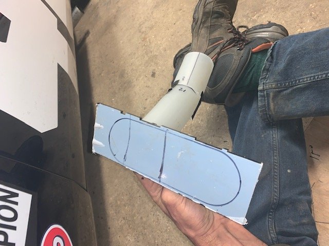

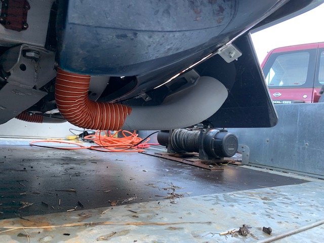

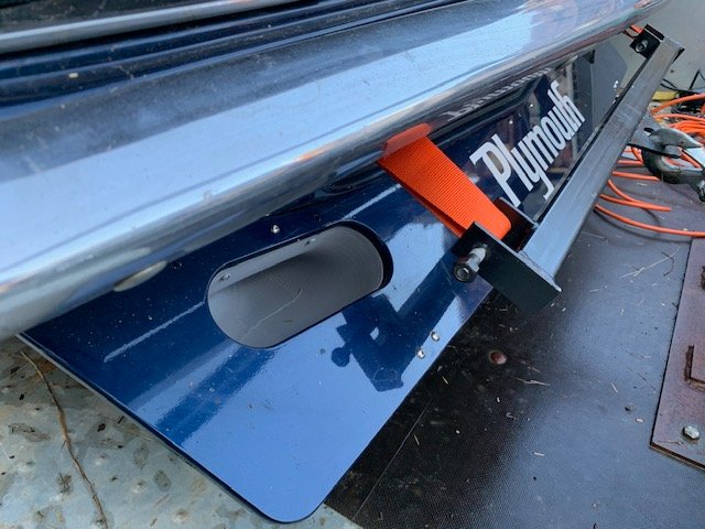

The car needed some specially shaped ducts behind the front spoiler to direct cool air to the front brakes.
Here's a pic of one of the original cars
I had a bit of a go at building something from sheet ally, but the shape of the duct is quite awkward.

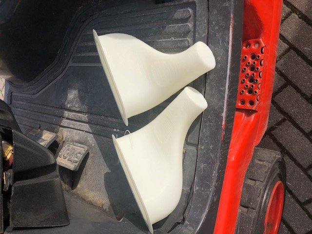

I asked my mates James and Adrian (who did the vinyl printing for the stickers) if they could make me a pair of ducts on their 3-d printer, but the print time was going to be around 3 days !
Fortunately this week they took delivery of a new printer, which is one of the largest and fastest available.
I made a pattern so that I could plot the positions of the inlet and outlet, and the angles and distances between them.
And it took 28 minutes to print these. The next job the printer's doing is a life-size Wallace & Gromit.
The plastic itself is not particularly strong, but after it's set you can coat it in a self-levelling resin that fills in the print marks and adds structural strength
I wanted to get them on the car quickly though for the show this weekend , so just a quick coat of grey primer and some angle brackets for now. I'll install them properly later.

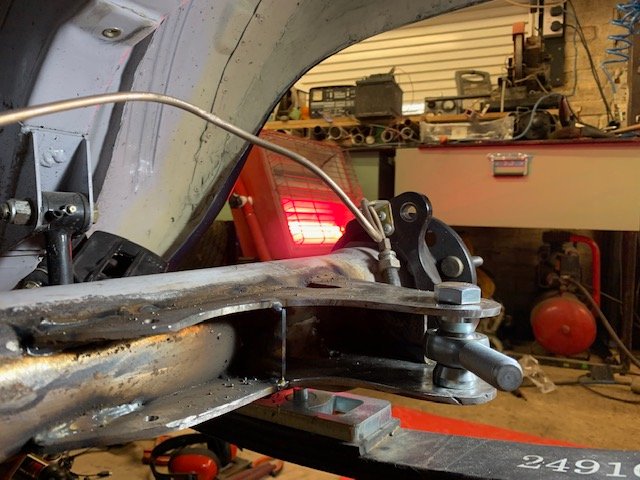

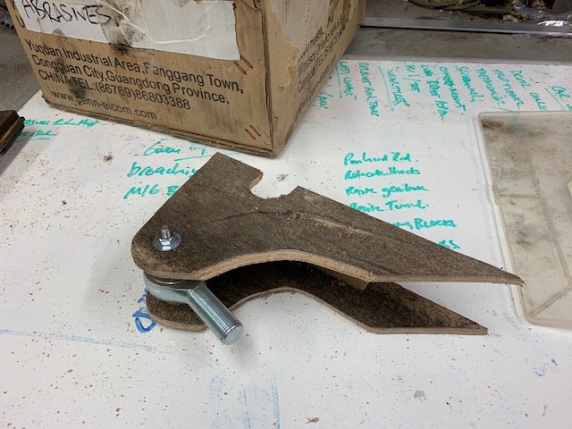

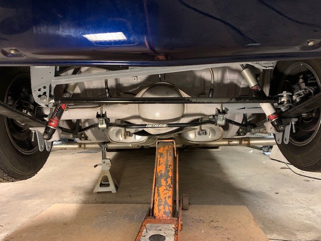

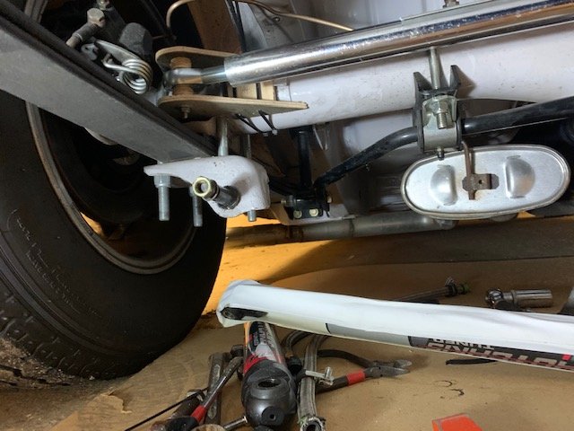

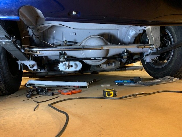

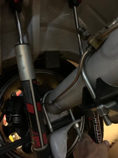

Started on the Panhard rod today
Geometrically, the rod needs to be as long as possible - and horizontal at ride height.

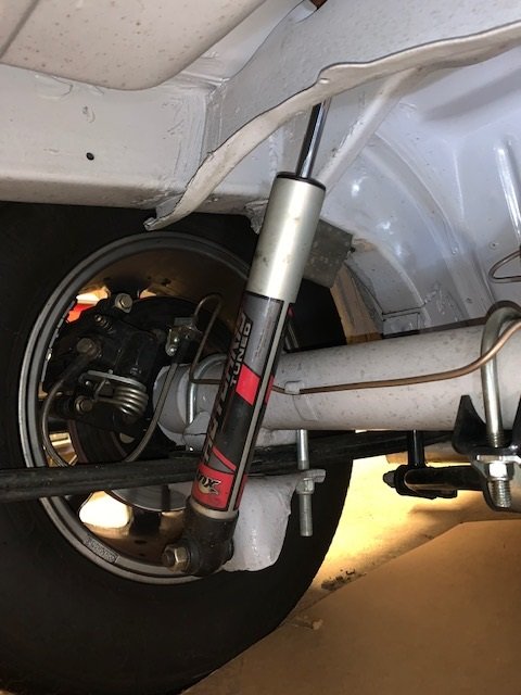

I want to attach the rod directly to the axle rather than the spring shackle plate, as the axle is where the load originates. If the car can generate corner forces of , say, 1.2 G - then there's going to be around 850 Kg sideways force on the linkage and brackets - and I'd rather not transfer this load through the shackle plate, U-bolts etc just to get it from the axle to the rod.

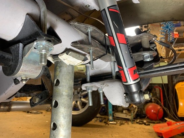

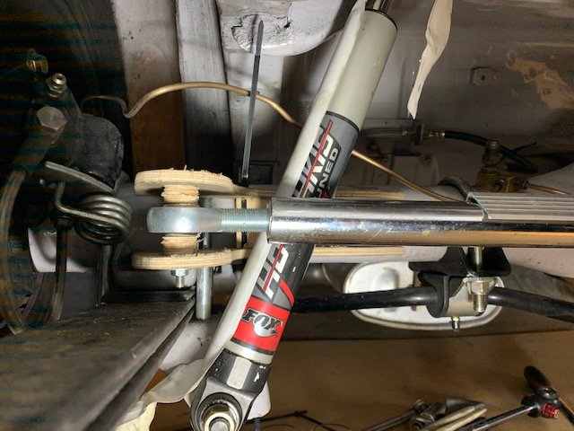

Initially, it looks like the shocks will be in the way, and will have to be relocated to in front of the axle. It looks like there will be room for them there.

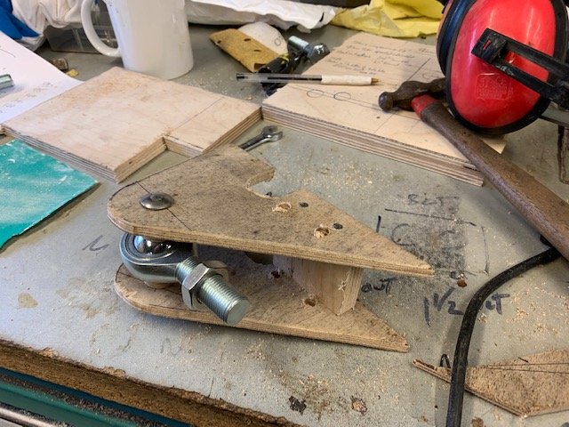

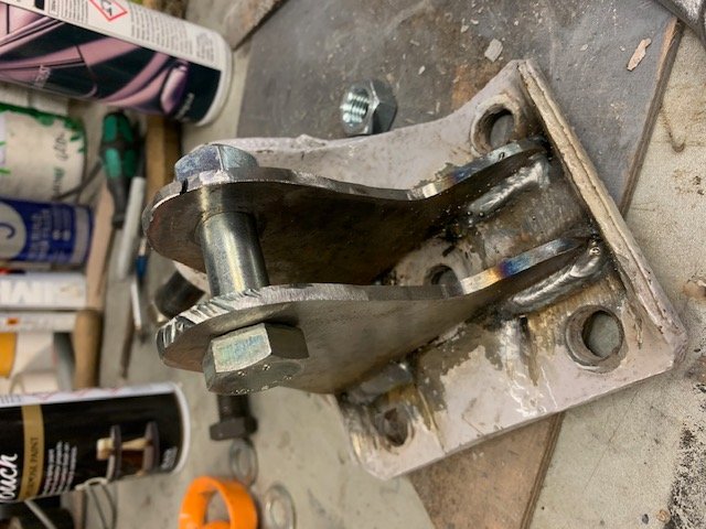

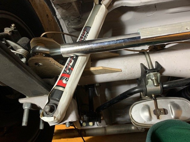

Axle brackets mocked up from thin plywood. The bolt through the rose joint eye will eventually be M16 , and there will be gussets.
And in position.
Other side - this bracket will be triangulated over to the other chassis rail eventually
And the whole thing
At this point, I notice that the RH shock will actually reattach with the panhard rod in place, although the LH presents more of a problem.

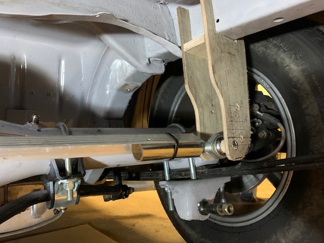

Mock up a larger bracket, with the rod spaced about an inch further away from the axle tube.
And fit.
I'm not entirely happy with the leverages involved with this larger bracket - even with added gussets round the relieved part , but will sleep on it. There is also currrently very little clearance between the shock and the panhard rod.
But if I can get around relocating the shocks, it will save a ton of work.
Posts: 1611
that axle bracket is more than strong enough, especially if you 'box' as much as you can between the 2 halves. i'd be more concerned about the chassis bracket length but you already said you're bracing that so you have it covered :thumbright: .
Posts: 22213
Loving the Threshold - I am sure that will be great in Compression....
Loving the work as ever!
:plymouth: :plymouth:
Class act Matt, your a clever fella, braced enough it will be fine remember it will not take all the force some will still get taken care of from the leaf spring mnts etc

good work,you never stop, did you think of using a watts linkage or was that going to be too much work ?
life is not a spectator sport
www.andyrobinson.eu
andy robinson
68 572 coronet RT
72 440 chrysler new yorker
69 518 daytona
Matt
Posts: 1039
Post by Matt »
Thanks Neil and Dunc
Andy I thought about a Watts Linkage , and would probably look at it a bit harder if doing the same job again.

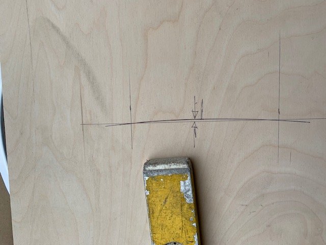

The Panhard does the job well enough though, and is simple. THe trick of course is to keep the bar long, and horizontal. In 6" of suspension travel (3 up, 3 down) , a 40" bar gives only about 3mm of side movement.
I couldn't be bothered to calculate it, so I drew it out.
If I adjust the bar with about 1.5mm preload at the mid point , then the leaf springs will be only pushed 1.5mm off-centre in each direction during the travel. Roughly.
Matt
Posts: 1039
Post by Matt »
the Mk IV axle bracket is good to go. I'm fairly happy with the clearances now.
And at last ...

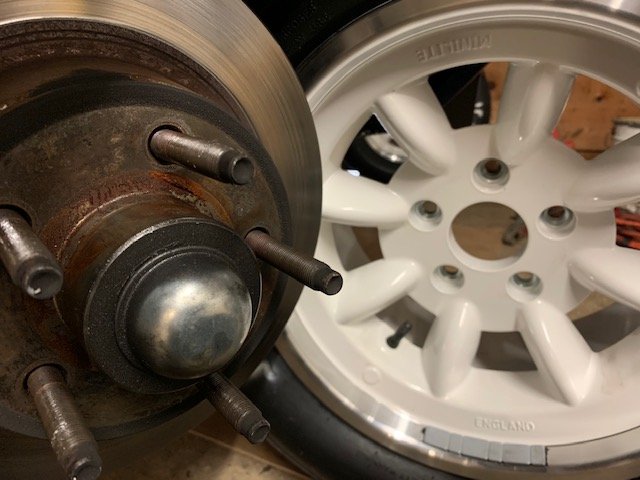

Slight delay now in fitting the wheels as the centre holes in the fronts aren't large enough to fit over the disc hubs. Minilite are going to enlarge the holes for me.
Also the outer beads on the new Hoosier tyres are very hard to seat on the rims. THe solution apparently is to use fairy liquid rather than tyre soap, and to increase seating pressures beyond recommended.

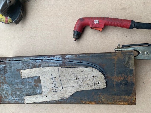

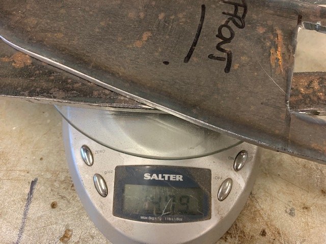

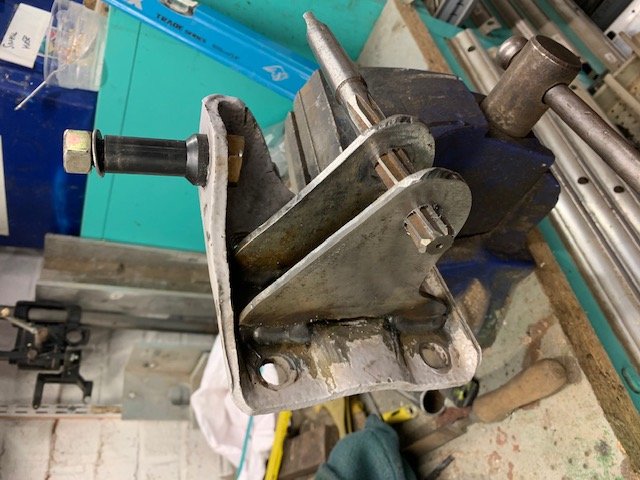

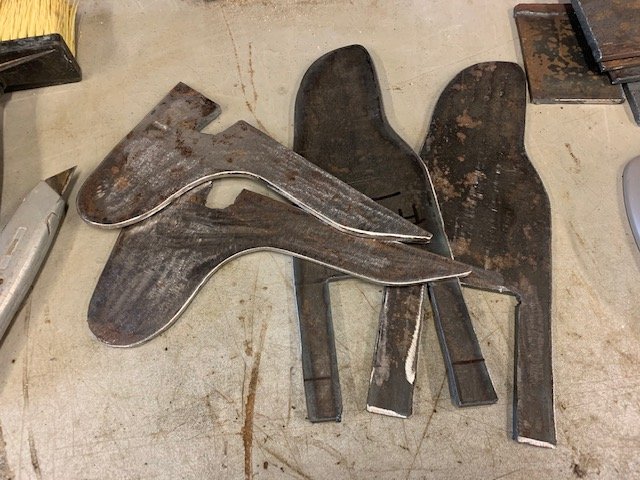

Wooden patterns dismantled and used as templates for plasma cutting
Not happy about adding weight to the car, but it's for a good reason.
finished plates

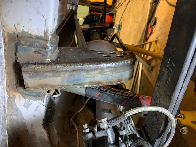

Axle mount. This has changed sides, since I read that cars that usually turn right are done this way. Something about wheel loading on corner exit, according to Carroll Smith.
and part-way through boxing in
and the chassis mount

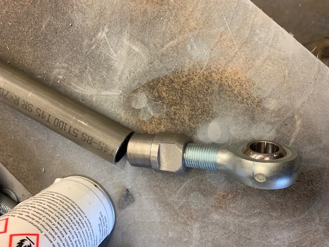

My next-door neighbour made me some nice tapped bushes to mount the rod ends

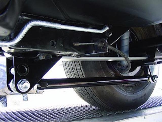

And while the U-bolt plates were off I added brackets for the anti-tramp bars
the anti-tramp bars will eventually look something like this.
traction bars.jpg (49.06 KiB) Viewed 3491 times
finished !
and then some testing yesterday at Silverstone
