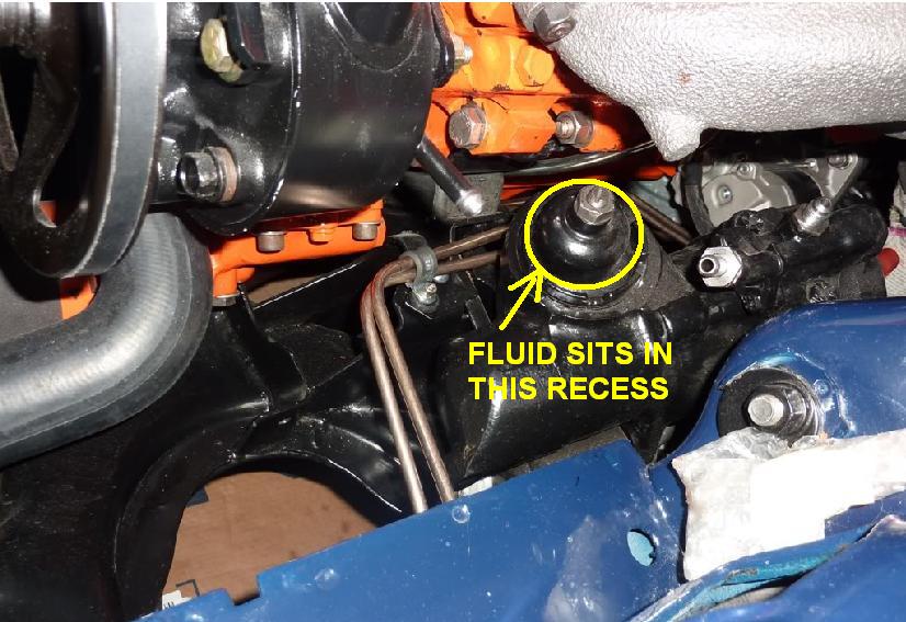

It was supposed to have been rebuilt with new seals. If the oil is sitting in the recess around the castellated bit, I presume if there's something missing or worn it's whatever is below that area.
I'll see if we can find out where it came from and quiz them about it
Thanks anyway - I'll let you know if we need one of your seals

Is it the castle nut where the steering coupler connects or where the steering adjuster is.
Below both of the is just an oring as I repaired Scott's and mine in the same way. If I can help let me know. I think I have some picture of Scott's when it was apart. I also have both the proper castle spanners to take it apart.

Thanks Anton - see pic below. I've tried to show where the powers steering (ie trans) fluid had been sitting (yellow circle)ANTON wrote:Is it the castle nut where the steering coupler connects or where the steering adjuster is.
Stu rang the people who did the rebuild earlier today (Mon) but needs to ring them back Tues to speak to the peron who would know what work was, or should have been done. They'll prob say they'll have another look at it for us if we can get it off for them (they collect and re-deliver, if memory serves) but I dont fancy taking it off again any time soon!
I'll let you know what they reckon as soon as I hear back from Stu.
Access to the steering box is a bit more limited now the battery tray and power steering hoses are fitted but if you had your 'special' spanner with you at the Pod is it something we could do there?

As mentioned above, it looks like it's the steeing box, not the pump that's giving us trouble. Thanks for the offer tho

Is that a non original pipeclamp i see....................
Stu says it's not coming from the adjuster so may be back to the big castellated nut area
He's spoken to the people that did the rebuild and the bloke that did the work is going to come out to see what the problem is & hopefully fix it!

Nothing major to add, tbh, but the aforementioned steering box leak was fixed thanks to some o-rings from Anton and the use of his home-made spanner
It's amazing how well an o-ring can work if it's the correct diameter and sits in the correct position..... No thanks to the people that rebuilt the box
