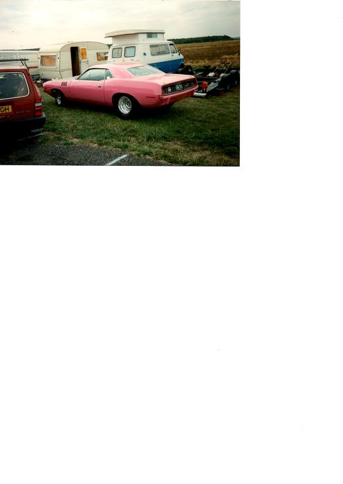

[quote="baccaruda"]Hi Again,
Mick Payne and the Artful Dodger!
Iron headed 440, ex Hauser motor.
He used to run 10.40's all day long in a very heavy 67 Coronet!
Tunnel ram with twin 750 double pumpers.
Think he used to cheat abit with a shot of NOS!!!
Story goes he had a buyer for the motor and run it one time too many.
Guess what, the motor went bang and 5grand went up the swanny!
Still got one of the heads orf dat motor, very nice work done by Hauser back in the day!!!
The pink car went 11.00 on the motor, seen it run loads of times.
Mick

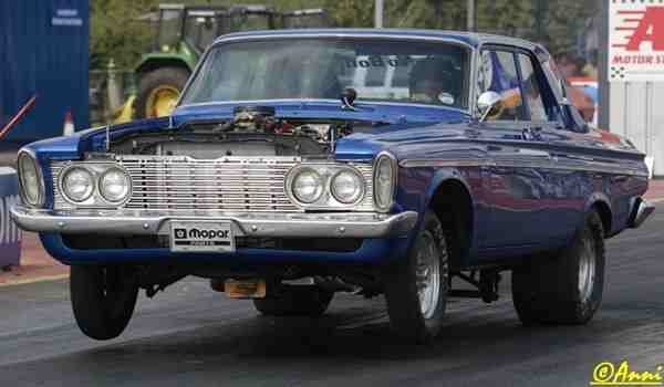

Ok I'll have a go les, my old 63 belvedere, weighed 3500ld without me so 3700 all in race weight, 500ci mopar mega block, ported Indy 440-1 heads 718/690 roller cam and 14.5-1 compression, was mini tubbed and on ladder bars running a 28x12 slick, best 60ft was 1.41 best et was 9.80@136.6 oh and it was registered and used occasionally on the street, had an msd timing retard in the car so could instantly knock 5-6 degrees out put in optimax and it'd cruise nicely,

Car:-.........................1965 Dodge Coronet
Weight w/driver..........have no weight savings apart from no back seats, all steel street legal approx 3600/3700 lbs
Engine size/CR...........543ci was 12:1 cr but will be rebuilt with 10.5:1
Heads.......................max ported 383-13 indys
Cam/lift/dur...............690 lift roller 323 at 0.2 and 287 at 0.5
Intake/Carb spec........single plane indy 1250car shop stage 4 dommy
chassis.....................ladder bars leaf rollers/will be going caltrac and mono leaf
Trans.......................4000 stall reverse patten deep sump with cooler
G/ratio/tyre size........4.3:1 will be changing to 4.1:1 315/65/15 drag radials
60ft.........................1.57
ET/mph at rpm?.........10.50 @ 130mph 6750rpm though the line
