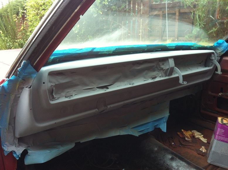

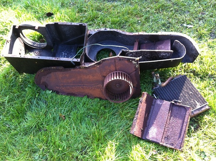

Dash is stripped, Ru gave it a rub down and a prime.
Heater was taken out and dismantled as some of the flaps had seized (probably never moved off the cold position all it's life).
All cleaned up and parts moving fine now :)
Heater motor works a treat :thumbright:

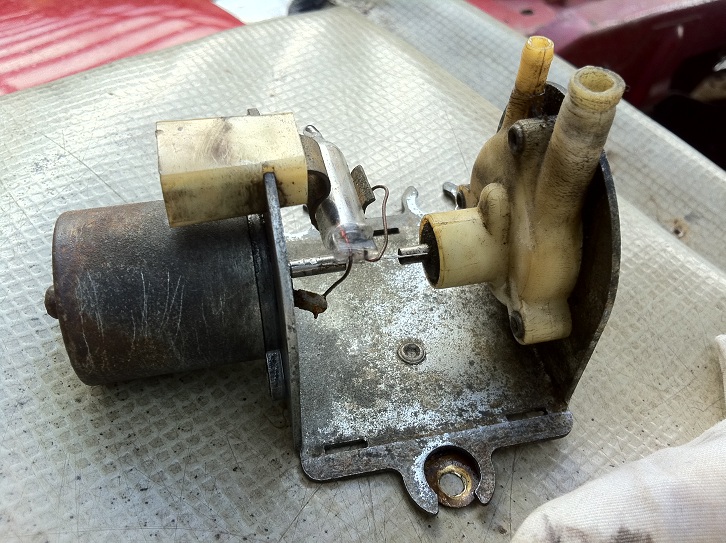

We even stripped down the washer bottle motor. Seized solid. Bit of TLC soon brought it back to life ;)

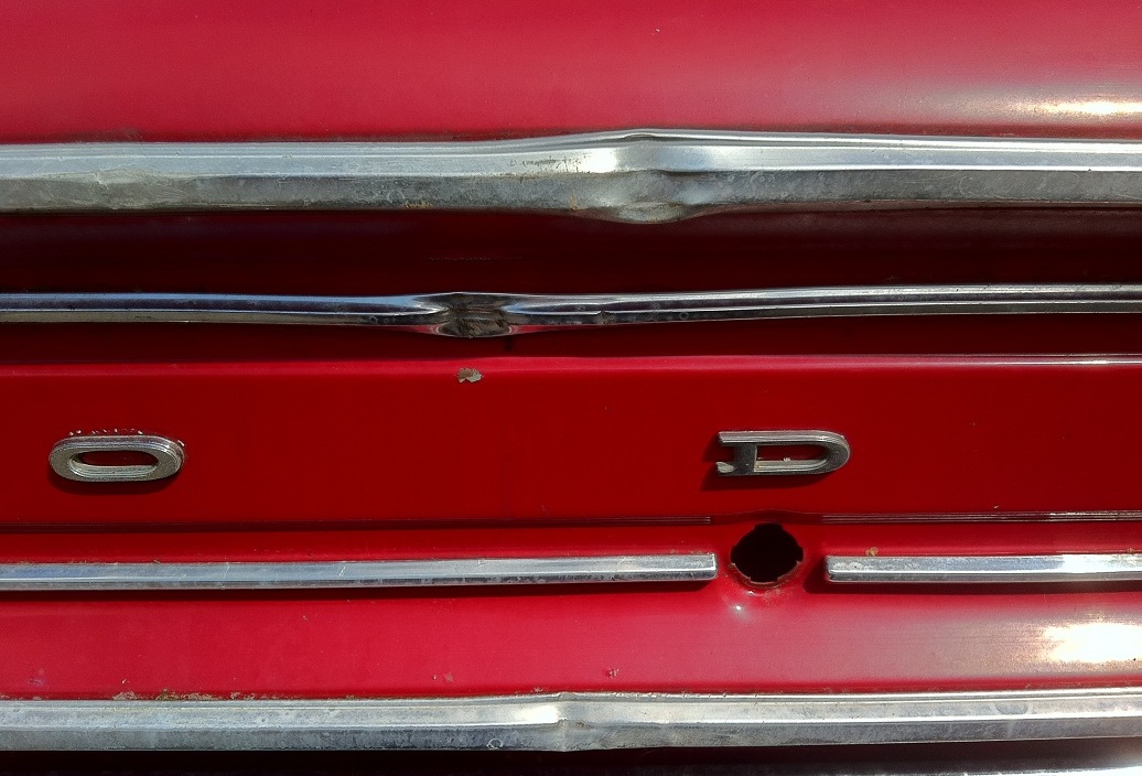

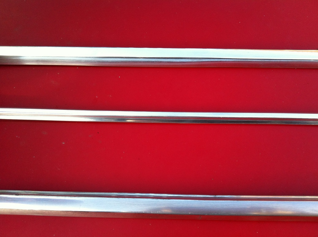

Looks as though someone at some point has bumped something into the back of the car #-o
Thankfully the only damage was to the trims going across the trunk lid.
I thought they were cattle trucked for sure, but my mate Ru said.........Oi!!! ..... You!!! ......... No!!!!!!!!!!
They ain't cattled me ol' china [-X
So, to prove what a clever old stick he is, he took them off last weekend and repaired them.
Don't know about you but I was well impressed with the end result :thumbright:
The only way you could tell that they'd been repaired was if you turned them over and looked at the rears.
Absolute superb job there Ru =D>
Well done mate!! :notworthy:

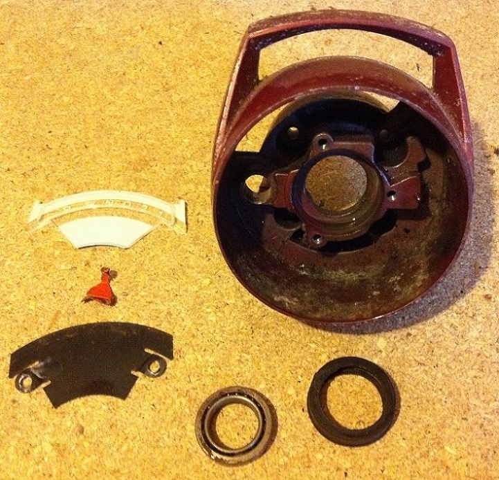

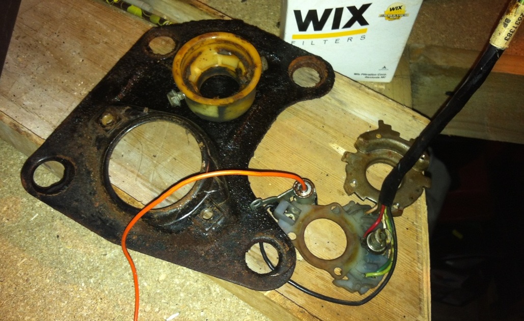

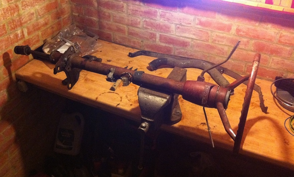

Next job on the list to do is the steering column.
It's all stripped out ready for a good degrease, rub down and re-paint.
All the bearings are good, but some of the electrics could do with a sort out turn signal wise.
I guess 45 years of cooking in the sun don't do the contacts any favours, but it'll get sorted ;)

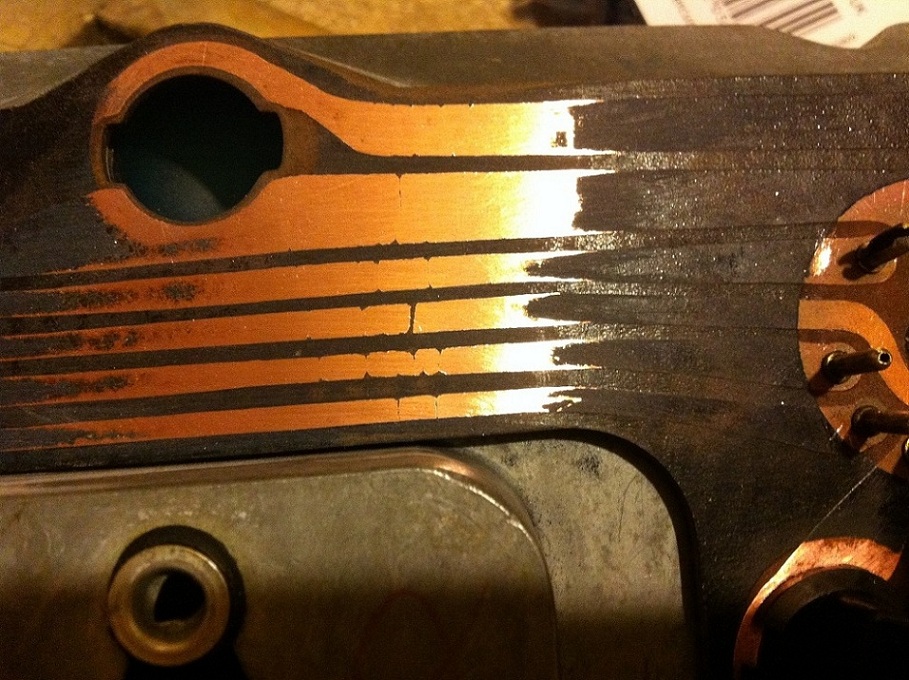

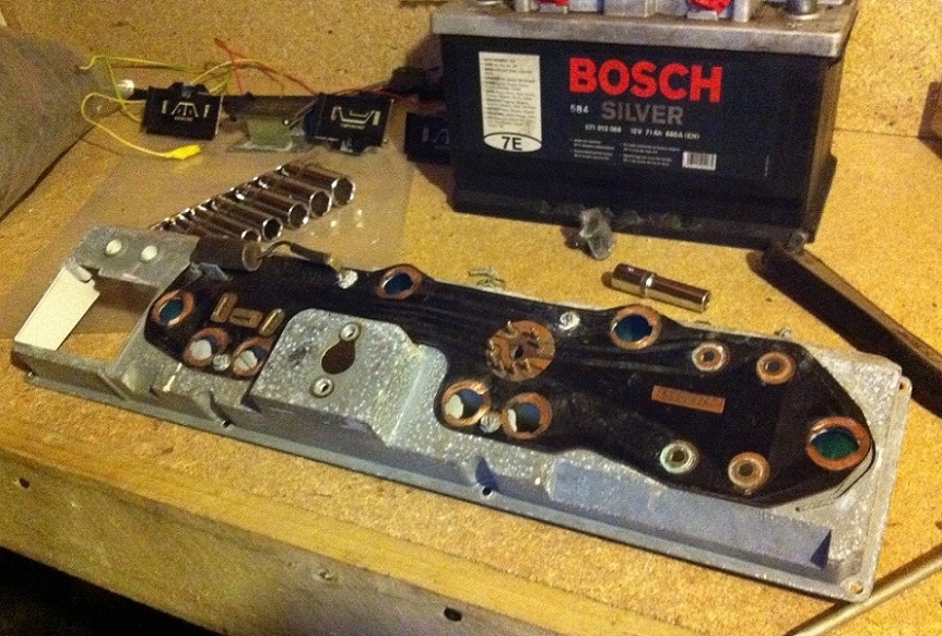

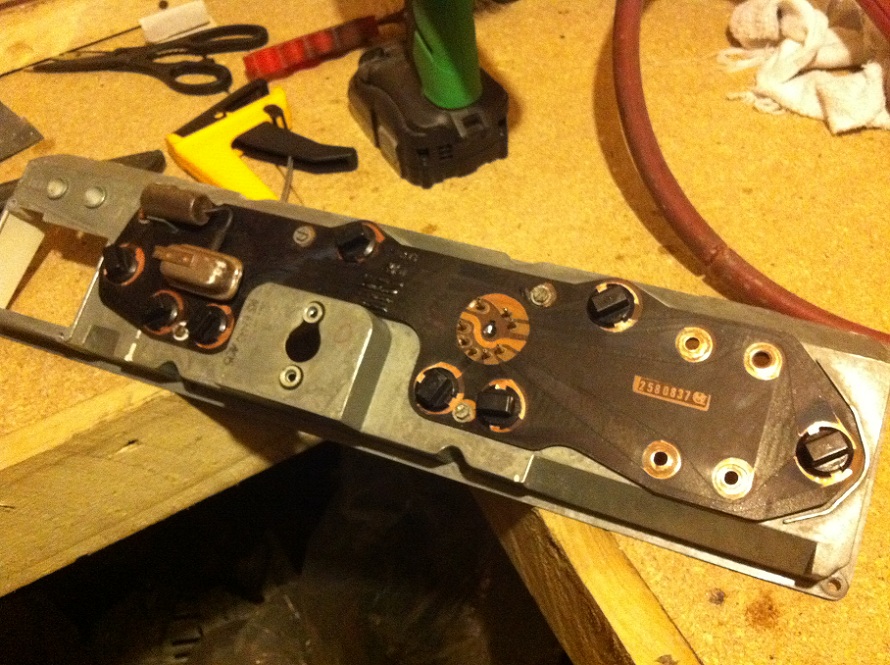

This was something else that needed a good sort out.
When in the car, the only thing that worked was the Ammeter :help:
After stripping it apart we briefly put a live feed direct to the other 2 gauges, and hey presto, they worked a treat :thumbright:
Temp and fuel both started to go straight to the full / hot positions, so there's nowt wrong with them ;)
So, why didn't they work while in the car all wired up :scratch:
Well I guess the fuel gauge was simple........the tank was empty :D
This doesn't explain though why the temperature gauge, oil light or turn signals didn't function :?
So our little investigation continued......
The little voltage regulator on the rear proved to be good, as did all the bulb holders and bulbs.
So a check of the circuit board was done, which proved to be where the problem lied........
After giving us the run around for a while, we ended up testing sections at a time for continuety.
It showed up that all the faults were in roughly the same area under the black coating.
After rubbing it away we found a series of hairline cracks across the copper routing.
1 route had a section missing of approx 1mm. No wonder nothing worked!! #-o
There was no visible damage to the board at all. No warpage. No scratch marks or anything like that.
Haven't a clue :dontknow:
Do any of you guys have any ideas???
Have you ever had this problem with yours before?
Was it a problem on these circuit boards of these years? :shock:

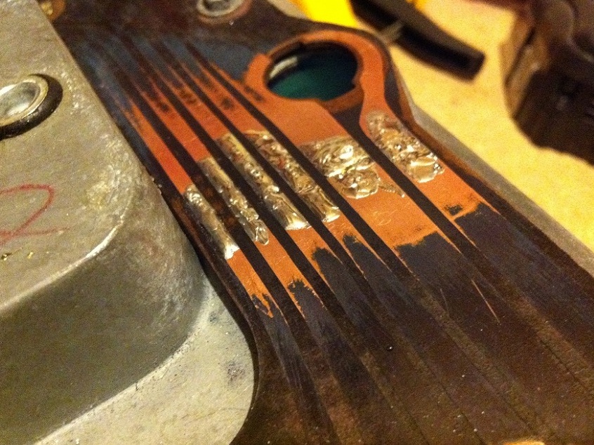

Anyway, after warming up the soldering iron, we did the repair.
After more continuity tests, all circuits proved to work fine. :thumbright:
After cleaning up the outer casing, and a few coats of paint dabbed over the solder for protection, she's good to go :D
To Be Continued......

$150 for a replacement circuit board, I'm glad we did repair it :shock: :lol:

Posts: 9596
looks like the copper was plated on and has slowly come off or never worked ever from new??
modern boards have a layer of copper and you remove what you don't need leaving just the tracks you do want
looks like the reverse was done in the old days.
all most worth taking to bits doing a photocopy onto acetate and making some new ones up. the drilling takes the time really
they'd cost a lot less than 150 each to make
undercut the price by $40 and you'd sell a few I'm sure

looking good, neat repair on the dash :thumbright:
