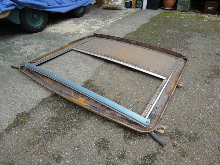

Rear quarter passenger side is now all on, and tidied up.
So I decided to start on the roof yesterday.
Started unbolting the sunroof tray and found I had done alot more work on this than I thought, back in 2002.
Looking at the potential for things going wrong, and warping the roof filling up the hole, I have gone back on my previous plans, and I am now going to keep it.
THE SUNROOF STAYS :thumbright:

Matt if you want to get rid of the sunroof then the only way to put less heat in the roof is to braze the repair panel in.
I also used a lump of copper held in a wet rag and held behined the weld when welding. This was more when i was learning but it takes all the heat out of the metal and may help. Great work we need loads of pictures :thumbright: :thumbright: :thumbright:
Wow I have never seen one stripped down like that I am assuming it is a factory sunroof car?
Posts: 5935
Drew, it is a Belgium market car, so the sunroof looks to have been dealer fitted or Belgium factory fitted when new. It has a chrome rocker switch on the centre console that operates the roof. It is a powered sliding steel roof, and had rotted badly. I have now rescued bits of the roof and welded them into a rust free sunroof tray from a mid 80s Rover.
Its a bit Heath Robinson, but with plenty of seam sealer should work and allow any water to drain through the drain tubes and not the drivers seat.
Tig Napier's purple race Challenger has the same type of roof, but his is kept shut as it is a race car. Also a Belgium car I believe
Anton and Autofetish ; - I thought long and hard about just filling the hole, and the associated concerns about heat. Discussed brazing and heat sinks at the club meet on Wednesday, and hence decided to keep what i have repaired with the minor distortion I currently have from my earlier repairs, rather than risk alot more mess from trying to weld or braze more metal in.
It also means I have made alot more progress today as the roof is now welded up and I have started seam sealing.

This picture shows the old original rotted sunroof tray in place in the car, and the below pic is the Rover tray being offered up and seeing where it will fit. This was 2002, before had a digital camera.
Sunroof b4andafter aug 2002.jpg (118.05 KiB) Viewed 1751 times
Posts: 5935
I had to cut the old support tray out, as it was crimped into the roof like a doorskin. I alos modified and welded in new support brackets so the new sunroof bolts in and out as a unit. I am re-using the original cars sliding panel so from outside it will look the same, and inside will have a headliner, so all good.
This pic shows how the Rover tray has had the back of the old tray let in, and the aperture modified to make it the same size as the old one.
