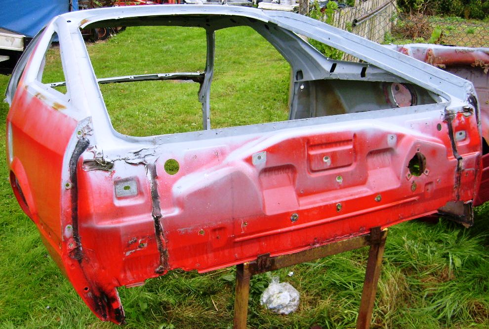

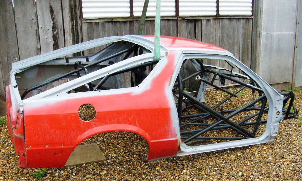

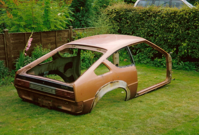

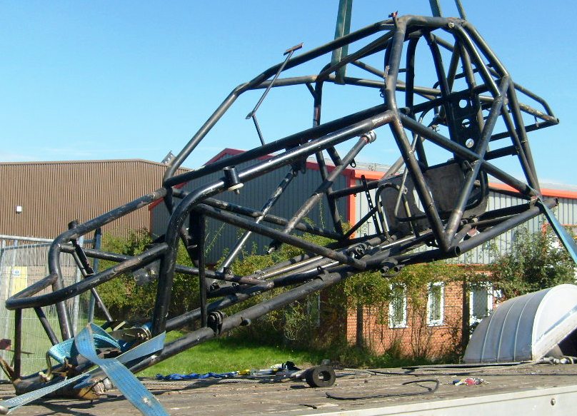

Got the Plymouth Arrow this morning on the truck and Hiab ed it up in the air so could see all around and underneath it. The wheelbase of the Arrow and Daytona are a bit different and the rake of the screen is a bit different but should be able to " lose " the changes in the rear arches and the passenger cell. The front is damaged and will be straightened prior to cutting to suit the Daytona.

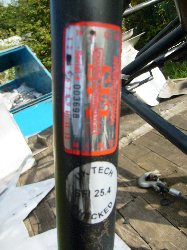

The cage still has a current tag to 7.5 and as I`m not touching anything behind the firewall should be fine ??
The Arrow body will be cut off and thrown away

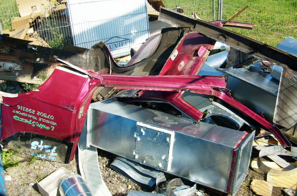

Removed the body this morning and scrapped it
Cage is now ready to go on the jig ( read 2 x RSJ`s laser levelled ;) ) and push / pull any damage ... there is very very little damage on it
Will try and drop the Daytona body over later in the week to get some idea of proportions

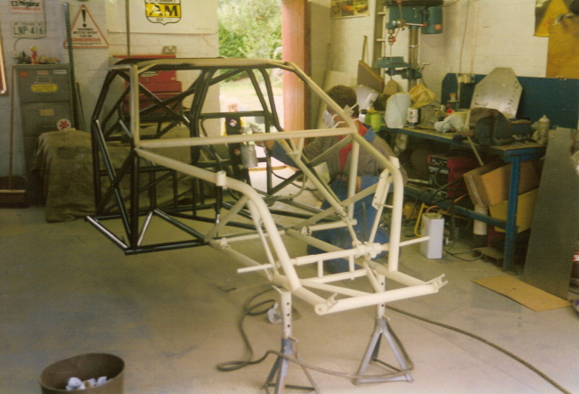

Was that Paul's old Arrow - the one that crashed at Shakey a couple of months ago? :?
Looks like it... 8-)

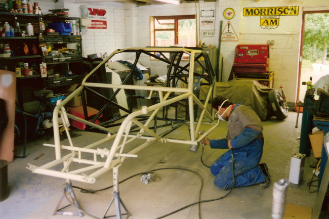

Hi Rob
Nice pictures .. not seen them before.

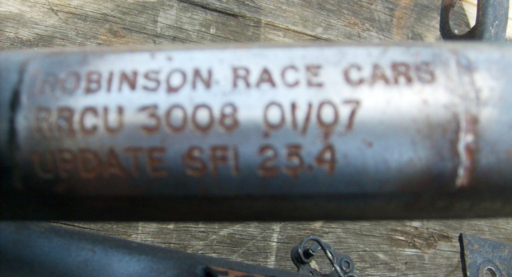

Yes it is the same chassis, I believe Andy Robinson finished it ?? as it wears one of his build plates and was modified to get it`s current tag. The front of the chassis has been altered since that photo so maybe Paul built the version 1 and Andy Rob modified and adapted it ?
It crashed at Santa Pod at low speed and hasn`t done much damage at all .. the front struts took alot of the impact and the wings, grill, bonnet scrubbed alot of the speed off.

I suspect Clive Bond (Ultimate Race Cars) down in Cirencester did the original chassis as he does most of Paul's stuff - has done since he raced that Aussie Chrysler CH in the Roadster class in the mid to late 80's!
Paul said Debrorah was selling up cos it was gonna cost £14k to fix! :shock: So I thought there was gonna be more damage than that....

Excuse my ignorance Jon but would having a cage like that built, cost more than buying a car with a cage that was certificated and in good, useable condition and then cannabalising it?

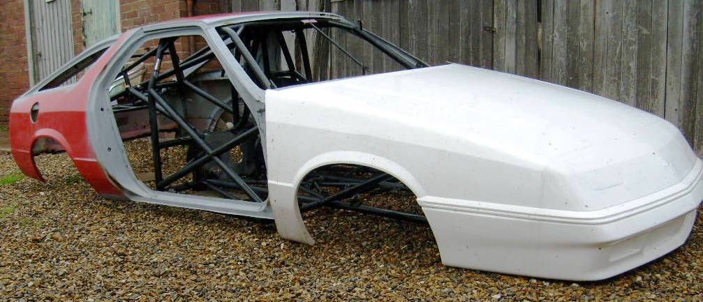

This came up for sale as a pile of damaged / salvage parts and was priced as such ... not a big value in the open market. The Arrow car had no engine, box, electrics, fuel system ... they had already been removed by the previous owner who had crashed it. The value for me personally was in the chassis and axle only. The body was incomplete ... no doors, tailgate, wings, bonnet, grill came with the car.
So, I will cut my Daytona body ( as per the picture of the Arrow body ) and graft it onto the old Arrow cage / chassis. Fit my fibreglass front end and my smallblock running gear. I should then end up with a tube chassis car with a current tag to 7.50

Any details on how they do it? Is it a basic 'points' system like 5 - 7 - 10 point cage and then do some checks of all the connections?
Does it have to be tagged by some kind of authorised body? Does it need re-tagging after light bumps etc? In other words, apart from running faster and having a massive crash, what invalidates the tag?

Duncan / Guy / Pete / Turnip etc can correct me if I`m wrong ??
Cage has to be built to FIA / MSA rulebook for chassis and cages. A technical inspector ( someone like Jeff Martin ) will then inspect it on a " technical " day at Santa Pod and ask to see samples of materials used. If it meets the requirements of the MSA / FIA rulebook and is constructed well and proficently he will pass it as a representative of the sanctioning body, if it is built incorrectly with the wrong materials he will fail it.
He will then attach a sticker / tag with a serial number and expiry date. This is unique to the chassis cage and not the car. It is traceable and details recorded so they cross refence with the chassis plate etc. When it expires it has to have another reinspection and is passed again for a number of years ( unless rules have changed in meantime and it needs an update ). There is a fee for this. All these details are then kept centrally to ensure all cars in competion meet minimum legal requirements for safety.
Harnesses, shields, flex plates etc regularly have to be changed but generally speaking a chassis won`t need work between inspections. Any work forward of the firewall is outside of the scope of the inspection hence I will change from BBC to SBM and change rack and pinion and wheelbase
Think of it as equivalent of MOT + V5 for a road car

Body is now cut to outer skin only and some secondary supports
Offered the body up to the chassis and the fit is really good
Am off tomorrow too and the chassis will be going on the jig ( homemade )
The body will be fitted to suit the front struts with door openings coming where they come. The rear arch will then get chopped and moved forward / back to suit rear wheel position
