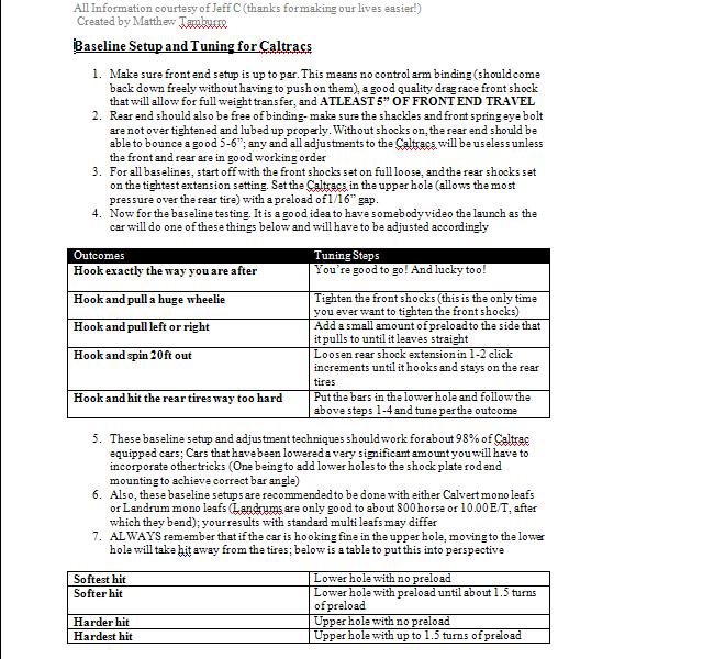

Mick i have read a million things on the internet about caltracs and launching straight....seems some people out there swear by rear sway bars...the bigger the better?????also found this ..might be of some use to someone out there
- untitled.jpg (90.47 KiB) Viewed 1256 times

Pete, that baseline tuning is the way I would start. My initial set up was very similar, only I started with the rear shocks at fully loose. What you often get with caltracs is "Porposing", the car rocks back and forth after the launch. I just clicked the shocks up one step a run until it went away. I'd also be adding 100lb of ballast in the boot, I think your car will be very nose heavy which can make for some very "interesting" handling...
