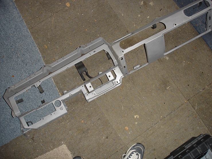

One of the main things my car was still missing was the frame onto which the dash board components would be mounted but this has now been resolved (Thanks Dunc).

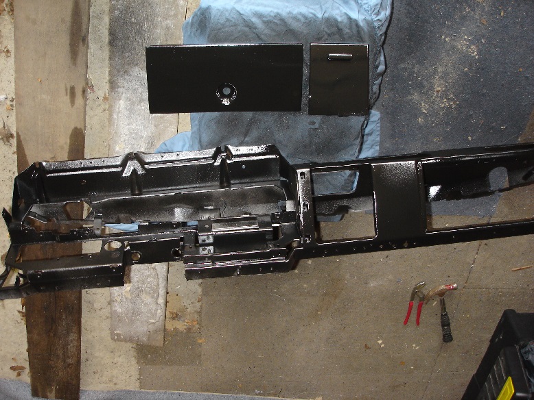

The frame was sand blasted and, after stripping the existing black paint from the ashtray and glove-box door (revealing traces of the original blue underneath) , the whole assembly was painted. I'll reassemble before giving it a final coat so the finish is consistent.
Awaiting final coat.
Frame 006 small.jpg (220.14 KiB) Viewed 2669 times
And now you don't (due to the miracles of media blasting).
Frame 004 small.jpg (206.48 KiB) Viewed 2669 times

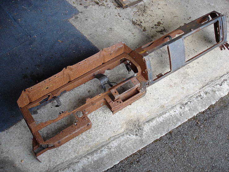

Surface corrosion - now you see it.......
frame 001 small.jpg (240.18 KiB) Viewed 2669 times

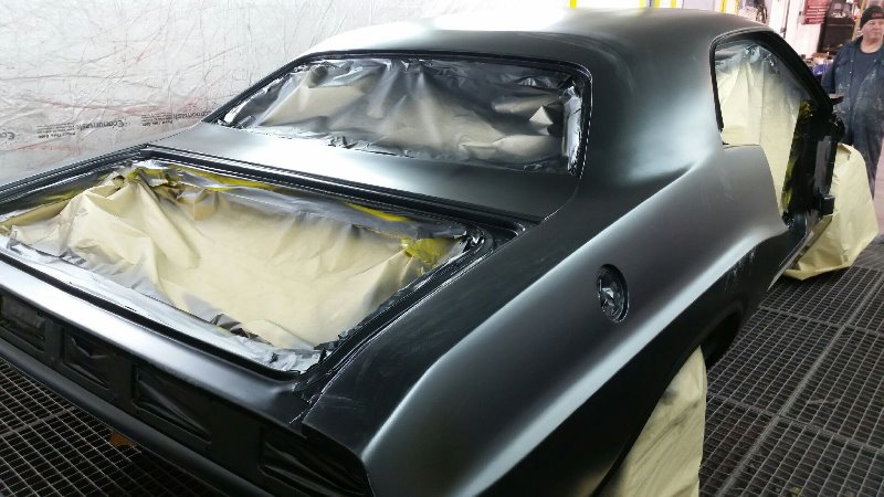

Couple of pictures of the car with the black primer applied. This was done pretty much immediately after the polyester filler was applied to avoid micro-blistering in the final coat.
