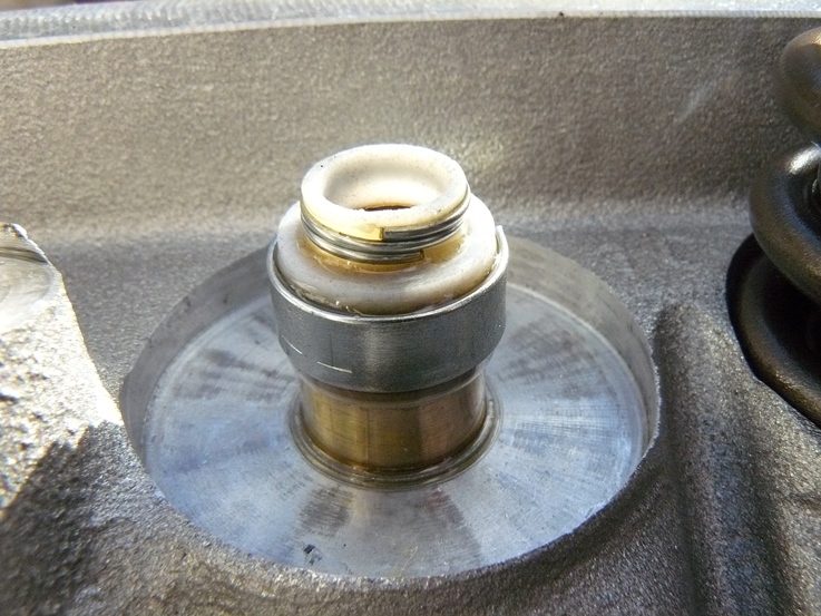

Can anyone offer ANY info to help i.d. my valves, etc?
Make, type, material, etc, please.
Valves look stainless but not sure, I need the make please, 2.05" x 5.02" stem 11/32" Head is Indy so could be Edelbrock or Indy but I can't find any that match in their lists.
Valve guide I assume is bronze but unknown make, prob Edelbrock/ Indy?
Retainers & collets are 10 degree, dimensions as pic. I'm replacing the set so any recommended supplier/ material please?
Seal - teflon?

They are one piece stainless valves.
The aftermarket intakes are usually 2.02" but I have seen 2.055" and 2.08" listed on the Hughes Engines website.

Hi Paul
Can you show us the whole head please
2.05 is used on some of them

Posts: 8368
This from the Hughes Engines site.. opinions please?
7° vs. 10° locks. We do not recommend 10° locks unless you are using extremely high valve spring pressures (such as 650lbs or more open pressure). The colleting action (clamping) of 7° is much tighter than the 10°. If you should encounter valve float, 10° locks will unlock much easier than 7° locks.

db wrote:This from the Hughes Engines site.. opinions please?
I would check the springs on the heads are compatable with the cam...If you caused the damage by spinning it up to much then it was not really a valve train failure as such just a failure to cope with 7500 ....The valve train is possibly good for your set up...I would check all the valves and springs for damage ...If you have the budget change the valves and springs you may have weakened one and its ready to break... Your cam has a thick end of .600 lift so get a set of springs to suit that lift....check the lifters as well ......just take your time and get it right..... I am guessing the clutch was slipping like mad and the engine overrevved....a rev limiter will solve that .... has your rev counter got a tell tale???tells you what you max revs were during a run...TAKE YOUR TIME ,,that's something I have learnt to my cost...Mancinis sell valve guides and all the stuff for these heads,,, If you can buy new ,,,you then know there history ,,,,,I have done the second hand bit and once again payed for it .... I am not an engine expert ,but I am an expert on wasting money on crap

db if I have read all this right,, I shall then presume all this valve train was matched when you built it...I just done a quick check and the Eddy heads stock springs which I am presuming these are, work up to .575 your cam is .585...That does not sound a lot but there is no margin there at all...have you got a flow chart for these heads ???is the cam to big???Homewok MR DB...lets get this car flying ,,,do some homework

pete walton wrote:db if I have read all this right,, I shall then presume all this valve train was matched when you built it...I just done a quick check and the Eddy heads stock springs which I am presuming these are, work up to .575 your cam is .585...That does not sound a lot but there is no margin there at all...have you got a flow chart for these heads ???is the cam to big???Homewok MR DB...lets get this car flying ,,,do some homework
Got that wrong your cam is.390..... memo to self read all the thread.... :read2:
Posts: 8368
pete walton wrote: I would check the springs on the heads are compatable with the cam...If you caused the damage by spinning it up to much then it was not really a valve train failure as such just a failure to cope with 7500 ....The valve train is possibly good for your set up... Yup, I'm sure the valve train was fine and it was the over-revving that killed it.
I would check all the valves and springs for damage ...If you have the budget change the valves and springs you may have weakened one and its ready to break... At the moment I have NO budget. I'll check them all carefully and get my engineer mate's second opinion. I'll have to just replace what's needed I think.
Your cam has a thick end of .600 lift so get a set of springs to suit that lift.... Would I need to speak to Ultradyne? I don't know what ratio my lifters are
check the lifters as well ...... A couple took a few knocks from the pushrods. There's no way I could replace the lot (£1000+). I doubt I can buy just one lifter? Again I'll take them to my engineer and see what he thinks
just take your time and get it right..... Absolutely- spot on advice
I am guessing the clutch was slipping like mad I've no doubt about that now- the pic from Simon and the Eurodrag vid show that pretty clearly.
and the engine overrevved....a rev limiter will solve that .... If only... An expensive and painful lesson I won't forget!!
has your rev counter got a tell tale??? tells you what you max revs were during a run... Yes, that's how I knew I'd hit 7500rpm
TAKE YOUR TIME ,,that's something I have learnt to my cost...Mancinis sell valve guides and all the stuff for these heads,,, If you can buy new ,,,you then know there history ,,,,, Agreed. Thanks I'll contact Mancinis, I'd rather buy the lot from one place, more chance of it being right.
Thanks for the sound advice Pete, I'm in no hurry so I hope I'll do it right and learn from my (and others' mistakes ;)
