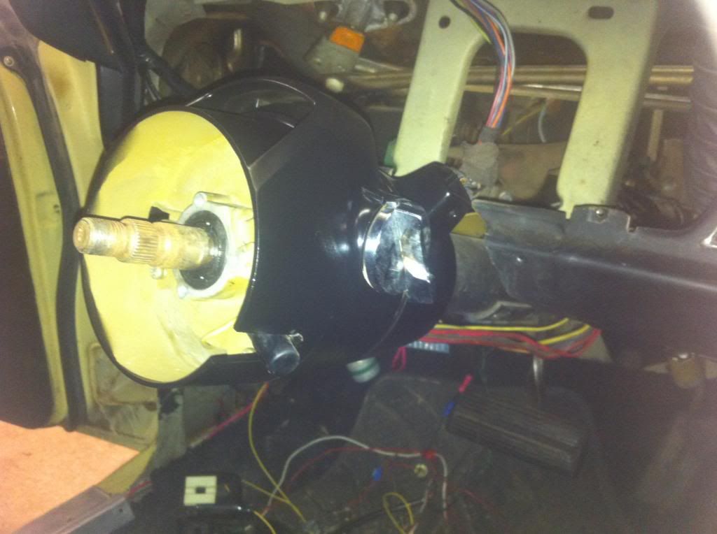

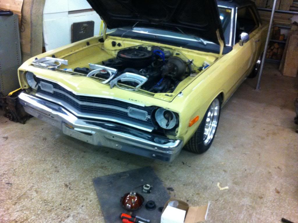

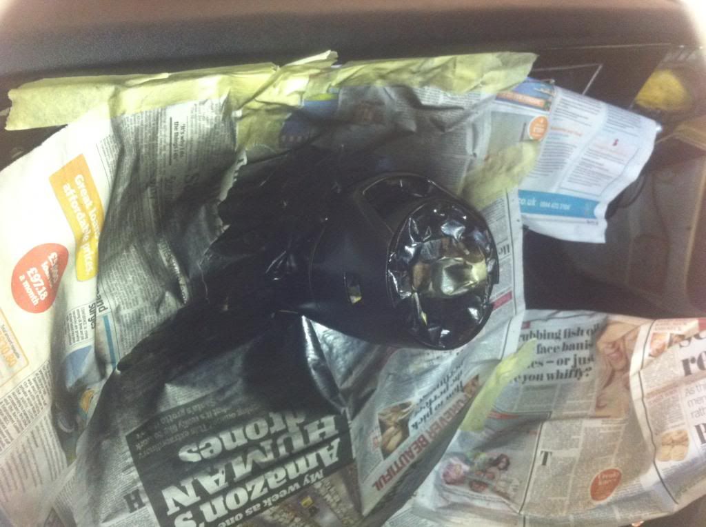

Got the bushes for the wiper linkages yesterday, all fitted up now.Painted the steering column,fitted the replacement indicator switch ( causing the flashing rear lights on their own problem) Just waiting for the correct speedo cable to arrive, then I can put the dash back together.Also fitting RHD halogen lights with side lights integral.

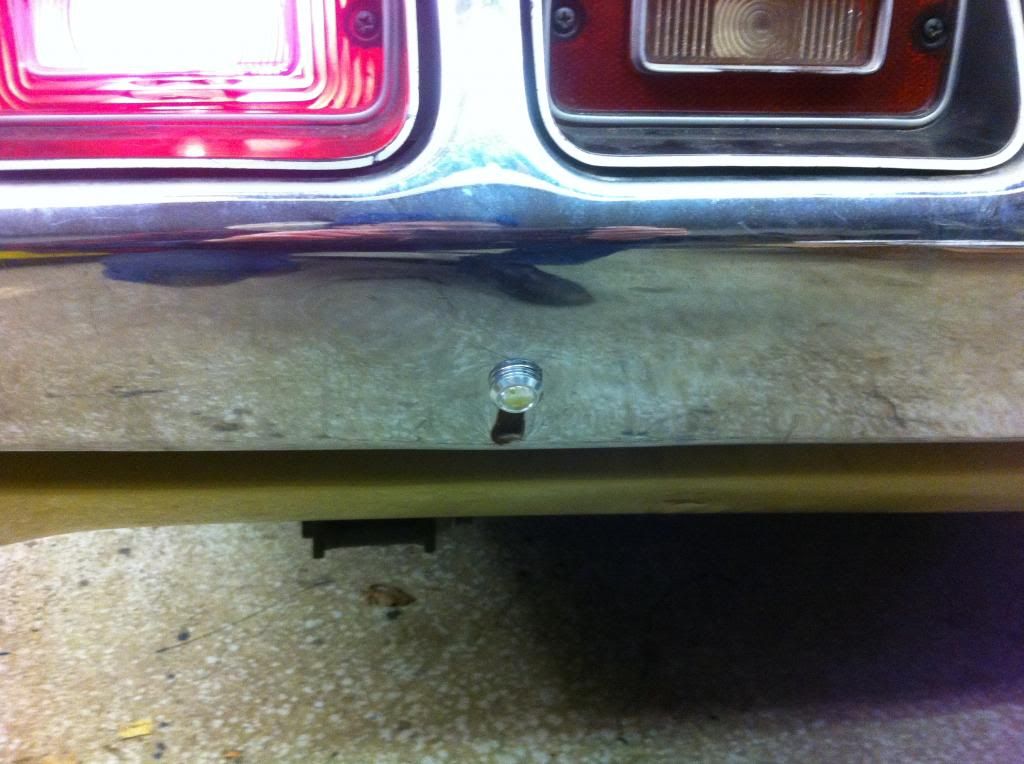

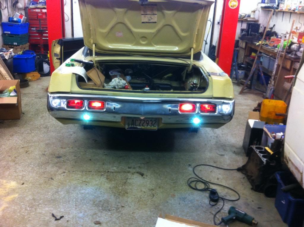

Thanks with your help sending me the wiring diagram. I followed it apart from I put a new wire in , because I wanted to keep reverse lamps,
I found some tiny led unobtrusive ones, that I’m pleased with.
I think I will replace two of the bumper bolts with the reverse lamps, after Scot told me I had put them in the jacking points.
So a bit closer to MOT now.

Posts: 7141
You should be able to fit them in the slots where the original factory bumper overriders would have been (slots on the upper part of the bumper)!
It will also keep your lights in line with the rest! :thumbright:

Dave81 wrote:You should be able to fit them in the slots where the original factory bumper overriders would have been (slots on the upper part of the bumper)!
I did look at that Dave, but they point up in the air like landing lights !

Johnny Dart
Posts: 852
Joined: Tue Dec 24, 13 12:46 pm
Post by Johnny Dart »
MilesnMiles wrote:Johnny, nice work. You realise you don't have to have reversing lights?
They are pretty groovy though 8-)
Thanks Miles, yes I know I didn't need them, but I do !, I live in the country, no street lights,and strong gate posts, I need to see where I am going when I reverse up the drive, and its uphill.
I'm well impressed with them , I bought some more for the bumpers on my van.
