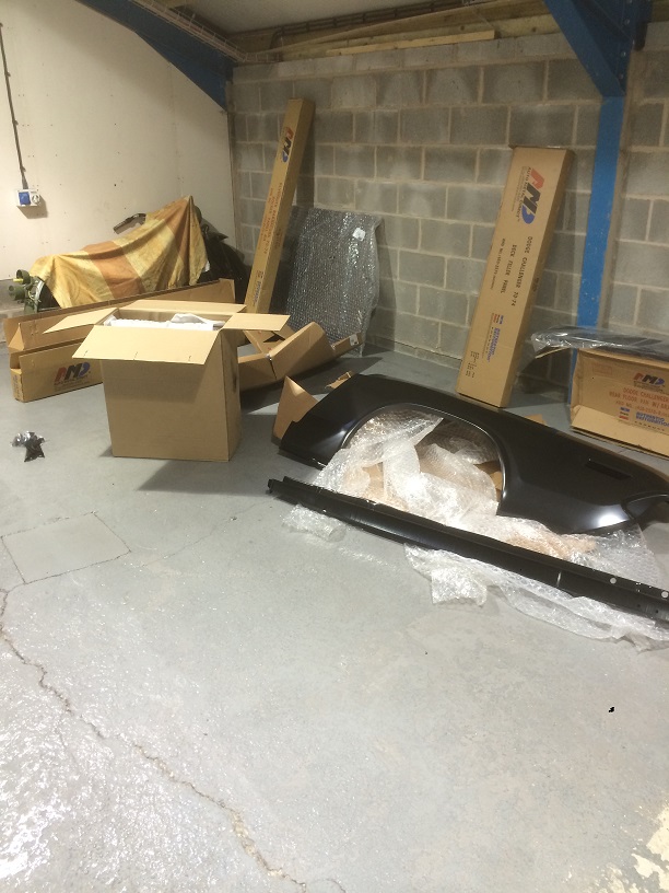

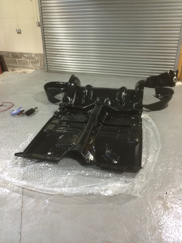

A little more progress. My sheet metal has arrived from AMD, thank you to Ron at STS imports for providing help with the shipping!

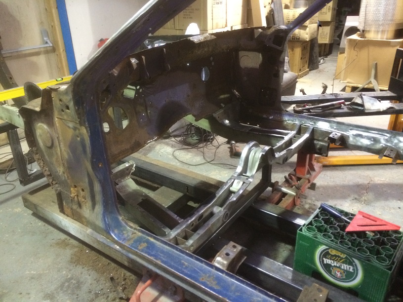

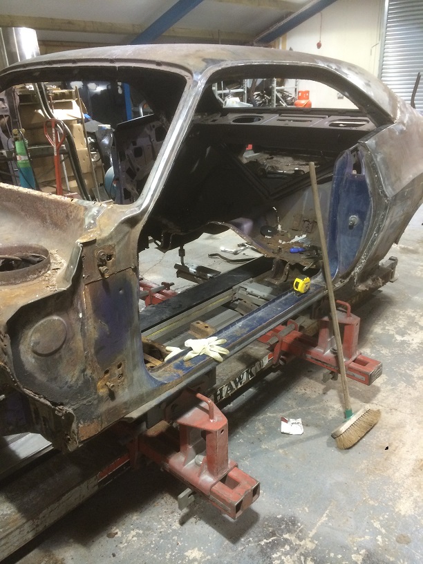

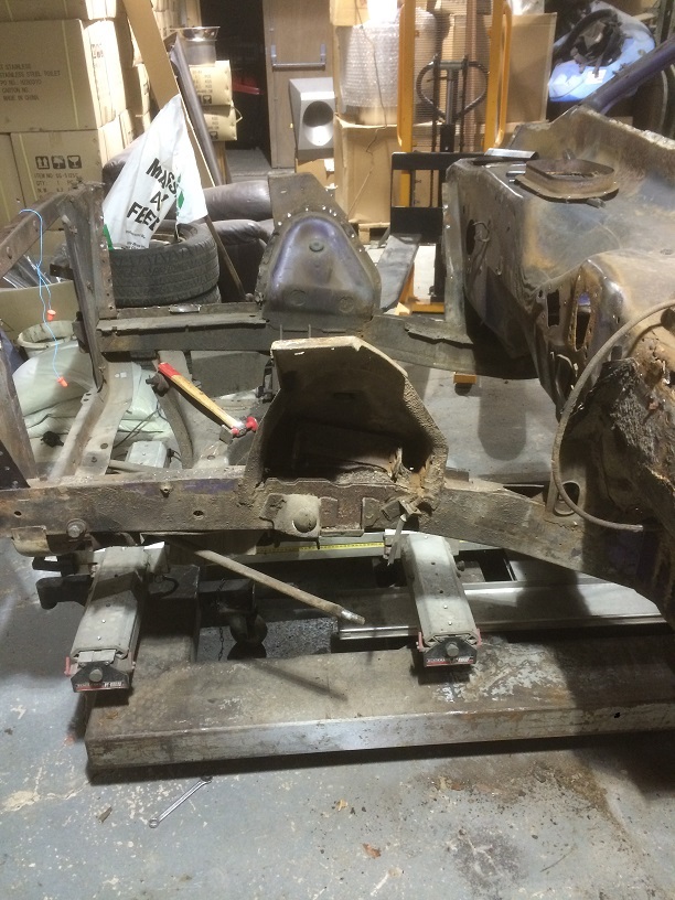

The Chally is now up on a chassis jig and the front floor is out, will hopefully be measuring it all up today from the points that are still there!

chassis jig

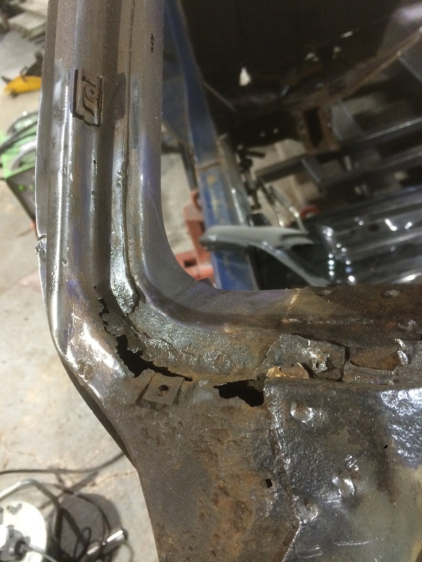

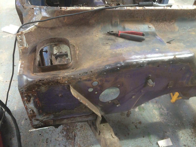

Are you going to cut out those rust holes in the firewall (1st pic)on the bend and replating out of interest, it looks too thin to weld the holes shut?
Tim :thumbright:

Hi Tim, yes ill be cutting a rectangle out and making a new piece for in there at some point.

Post by nigeltaylor »
Too late to turn back now!
Posts: 8368
Wow, scary stuff!! Good luck :thumbright:

nigeltaylor wrote:Too late to turn back now!
The dog thinks so too.

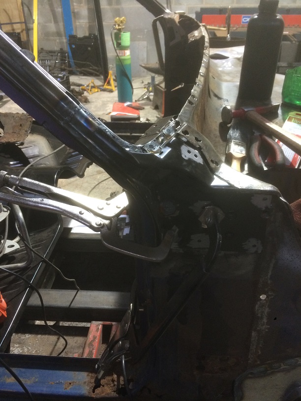

Quite a lot more progress on the Challenger, old frame rails and cross member are out, the K frame came out with the bottom part of the frame rail, not what I expected.
Test fit of replacement frame rails and cross member, old one cam out with some of the inner sill so they have been cut and patched.
replacement test fit
rusty window lower corner

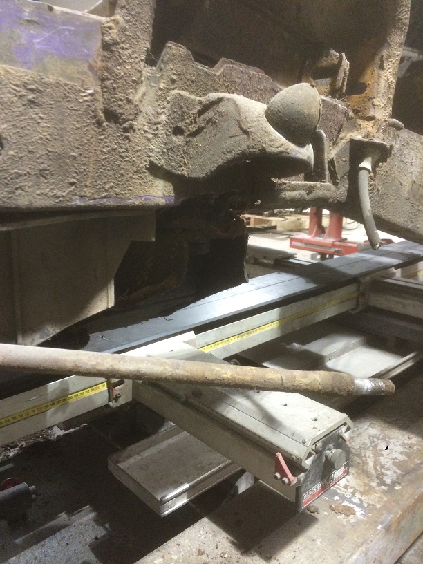

Trying to undo the bolt and it came off with the underside of the frame rail!

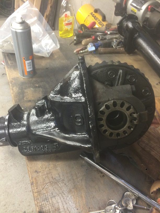

diff back from being checked, painted with two coats of rust inhibitor and black epoxy, ready to go back into the newly painted housing

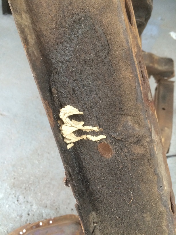

not sure what used to live in the old chassis!

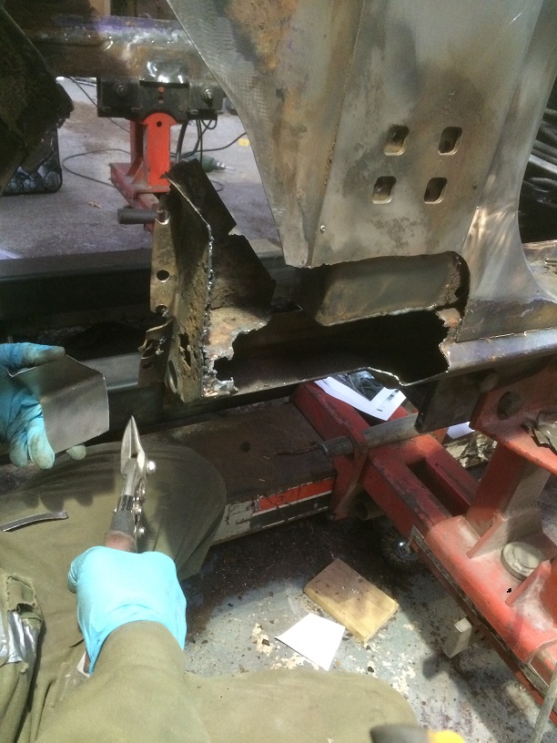

not much left down under the clutch pedal, rocker panel has been cut and repaired, inner door support has also been cut out and repaired with 3mm plate

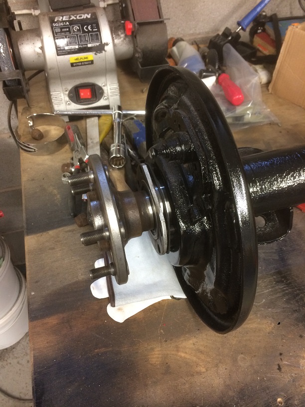

last one for now, new Green bearings installed and hubs cleaned up, threads chased, except the ones which go the other way as I don't have the right die for them!
