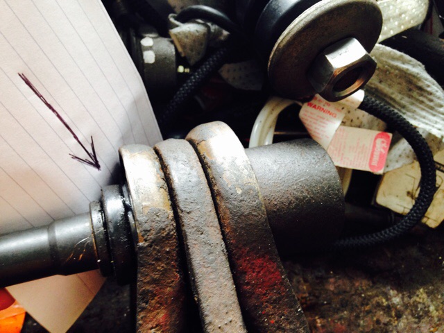

Had a look at everything earlier and found the below that might be causing the issue.
I'm assuming that the pivot shaft should go all the way in to the LCA, as can be seen in the pic, there's a gap between the end of the pivot shaft and the recess for it in the LCA. ( this is after trimming the bushes by the same amount as Morgan had to with his )
In the second pic, the black part with the arrow pointing to it is part of the poly bush, this coincidentally looks to be the same size as the gap left in the LCA recess. So the pivot shaft needs pushing in by that amount?
Looking at a set of original rubber bushes, they seem to sit flush with the LCA, so I'm now thinking that if the arrowed bit of bush wasn't there, the shaft would be in the LCA all the way. Meaning that the LCA would sit closer to the K frame, therefore eliminating the problem of the lower ball joint being to far back?
