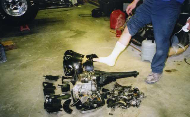

Posts: 14581
Here's something interesting, I'd often wondered how effective those TCS Kevlar trans shields really were, well here's the proof they ain't bulletproof! You can clearly see the damaged shield at the top, I guess it saved his leg but he still ended up with a broken foot.
