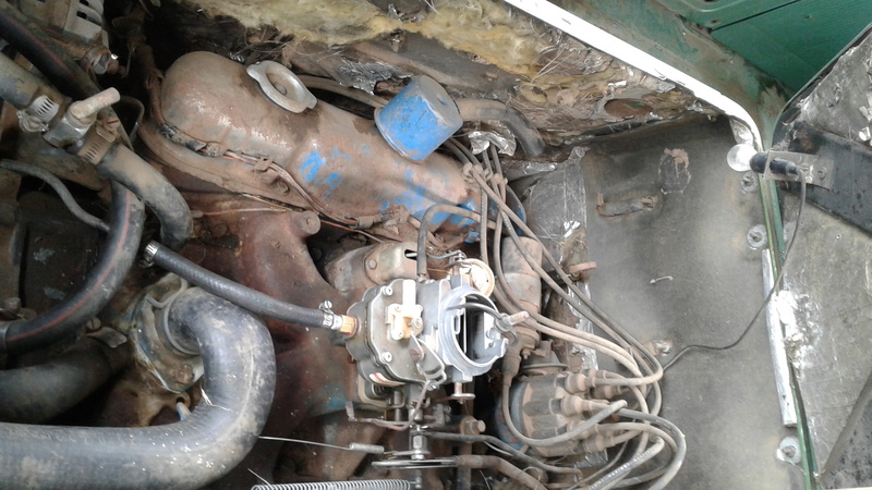

So this will need an upgrade!
It has flooding issues so I have all the excuses I need to bin it. I'm thinking 650 Holley, but what manifold?
No big power increase required just wake it up a little. It may get headers and cam too but not straight away.

Posts: 14424
Edelbrock performer would do the trick, and by chance I will have one available in the not too distant....

Got a 600 Holley on my 318 Paul and fits the bill perfectly (for now). Depends if your gonna start chasing power or just want a cruiser.
If your going cam and other bolt ons etc then id go 650, but id think the 600 would be better on a near stock teen with stock heads??

Posts: 8368
Dave81 wrote:Got a 600 Holley on my 318 Paul and fits the bill perfectly (for now). Depends if your gonna start chasing power or just want a cruiser.
I'd like to pep it up a little but I think for this one, as it's my new daily driver, torque and driveability with a nod to fuel economy (I bet you never thought you'd hear me say that!)
