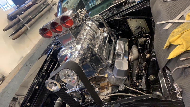

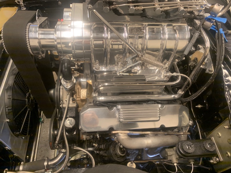

I shall let you know what it’s like
- 9543D30A-FC0E-42EC-BF0B-8398785DBF91.png (115 KiB) Viewed 2396 times

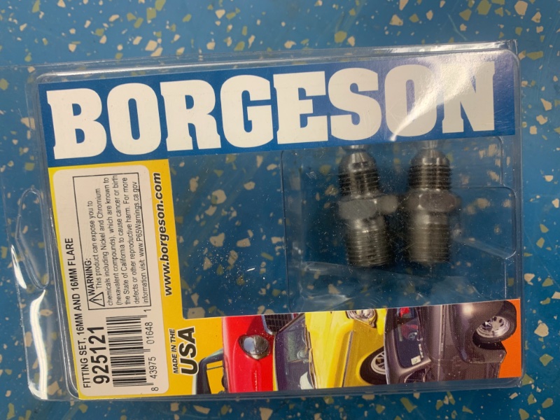

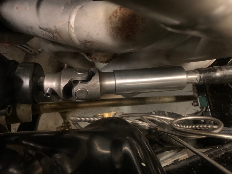

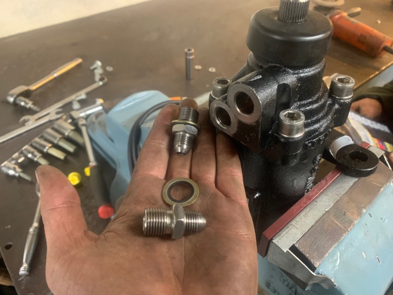

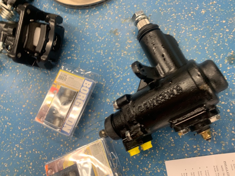

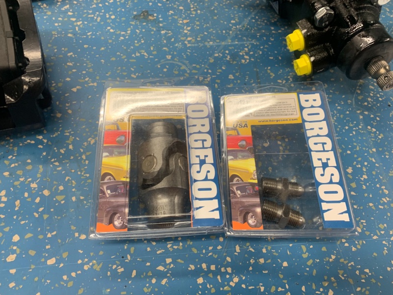

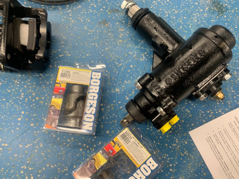

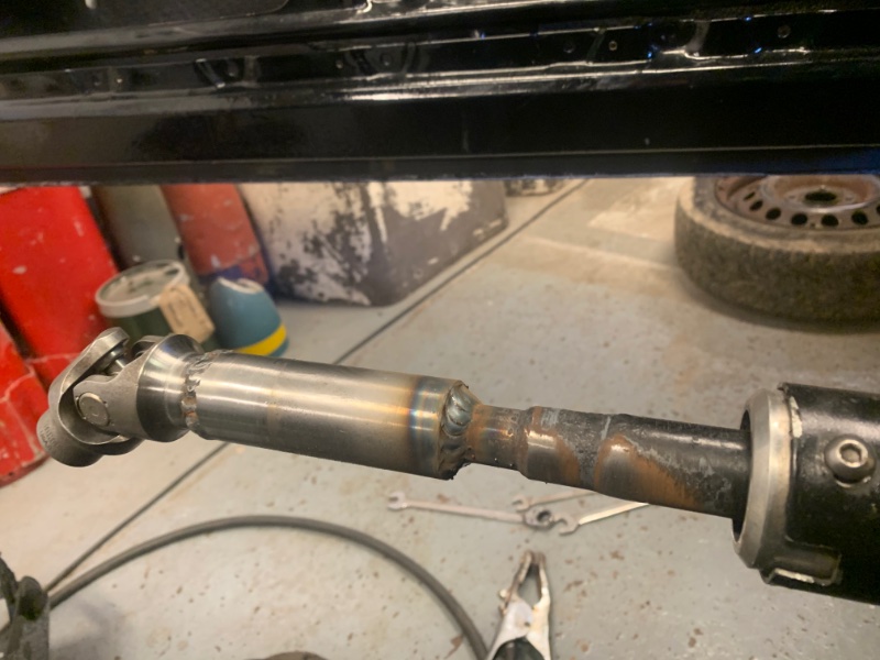

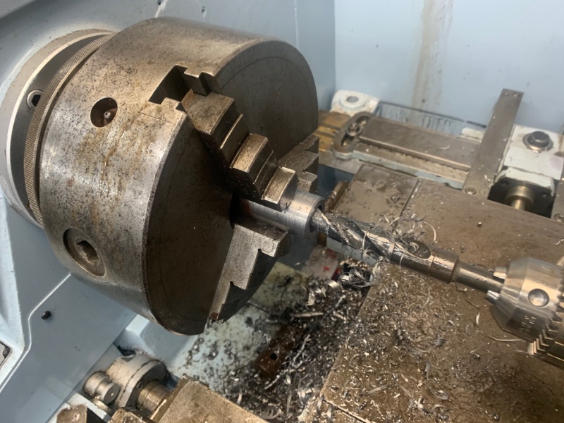

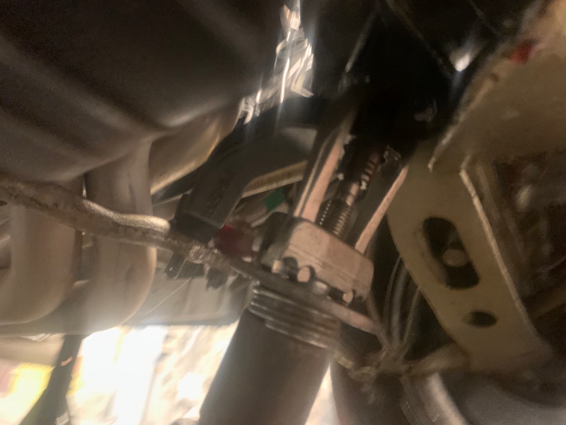

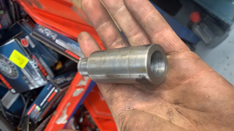

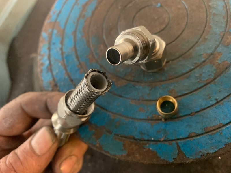

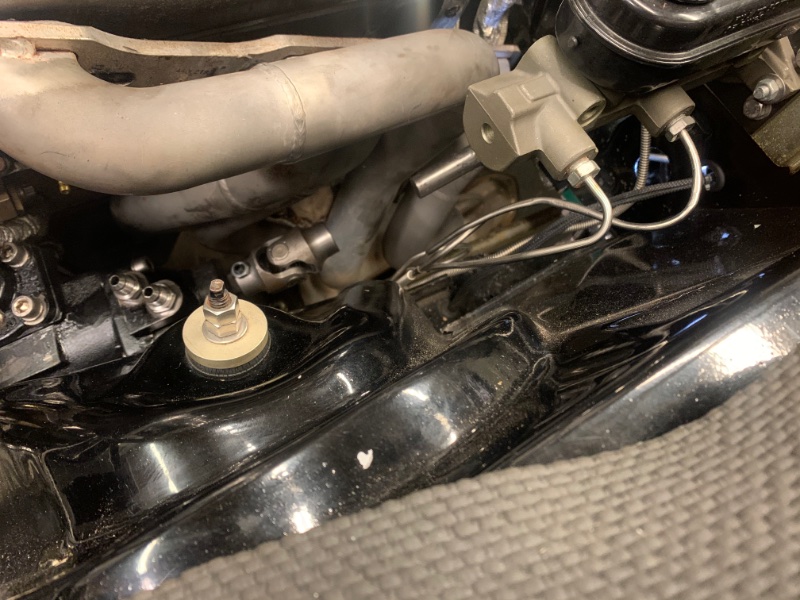

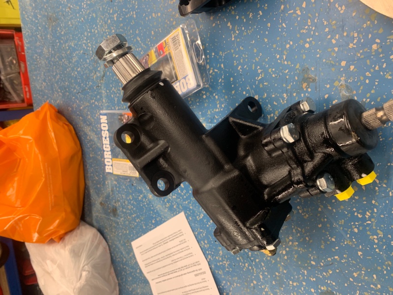

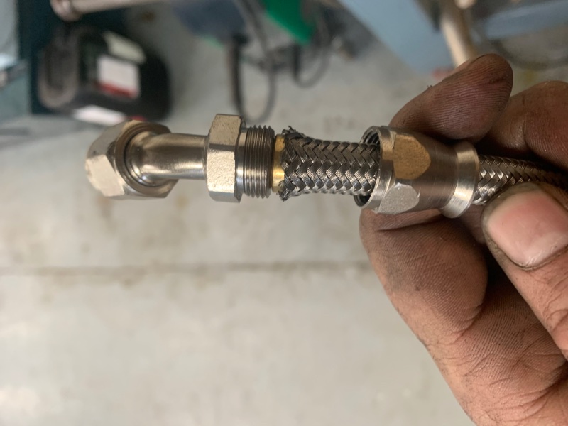

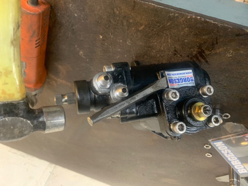

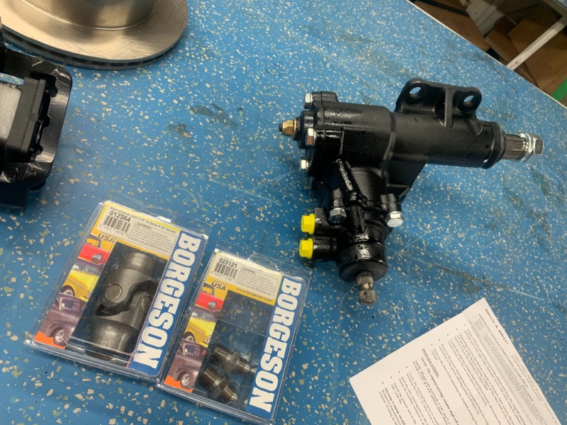

This has arrived but it’s a real casting !
I shall keep you all informed!!!
- 7AFA77BA-8F6E-4B3F-9067-B51B3E86C3B9.jpeg (220.82 KiB) Viewed 2337 times
- 8091B5B7-29DB-4437-9510-06B3CB85D253.jpeg (259.89 KiB) Viewed 2337 times
- 7BC11A28-BF7B-4D71-8ACD-511C2537D67D.jpeg (243.43 KiB) Viewed 2337 times
- D2D4B8E9-EFAD-47F3-A8EC-9069A6991930.jpeg (202.51 KiB) Viewed 2337 times
- BC84E31A-B4B4-4D82-B048-B663923805F4.jpeg (196.87 KiB) Viewed 2337 times
- 50D29727-97D4-40DE-82F3-9E5E6E4DB9B9.jpeg (209.77 KiB) Viewed 2337 times
- 67E692B2-CDE7-4EAF-93A3-3DCDF716BA1B.jpeg (234.69 KiB) Viewed 2337 times
- 8ECF1CE7-9C2B-4FD8-B949-F353A7EC30F8.jpeg (203.87 KiB) Viewed 2337 times
- C35587CC-44DD-4473-A909-6D91608BF60B.jpeg (212.49 KiB) Viewed 2337 times
- 6718DC46-A54F-4058-9563-D6439106EBF6.jpeg (199.16 KiB) Viewed 2337 times
- 23F9683D-B718-4606-B675-D8C20BCE9D43.jpeg (216.15 KiB) Viewed 2337 times

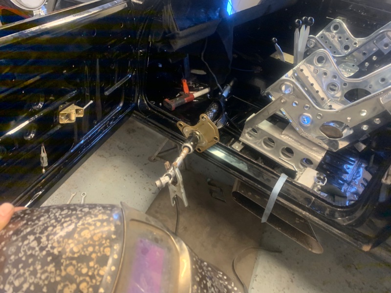

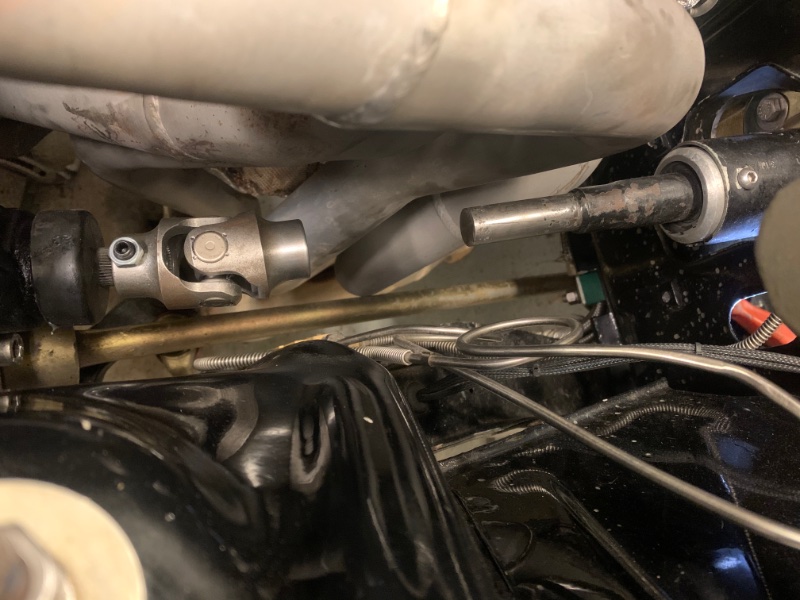

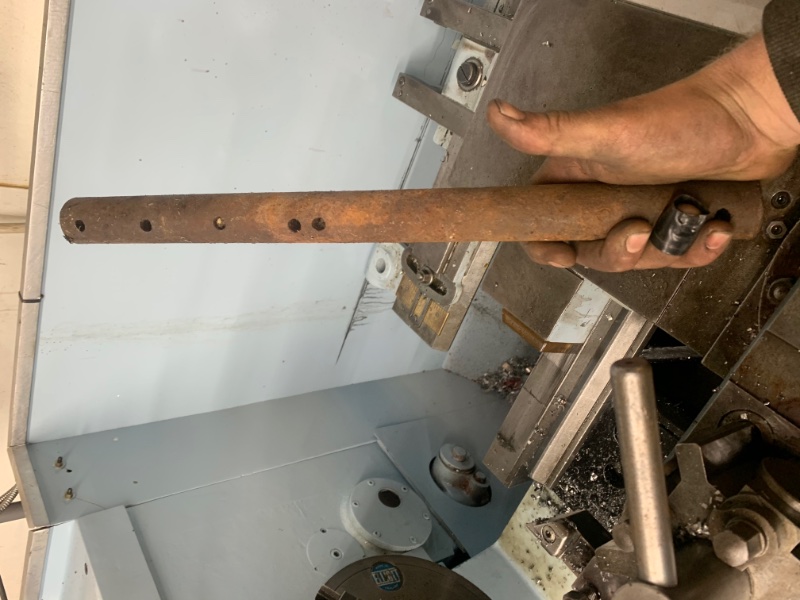

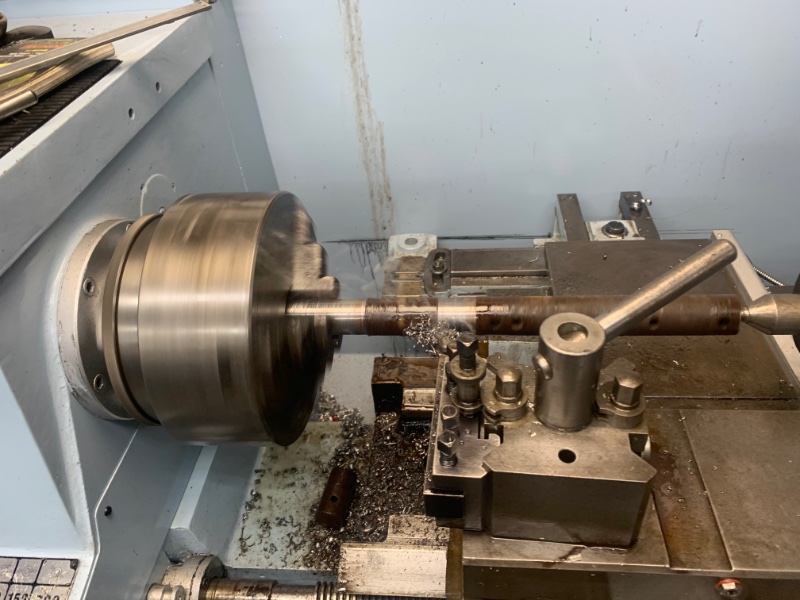

Re: Firmfeel steering ?
looks like you got the Mk2 version
mopar style case without welded on ears
id be inclined to use a normal pot coupler
you will have to chop the end off your column shaft to fit that joint
you will also need metric to mopar power steering pipes or some kind of adapter i would think
ah once all the photos downloaded i see you are already in possession of the adapters

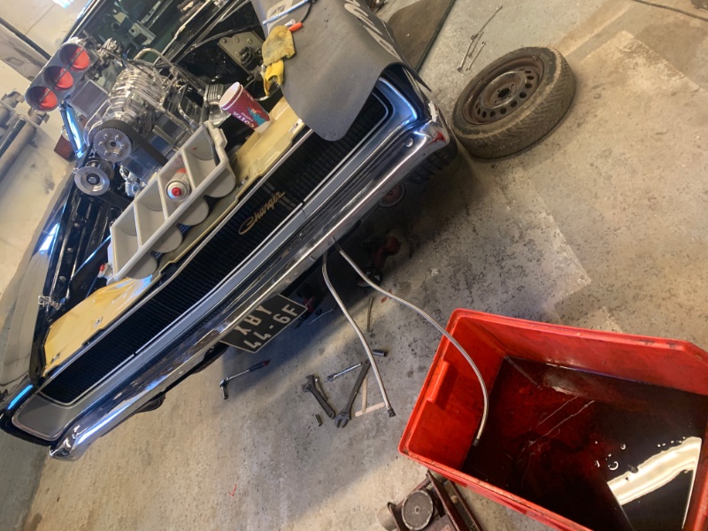

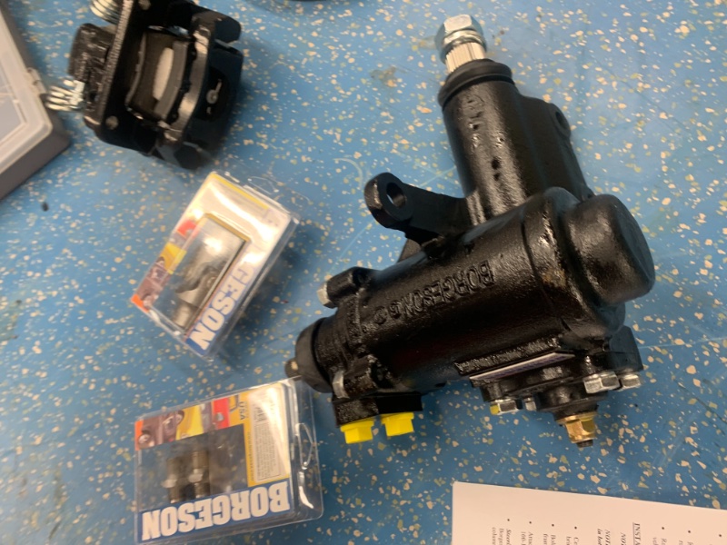

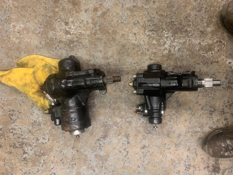

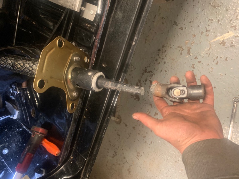

Well I finally am getting my arse in gear and have the old one out and the new one installed.
Help !!!!
Last job refit pitman arm and........
My car is a 1968 with 1 1/8 splines pitman arm
I ordered the wrong power steering box with 1 1/4 splines ....
Now what
Do I order a 1973 and up pitman arm and idler will this mess with the geometry ???
Does 1973 above below use same K member ??
Help !!!!
Now what
In terms of "K" Frame, no they are different to yours which is usually quoted as 1968 - 70 but in reality anything from '62 will fit with minor changes - typically braced Idler arm brackets, and the angle of the Steering box mount relative to the "K" Frame.....
Challengers and Cudas up to 1974 are virtually the same, but the "B" Body went all wobbly and rubber mounted - they are totally different to the earlier ones....
