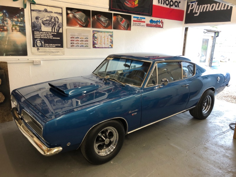

Ready. My unwilling helper and I spent 4 hours cleaning the car Today which is a first...

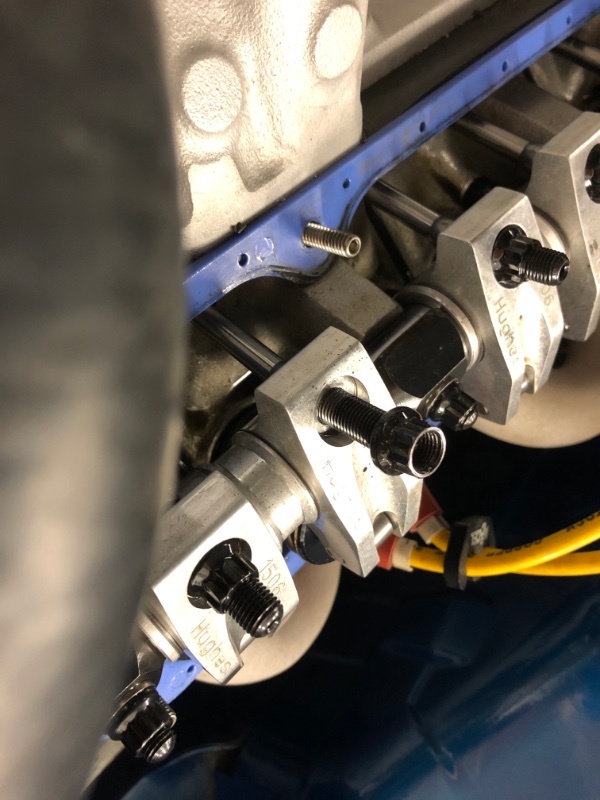

As a few of you know the Barracuda let me down en route and I had to limp it home with a bad misfire. I had suspected it was an ignition or possible charging issue but it turned out to be a rocker adjuster that had backed off and bent due to twatting the rocker cover when I investigated this morning. Wiseman enterprises luckily had a spare so that was fitted and all the others checked for tightness, so back in the game!
Posts: 7189
Re: Chryslers at Brooklands 2022
Ouch! Good to hear you got it sorted. Looking forward to seeing the new incarnation at the Nats if I don’t see it before. :thumbright:
