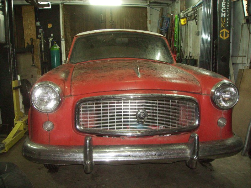

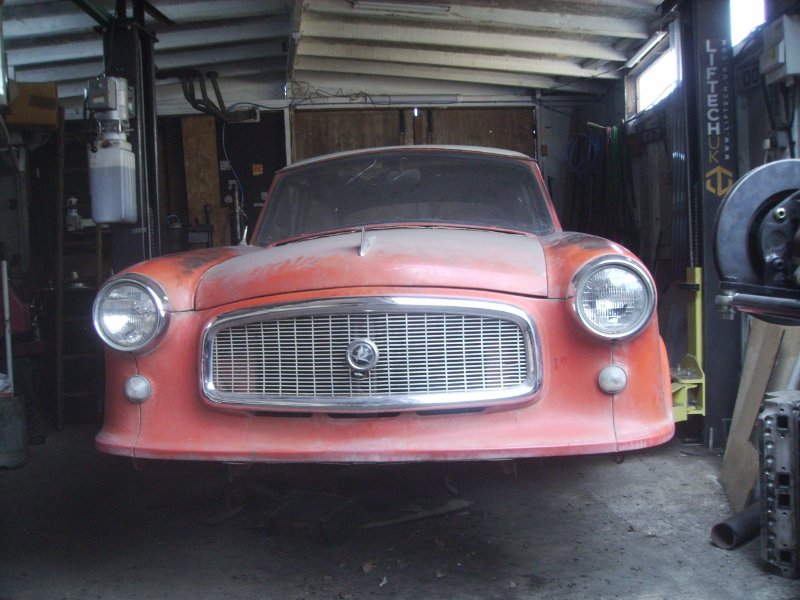

i forgot to add a pic of the car without the front bumper, doh! so here's a before and after comparison and apart from the likeness to a hovercraft i prefer it without. anything other than a gasser/street racer look i'd refit it but.......

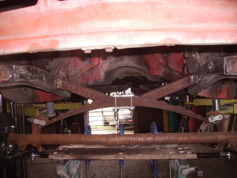

Posts: 1611
Re: '58 (nash) rambler american family project
today ash came here and we got a fair bit done. we cleared all the scrap metal under the car and swept up before making more mess by grinding all the cut edges smooth ready for some seam welding. then we clamped the front axle on the workmate and dragged it under the car, measuring, moving, measuring, moving. measuring.......... finally it's where it needs to be so next job is to make a spring crossmember between the chassis rails so we can clamp that in place.

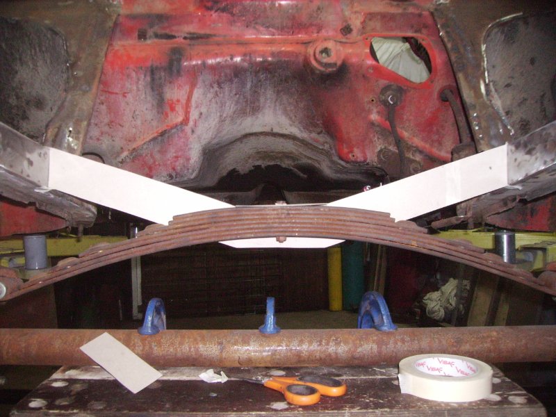

Posts: 1611
we spent a little while playing with cad today. the first design we felt would be too close to the sump so mk2 is looking favourable.

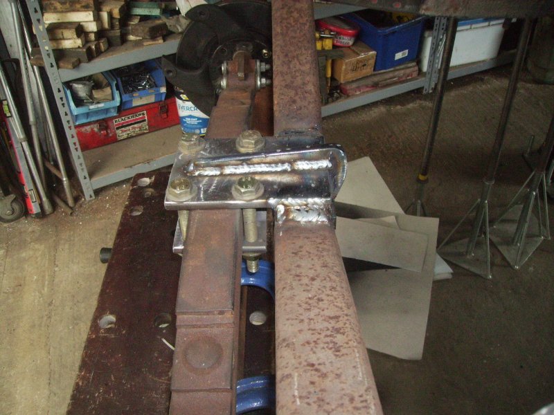

Posts: 1611
today we went ahead with cad number 2 in steel. once welded in place we made top and bottom plates, the top going back over the crossmember. last job was a strengthening 'rib' from behind the crossmember up and forward on the top plate. the bolts are only temporary before anyone says anything 😉.
