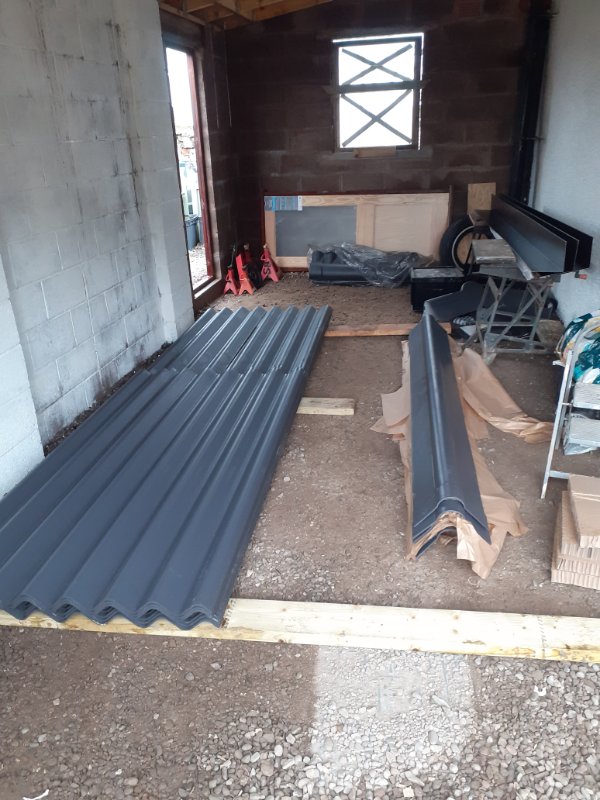

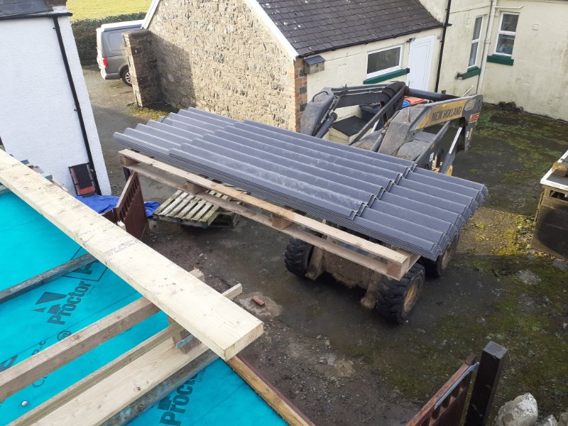

Roofing arrived yesterday, thats the last heavy job but still some prep to be done before I start fitting it. Expensive stuff so I dont want to mess it up :read2:

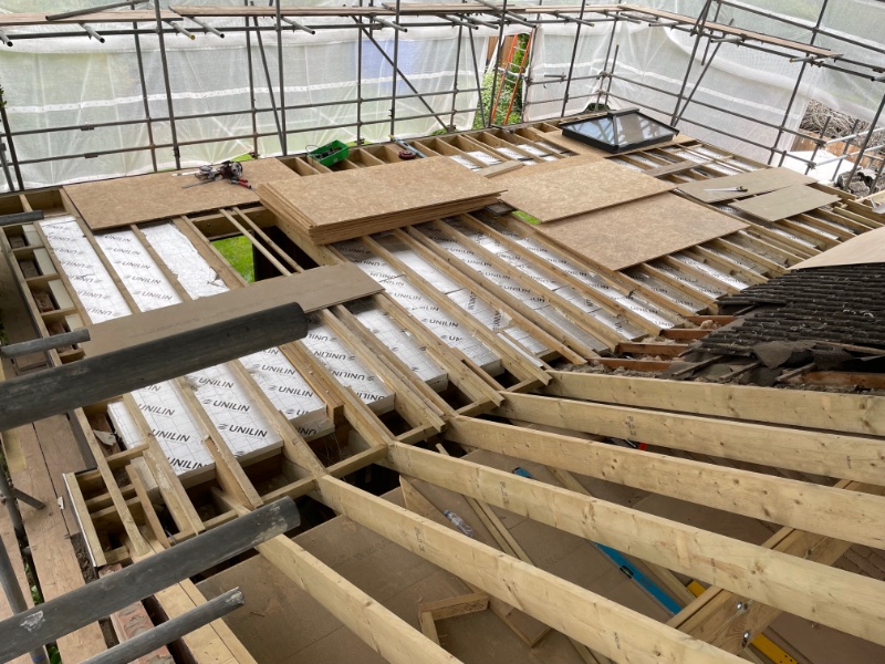

Thanks Matthew and agreed, the render is hard graft so its staying on. I obviously cut channels into it to ensure the vertical wall ties bolted securely to the existing wall. Angle grinder with a stone cutting disc worked fine.
I will research insulation. May well put something between the rafters (that silver coatet slab stuff...name escapes me) but not sure yet.

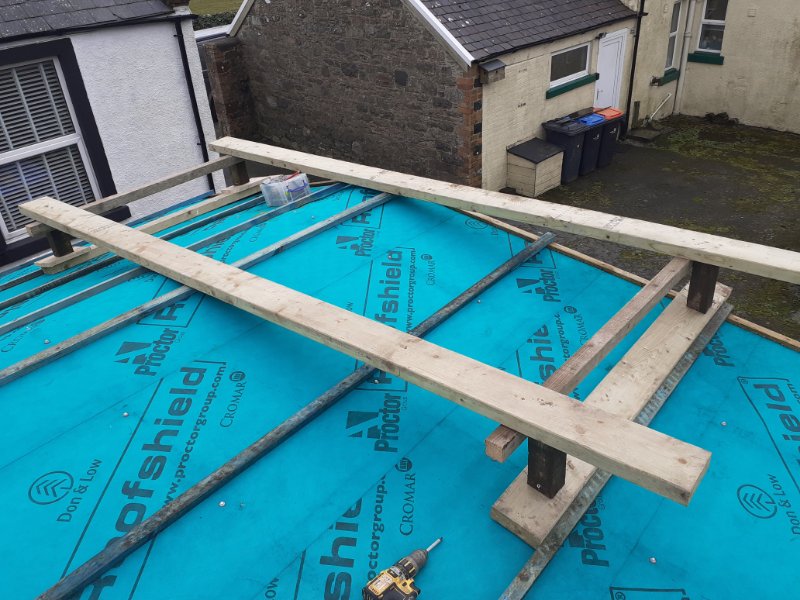

Big day tomorrow as Im putting the roof on. My neighbour has a skidsteer and will lift them up onto a platform I made so they are horizontal and safe to work with....watch this space :thumbright:

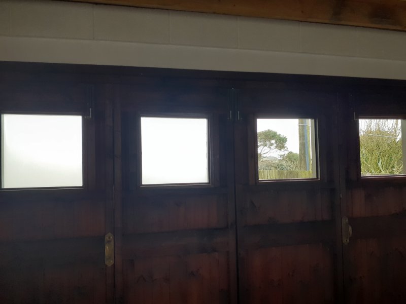

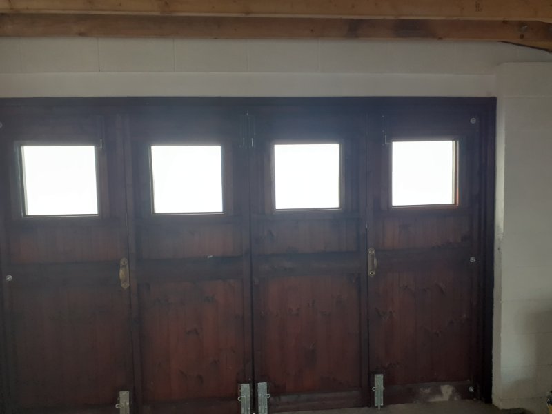

Between showers today, I put the frosted perspex windows in the doors. Really pleased with them as they let tons of light in but offer privacy too.
Posts: 2372
Re: My Dream Almost Complete At Last!!
Like your garage door :thumbright:

Insulation is expensive but I’d definitely do it if you can Steve, walls as well. It’s not just about keeping heat in or out, it stops condensation which is something you really don’t want in a workspace. Due to building regs we had no option but to use 150mm of insulation on our project which includes a garage.

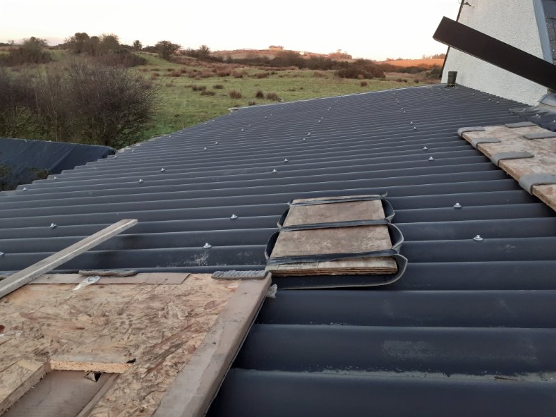

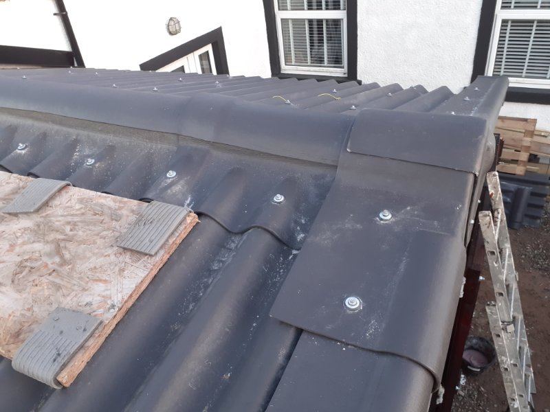

I now have a roof! \:D/ \:D/

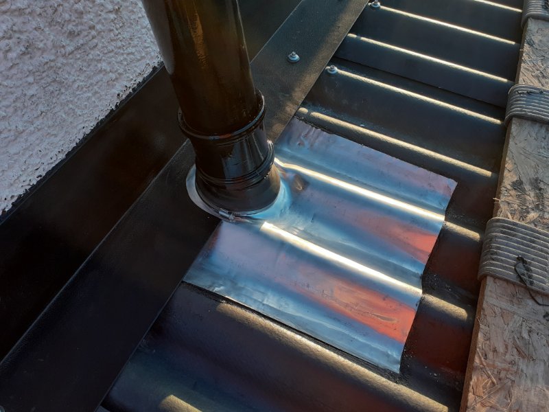

I hope its watertight, will soon find out when the next storm comes along. Will be doing the flashing and soilpipe collar tomorrow then it should be.
Soilpipe opening now watertight and made a start on the flashing...
