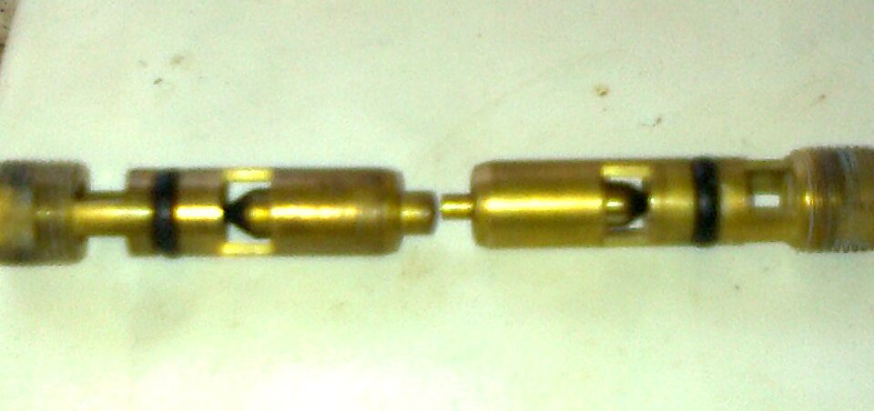

I dunno if you can tell from this crappy photo but my valves are different sizes.
Would this be intentional?
Should i keep them different?
Would the front or rear be bigger ( i didn't notice til i'd got them mixed up

The needles and the seats are different too Dave, sorry it doesn't come out well in the pics.
The one on the left has a larger bore and narrower needle.
There's no mention in Real Steel, BG or Holley info about using different sizes so i'll just get a matched pair.

They do 2 types - one is a high flow for grown up engines.
It should not be an issue as long as you can maintain the float bowls at the correct level without flooding.
If you constantly have to adjust the float bowl levels its a sure sign the assembly is kippered..............
Also make sure all the internal passages and air bleeds are free from blockages.
The other big mistake is using the wrong metering gasket that leaves the pump shot (I think) exposed which also causes flooding...2 different types of gasket that look similar..........one has a semi circular cut out in it that wraps around the power valve and causes flooding if used in the wrong situation.........
