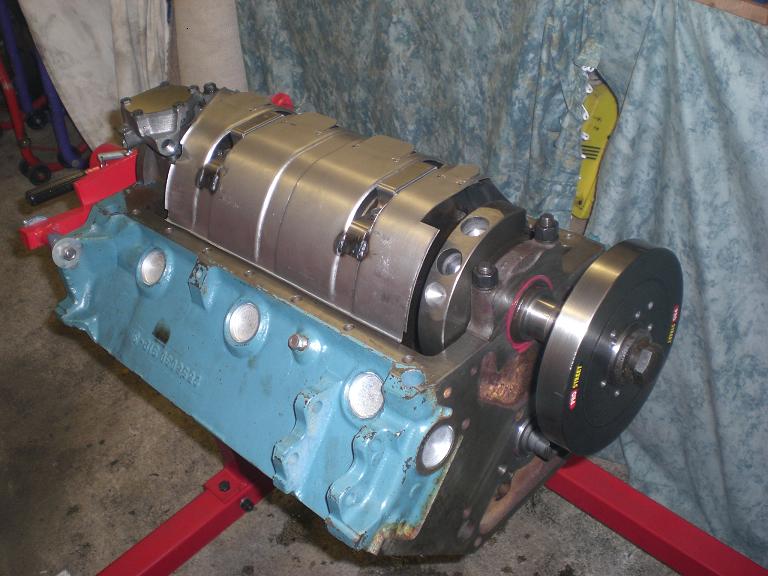

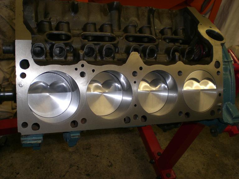

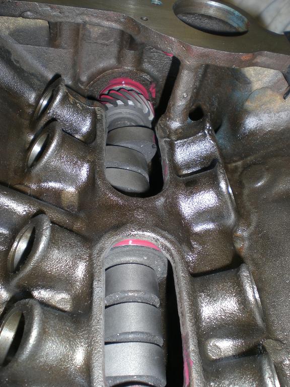

I managed to get in the garage this morning and managed to fit the cam, crank,pistons,rod and windage tray with oil pump so things are moving on well.
the cam was a bit tight so I used 2000 grit wet and dry to ease the bearing and now it spins well.
I fitted the main seal and the crank and once that was all torqued down i started to install all the pistons and rods and once that was complete I had to fit the oil pump and found it fouled the main studs so I had to cut the main stud thread down till it cleared. I was trying to install the timing chain but ran short of time so this is as far as I got today.
Windage tray installed
Crank and rods installed
Gapping the rings
Gapping the rings
Cam installed
Cam installed

Pistons installed
Pistons installed

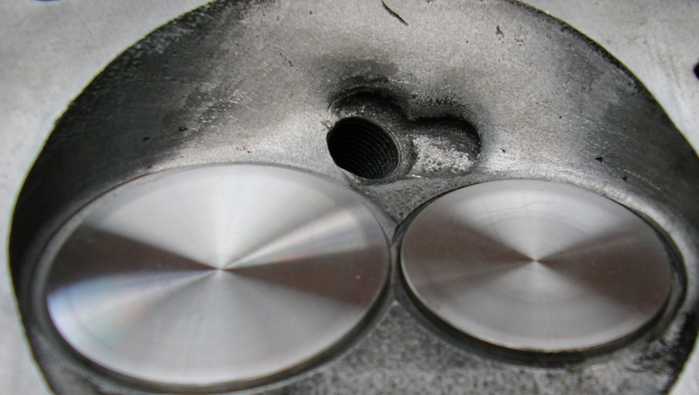

Hi Anton,
How's this for valve and sparkplug deshrouding for 340/360 heads?
Second piccy has the Ferrera Nailhead valves to up the compression.
First piccy shows stock-chamber with stock 2.02's with dishheads.
Bacca.
