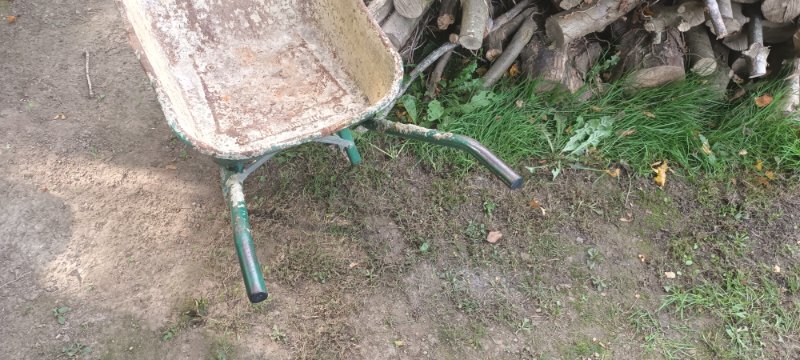

Blue wrote: Sun Sep 27, 26 9:37 am ...Anything but wheelbarrow handles stuck out the back with chrome covers to highlight them further!
x2 :thumbright: :lol:

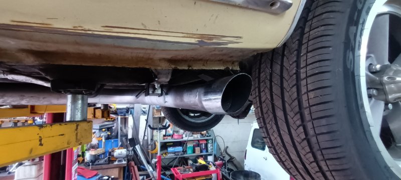

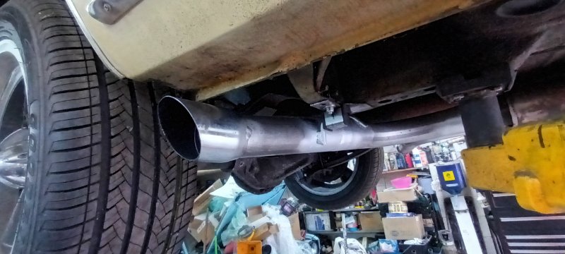

I found these up the garden , I think they would look good,
Very Hot Rod!
Posts: 14656
Re: Johnny's Dart repairs
I believe the company is still bringing in containers (STS imports) though Ron Fenton who used to run it has retired I believe. I don’t think anyone in the UK stocks the correct tips. You will find modern stuff on eBay that just doesn’t look right.
Posts: 14656
Johnny Dart wrote: Sun Sep 27, 26 12:19 pm I found these up the garden , I think they would look good,
Very Hot Rod!
If I ever buy another car that has tailpipes like that, I will fit rubber handgrips before cutting them off…

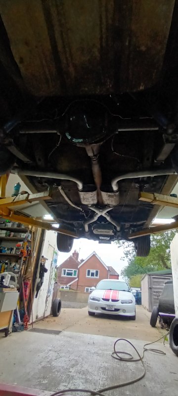

This is what I've decided to use at present, with the intention of over axle pipes at a later date.
"The Cow Horns" exhaust system. That will keep the rear tyres warm.🙂
Johnny Dart
Posts: 946
Joined: Tue Dec 24, 13 12:46 pm
Post by Johnny Dart »

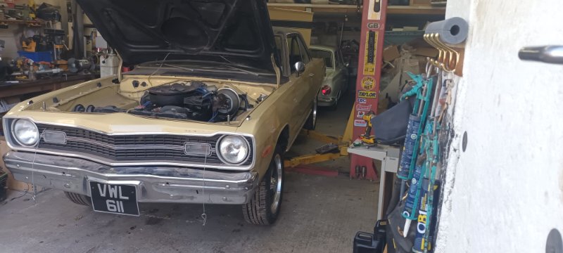

Today I finished off the exhaust, changed the fuel pipes.
Drained the 10 year old fuel, which quite surprisingly smelt like it was still new. Checked the oil and water., filled up the auto box with dextron ll.
I put a new battery on , redid the battery cable .
It started immediately, a bit tappetty for 5 mins , then quiet.
The auto box seems to work in all the gears and only starts in park or neutral.
I had to buy a new neutral/reverse switch, as I managed to break one of the pins, tying to straighten it
Road test next

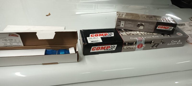

My mission to buy parts 10 years ago.........
I bought a mopar small block Hughes whiplash cam kit.
Lifters and springs.
I bought a comp cams xe268 cam kit. Lifters and springs.
I not sure which to use.
I also have a pair of big valve alloy heads , and a quick fuel 600 vs, and a air gap manifold.
I'm sort of thinking the Hughes cam kit , because I'm not wanting to get involved in high comp pistons.
Any feed back on either choices would be greatly received.🤔
Posts: 14656
Don’t waste your money on fuel injection, the entry level kits offer no performance increase, if you can tune a carb save yourself a couple of grand. I think it’s a 360 you’ve got?

Ah 318 ok. You can’t be losing compression with the small engines so ideally the chamber cc of your new heads doesn’t want to be less than your existing heads or you’ll be losing power not gaining it. I’ve not used that Comp. Cam but I have had a Whiplash in a 360. The Hughes cam wasn’t very happy with the stock convertor even though it’s supposed to be a match. I tried what was advertised as a 2000 stall converter and it was hardly any better. It has an aggressive tickover but I found it a bit lacking at higher RPM. Bolt on tuning options for 318’s are a bit limited as compression is low to start with and the small capacity means any improvement in head airflow is likely to cost you low speed drivability. I’d say you need 10.5.1 compression @zero deck as a basis to start making some power.
