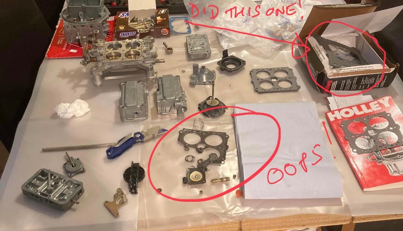

Was just reading through all that and thinking at least I don’t have to worry about the carb anymore and then I looked again at this photo…
When I came to put it back on the car, I only saw the big square rubberised gasket that was left sitting on the intake, so gamely replaced it with the papery one that matched it for size from the kit. Dropped the carb on, jobs a sausage.
Looked again at the photo of the kitchen table devastation and realised I’ve forgotten to replace the 4 holed gasket that goes on the base plate…
Back off she comes in the morning, then…

We've all been there! At least its an easy fix, I could give you a few instances of a forehead slapping moment that were a lot more work than that to sort out...
