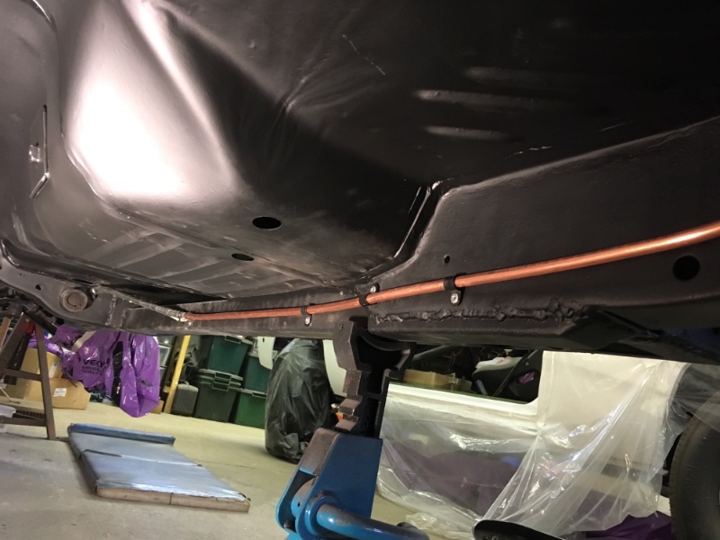

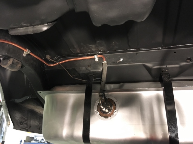

New tank, 3/8" sender and fuel line, all new brake lines...
- IMG_0128.jpg (103.77 KiB) Viewed 4238 times
- IMG_0129.jpg (128.47 KiB) Viewed 4238 times
- IMG_0130.jpg (125.52 KiB) Viewed 4238 times
