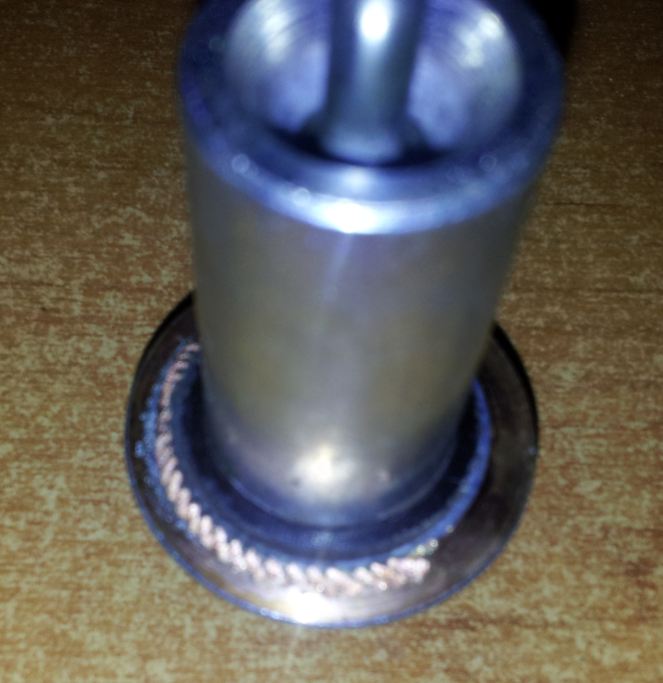

db wrote: all brand new from Neil Willett, ages ago!
I have just had to have my mini starter that I purchased four years ago from Neil rebuilt, I had never used it and only took it out of the box three weeks ago, because of the tight clearance between the terminals and the block I checked with my meter to make sure that nothing was touching where it shouldn't and found it was. So the starter was whipped off and checked on the floor and found it was dead so I took it to a local electrical specialist, where a freind work and was present when it was stripped only to find it was not new inside. to say I was a bit miffed is putting it mildly. heres a picture of the actuating plunger that was removed. Even at mates rates it cost £65 to be fully rebuilt.
Just because it comes out of a new box don't mean its works get it checked
"All that glitters is not gold"
By the way I am not implying the Neil knew about this.
