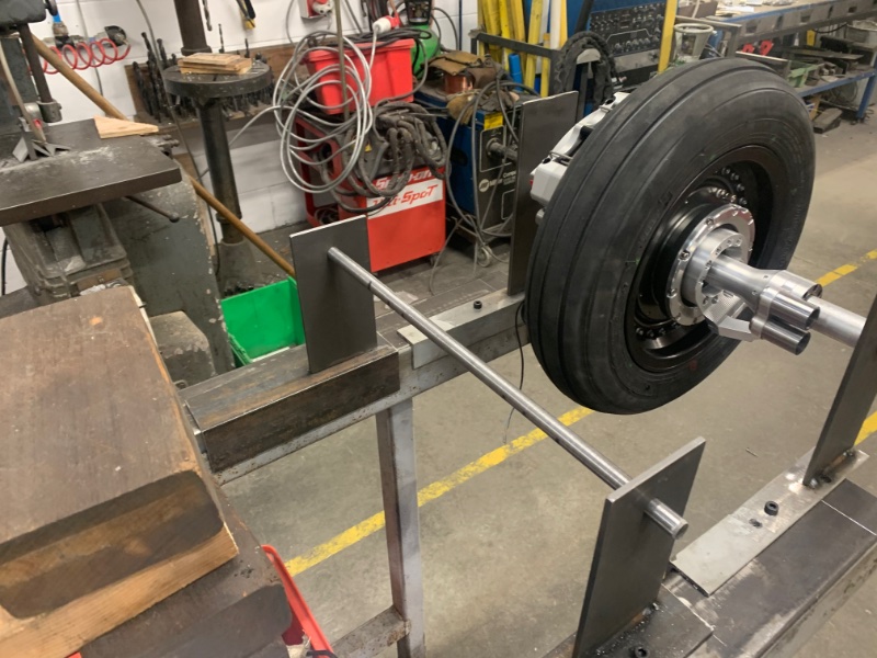

Pete wrote: Mon Dec 23, 19 7:46 pm That plan must have really extended the wheelbase - I thought you were going for bars in front of the wheel?
Yes, the plan was to have Handel bars in front of the front wheel but the more rule books we read the harder we think this will be.......
AN Example below from FIM rule book this would be needed to complete with these boys.
:read2: 8-[ :-k :roll: :shock: :? :x [-X [-o< 8-[ [-(
Streamlining: The rider, when in the racing position, must remain completely visible from either side of the motorcycle and from above, without having to look through any material. Only hands and forearms may be hidden when viewed from above. The rider must have unrestricted (fore/aft) movement of the arms when seated in racing position.
With the rider in the racing position, no part of the streamlining shall cover the front wheel rim when viewed perpendicular from the side, (with exception: the area behind the front fork down to the horizontal line drawn through the front wheel axle as limit). • A front fender is compulsory but shall be restricted in line with the following requirements: - viewed from either side, at least 180° of the lower part of the front wheel and tyre shall remain visible. - No part of the front fender shall be below a horizontal line drawn through the centre of the front wheel axle and in the front fork/ - suspension axis.- The front and rear section of the front fender shall not make contact with any part of the motorcycle.

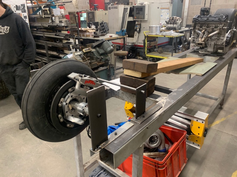

All major parts are now jigged up in place :roll:

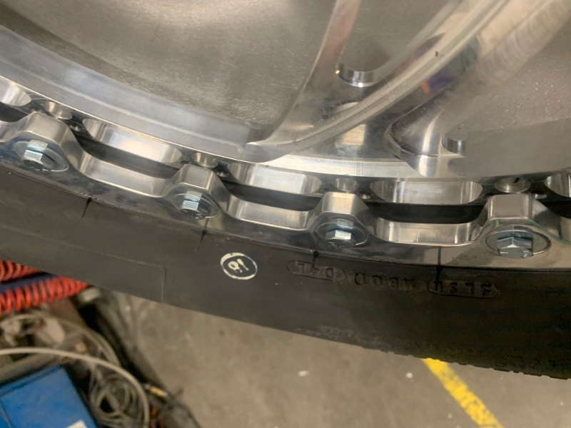

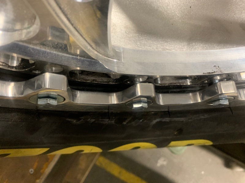

Well I didn’t see this one coming !
Land speed tyre have a bead that is thicker than drag tyres !!!

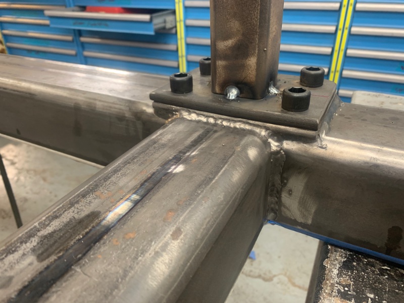

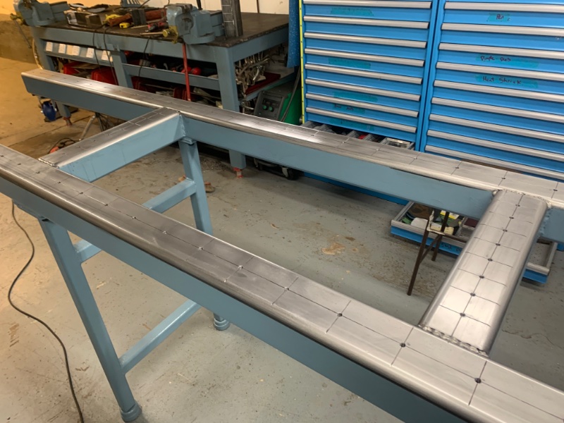

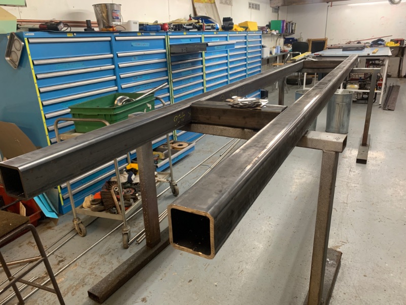

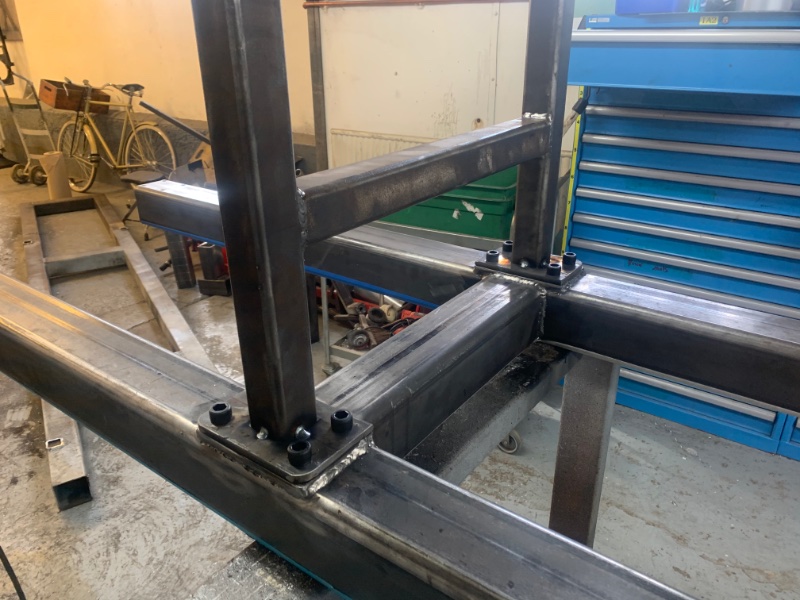

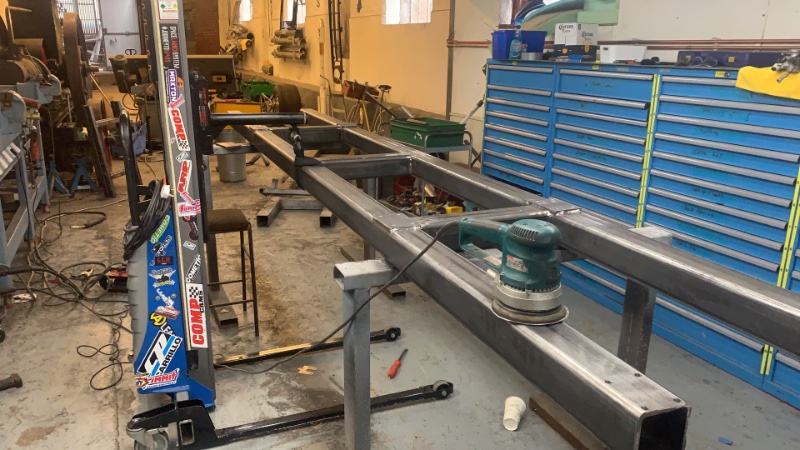

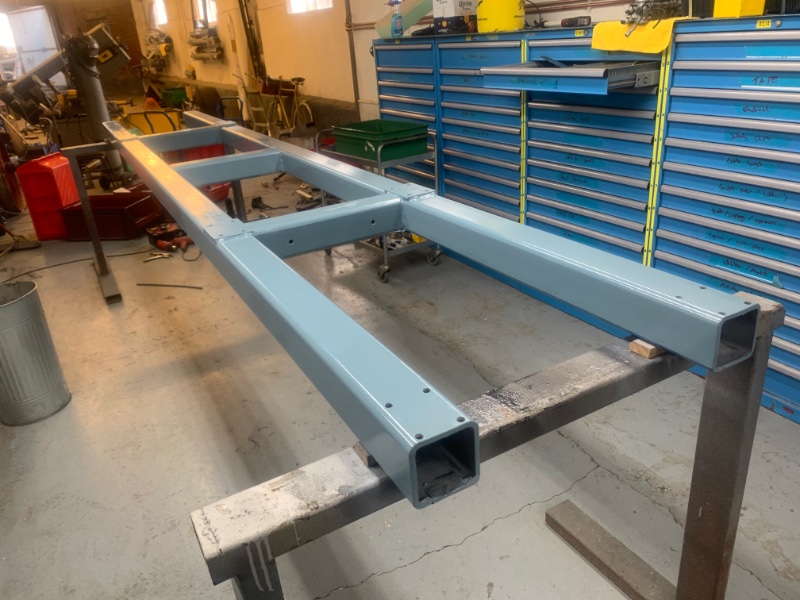

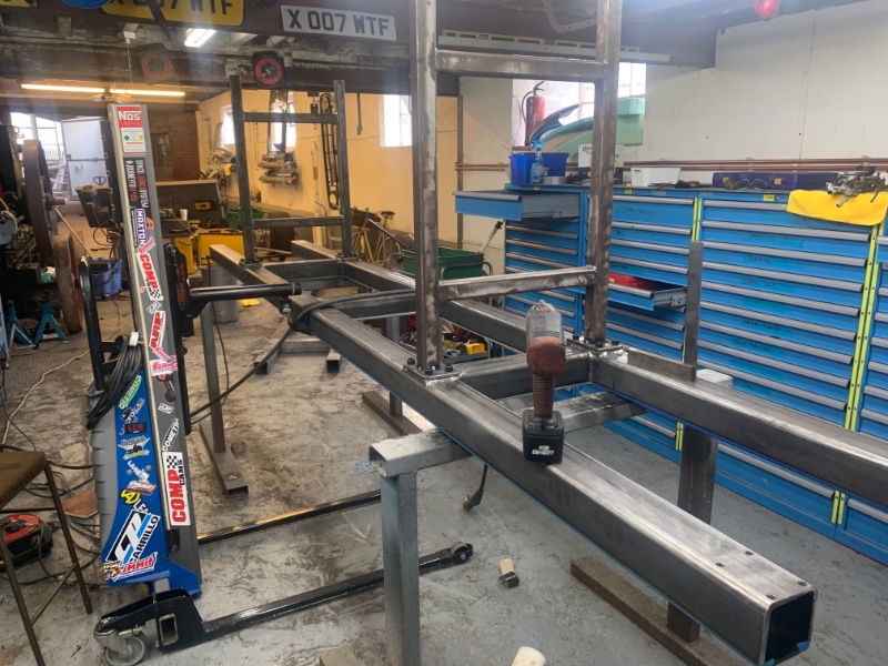

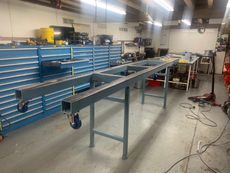

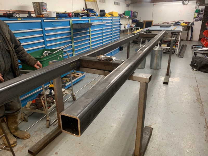

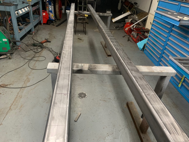

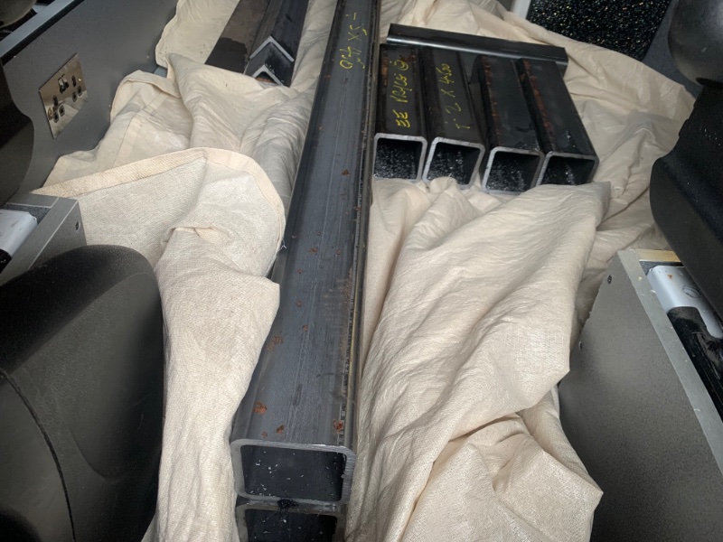

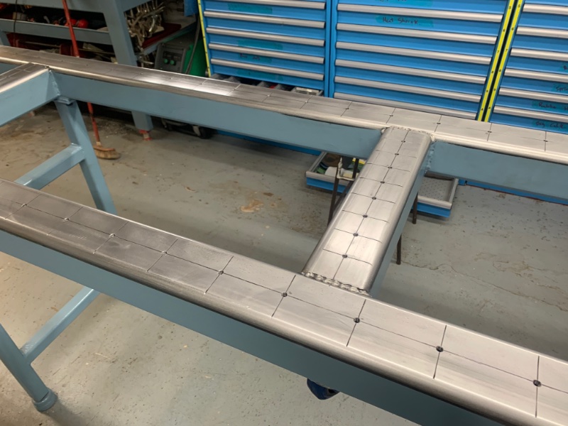

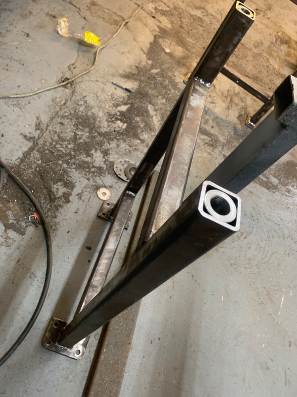

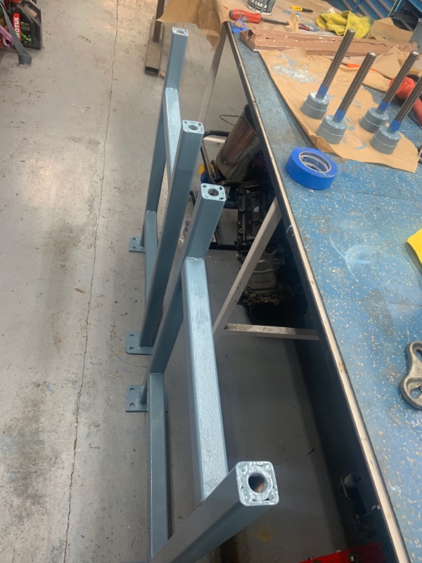

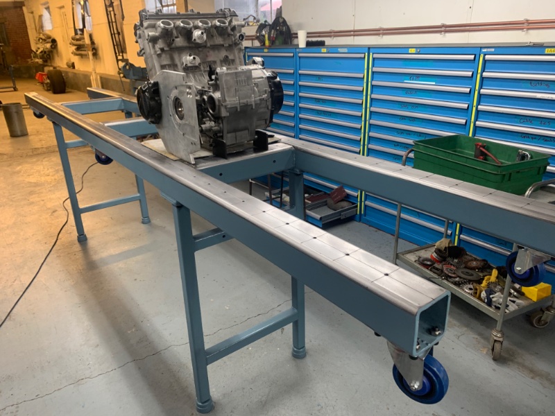

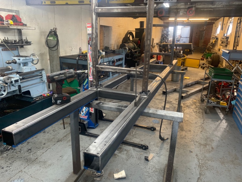

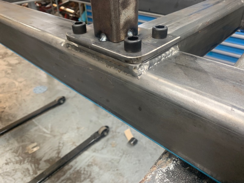

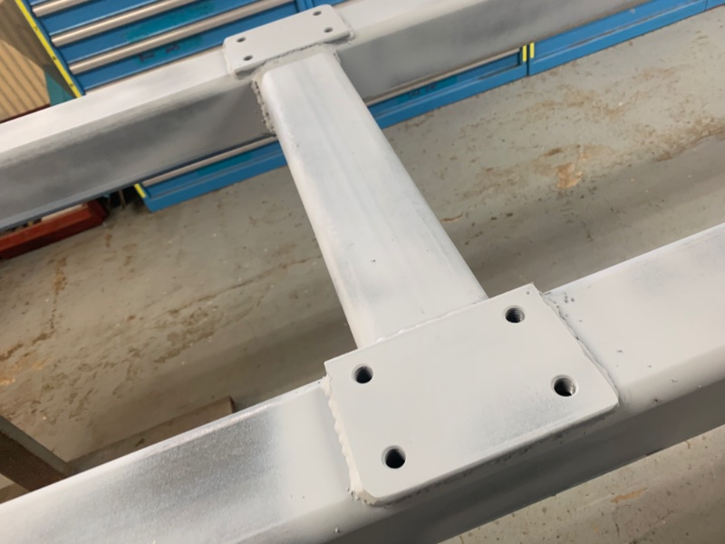

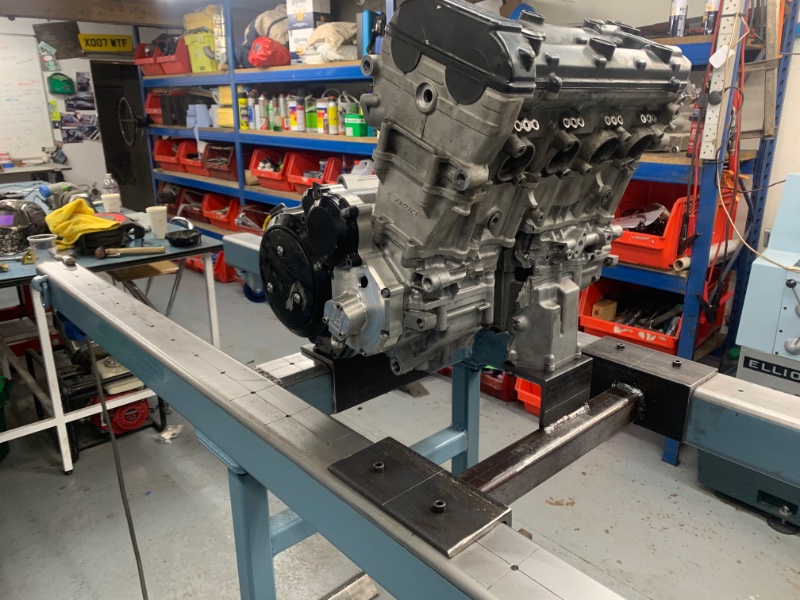

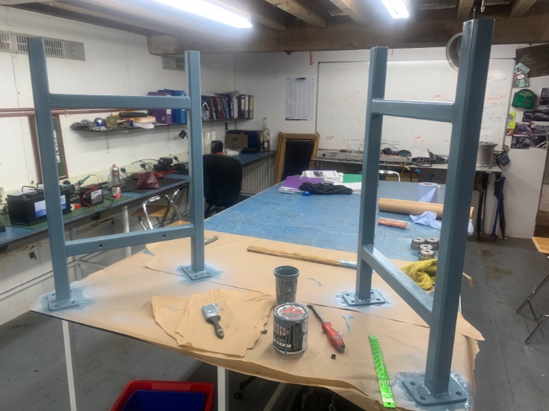

Things are moving forward and decided to build a brand new Jig to build the new bike off !!
The steel is all 10mm Thick and way OTT
Posts: 22262
Re: Fifty shades of Jade
Fantastic work as ever!!!

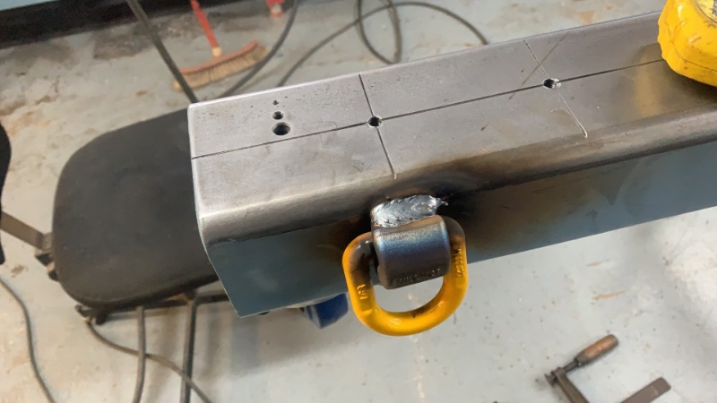

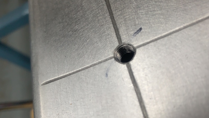

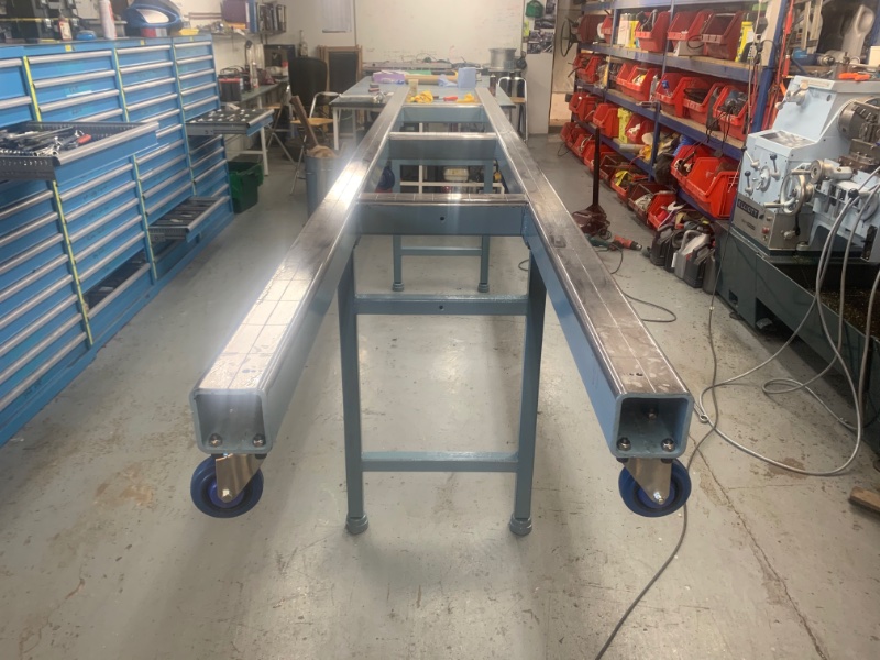

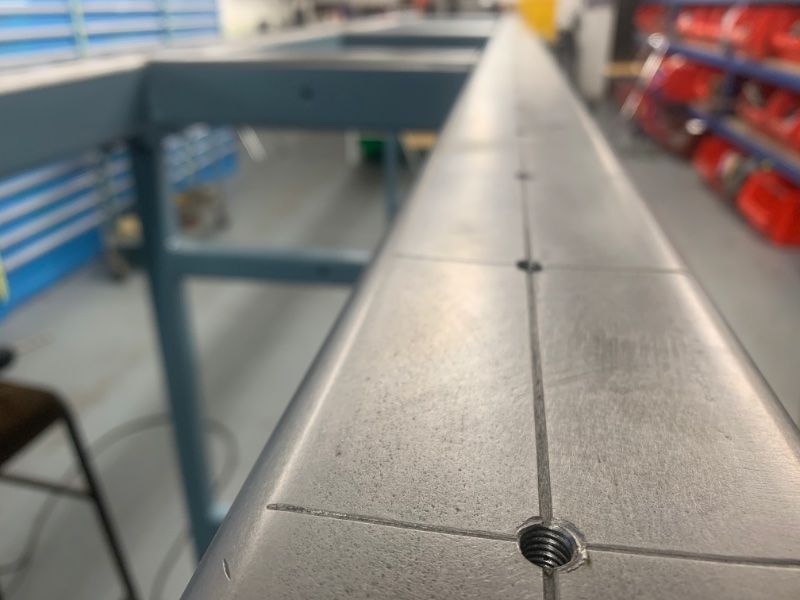

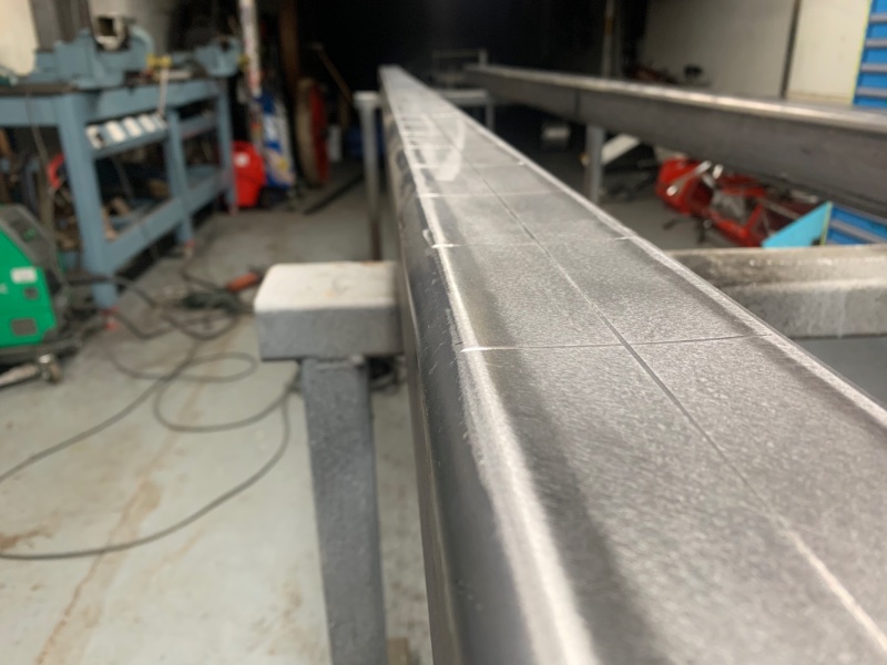

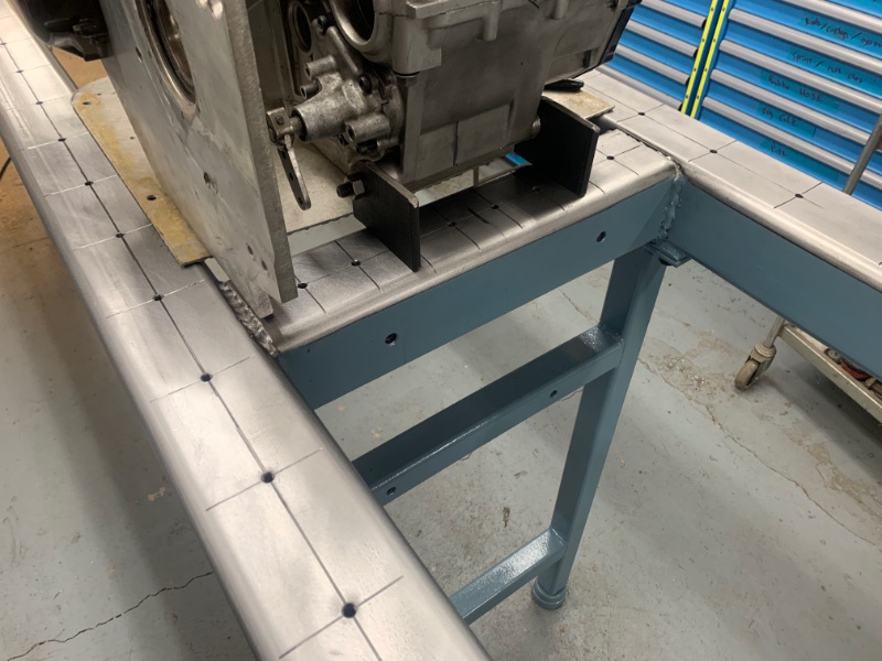

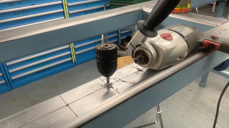

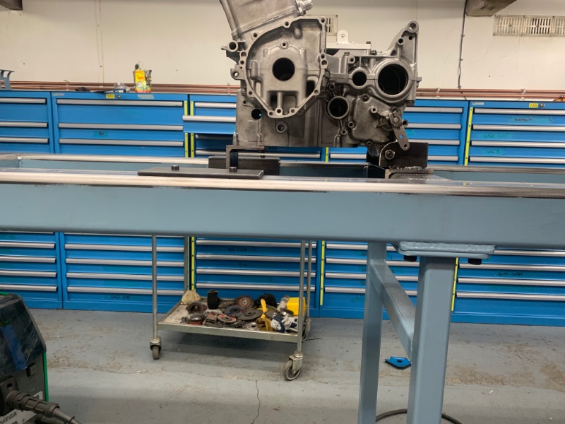

Table is 4000mm Long using 100mm x 100mm x 10mm Box bars
Table is Level in X Y Z and parallel to the grinned lines and taps holes within 0.3mm and 0.1° :geek: Mission

Looks substantial, that ain't going bend :thumbright:
