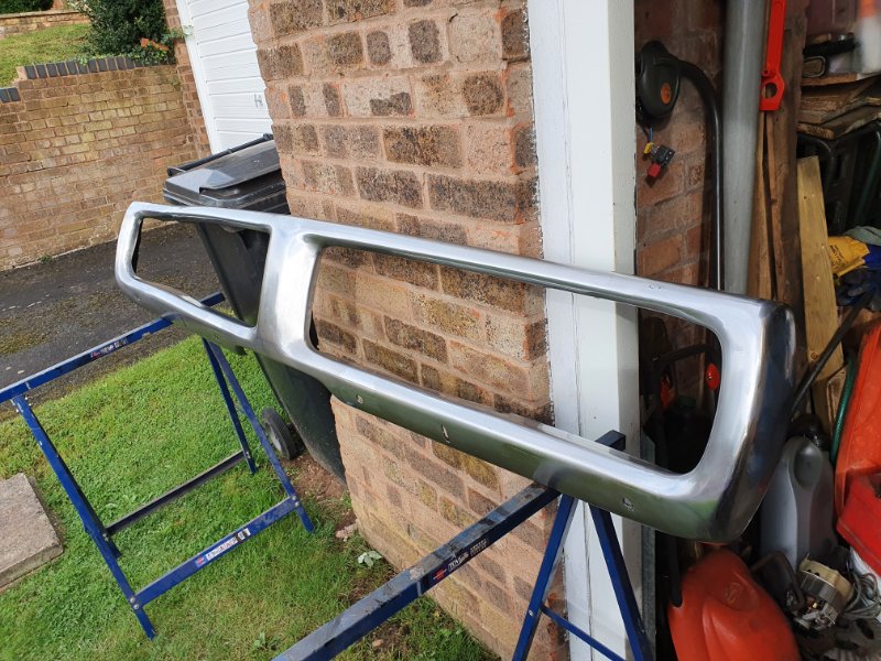

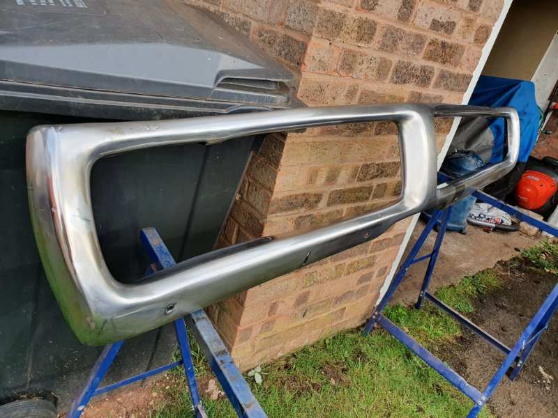

Originally I had planned on painting the bumpers the body colour but the replacement rear I collected from the Nats last year is too decent a condition to scuff up and paint. So I've had a change of plan and decided to stick with chrome...just the issue of what was under the paint on the front bumper :-k
So this week I had a try at salvaging the front. Scrapped remains of the yellow paint off, knocked a couple of dents out, treated with rust converter inside then painted gloss black. Then went over the outside with a 320grit finishing/scouring pad followed by 1500grit finishing/scouring pad and AutoSol.
Far from perfect, paper thin in places and a couple of holes in it but I think its quite usable for now.

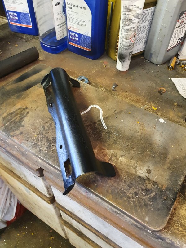

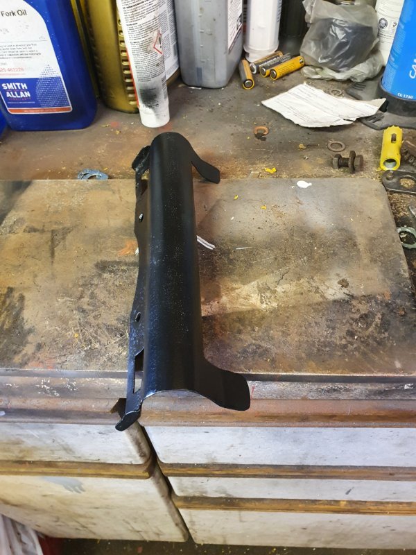

Another piece of the puzzle ticked off, the bracket that holds the number plate hinge.

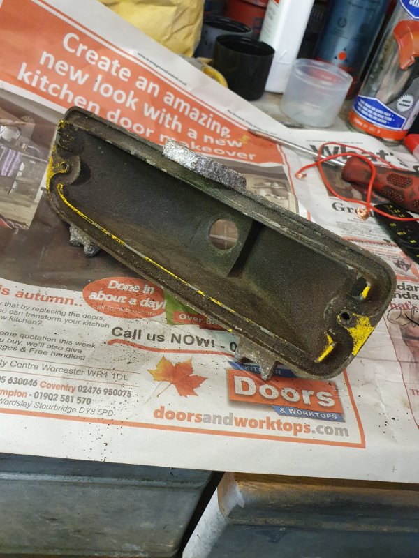

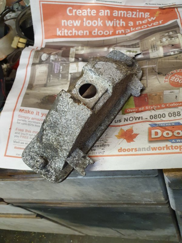

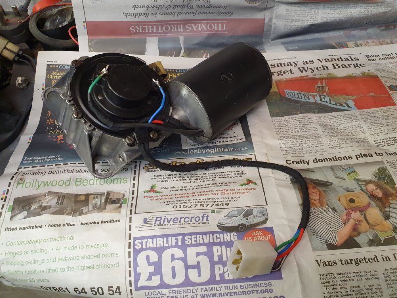

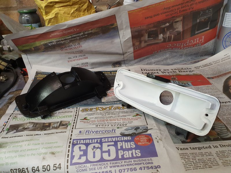

Not got anything significant to report on the Charger as such. Cleaned up/painted the Parking light housings and enlarged the hole for the new bulb sockets. Also stripped the wiper motor down for a refurb, bench tested and it works apart from the self park but I'll live with that.

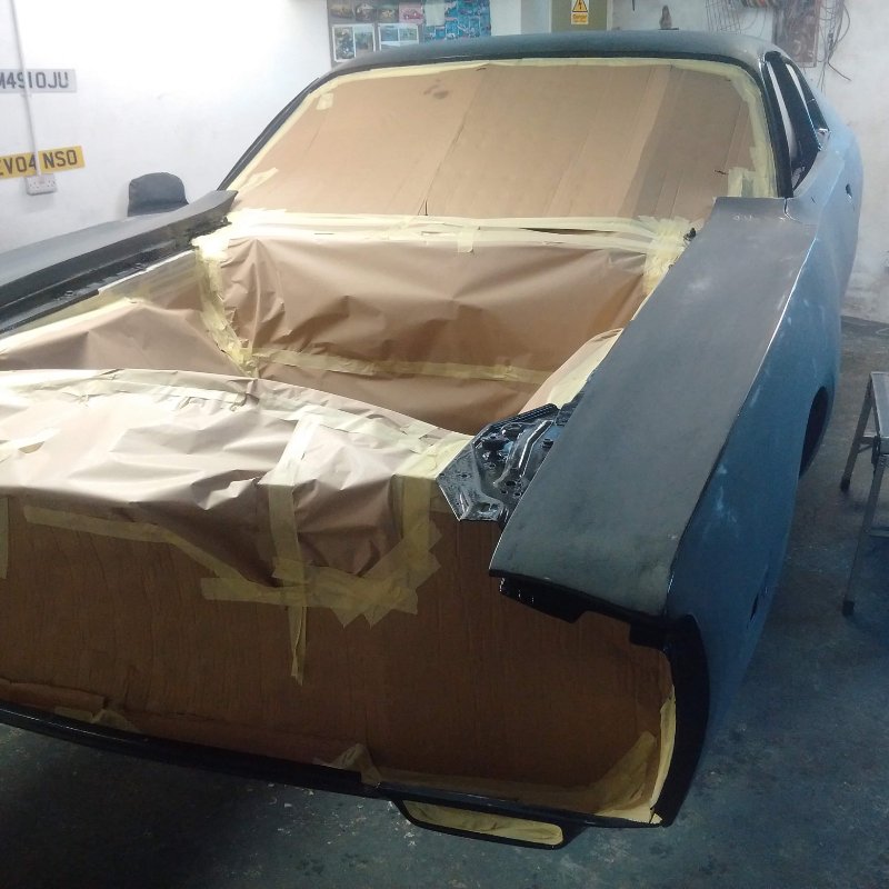

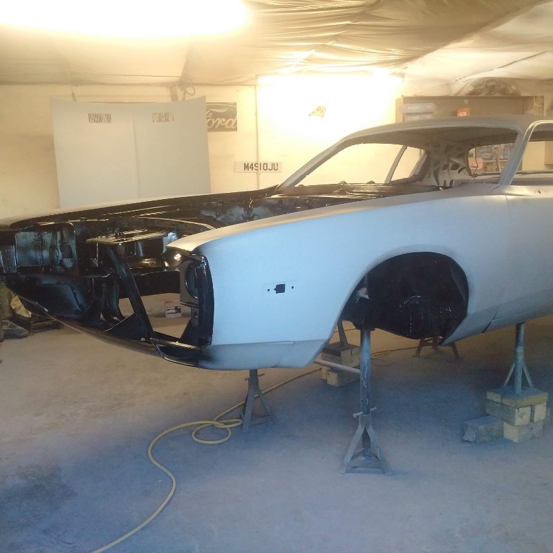

Ah well it's the end of the Feb half term week and... I didn't manage to make the trip North, the island was locked down due to a large number of covid cases.
Going try again at Easter all being well and it'll give me time to collect a few more bits.

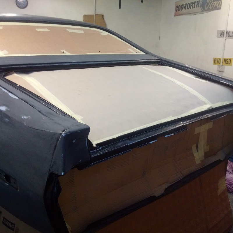

Stephen sent some photos through last night of the shell in it's guide coat, so here's couple.
