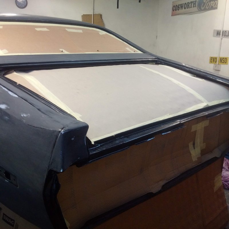

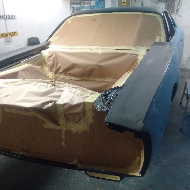

Stephen sent some photos through last night of the shell in it's guide coat, so here's couple.
