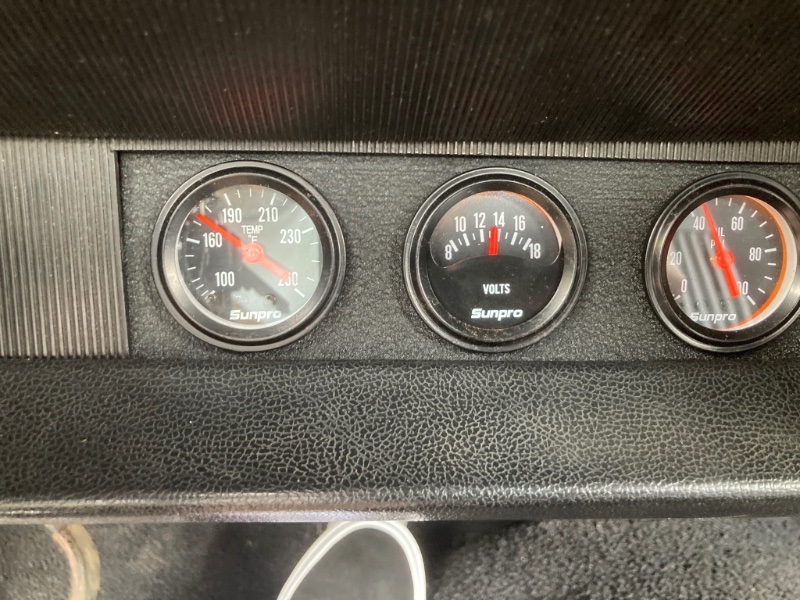

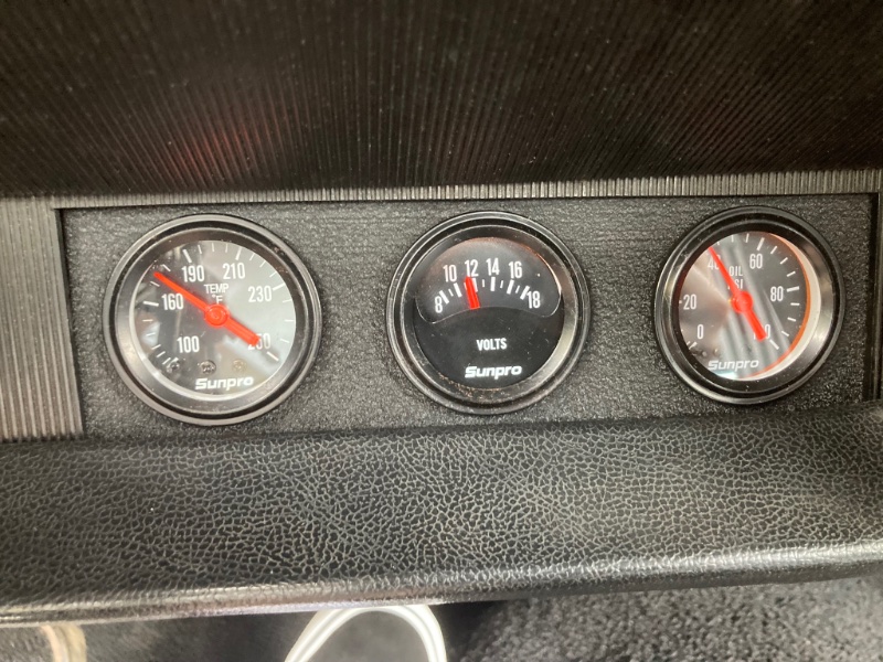

Happy to report no fuel leaks and battery overcharging woes seem to have gone thanks to the borrowed voltage regulator.
Went for a spin after having a bit of a game setting the float level on the secondary bowl and although it was running a bit rough, didn’t have any real issues.
Picking up vacuum gauge on Wednesday and will try and get it running right, but seemed to stutter under gentle acceleration so clearly haven’t got the mixture right. Alarmingly big jolt into drive and reverse too.
Overall, pleased to have learned a hell of a lot and put my ignorance and fear of carbs behind me. Now planning some plumbing upgrades for the near future and have plenty of time to do the alternator conversion at my leisure now. Props to Scotty Dave for the loan of the VR.
Happy gauges at idle and with a bit of throttle in the pics.

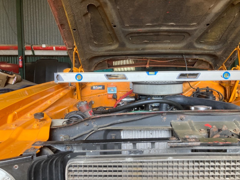

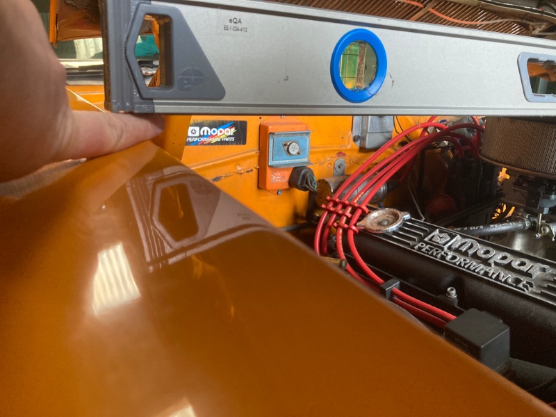

Next jobs on the list. The top of the air cleaner housing is getting scuffed on the edges, which led me to believe it was fouling the bonnet under vibration, so spent some time trying to peer through gaps with a torch and think I only have about 1-2cm clearance, so going to order a drop base and refurb the top that I have. Bit of hose fettling needed, so with that and changing the alternator, thinking it’s a good enough time to swap out the electric fuel pump for the mechanical one and do some plumbing upgrades.

I know you have it sorted now, plasticine is always hand for checking clearance where you can’t see the gap

Cheers Mark. That’s a great tip, can’t believe I didn’t think of that! I’ll have to raid daughters craft draw and see if I can find some.mopar_mark wrote: Tue May 17, 22 3:51 pm I know you have it sorted now, plasticine is always hand for checking clearance where you can’t see the gap
