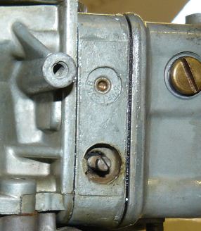

Posts: 8368
I take it this is my vac port? It appears blanked off...
vac port.JPG (27.2 KiB) Viewed 727 times
Dave-R
Posts: 24752
Post by Dave-R »
db wrote:I take it this is my vac port? It appears blanked off...
Yep it has been blanked off. Shame that.
