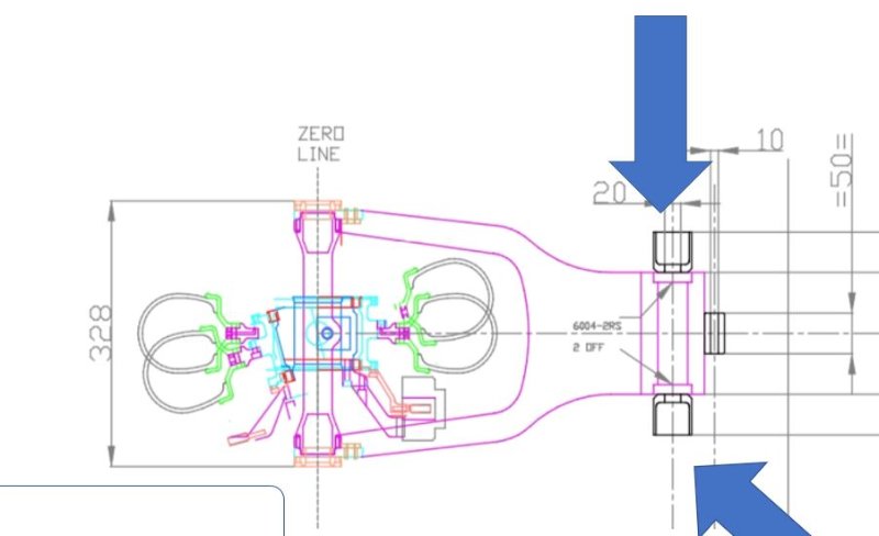

Re: Fifty shades of Jade
Posted: Mon Jul 20, 20 3:05 pm
by autofetish
The front end will use a single swing arm design abit like the rear end of a normal bike :reindeer: :-k
The interface from steel tube to swing arm Pivot points will be via these steel bushes made on a lathe.
They will be held in a fixture and frame tubes brought up to them.
If that makes sence ..
