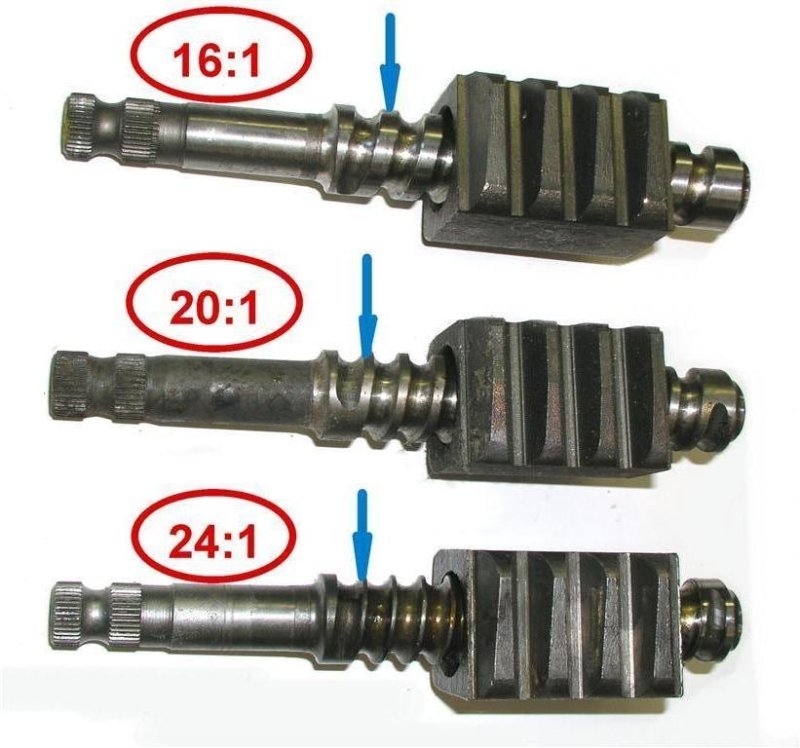

worth considering a swap to 16:1 or 20:1 ratio if its a 24:1 box. 24:1 fine for drag racing but driving round twisty roads needs a better ratio in an A bodymygasser wrote: Mon Apr 12, 21 12:16 pm i just bought a manual steering box from dustymopar on here so i probably won't need to ding the stainless headers now.![]()
the hardest part is stumping up the cash for the ballnut n screw....there is little to worry about inside the box.. a mornings filthy work
if you buy a ballnut and screw don't be tempted by cheap truck ones their thread goes the opposite way for cab over operation,
left would be right etc. fine in a clowns car not so good for the street
oh yeah the grease to fill the box is also about £45....if you buy it in retail packs
the box is based on a reversed (as in the hot rod sense, splined input from opposite end of box) saginaw 525 "like" design, just different enough not to be a saginaw box i.e a 1970s ford balllnut might...MIGHT..... work if you can cater for spline and length mismatch

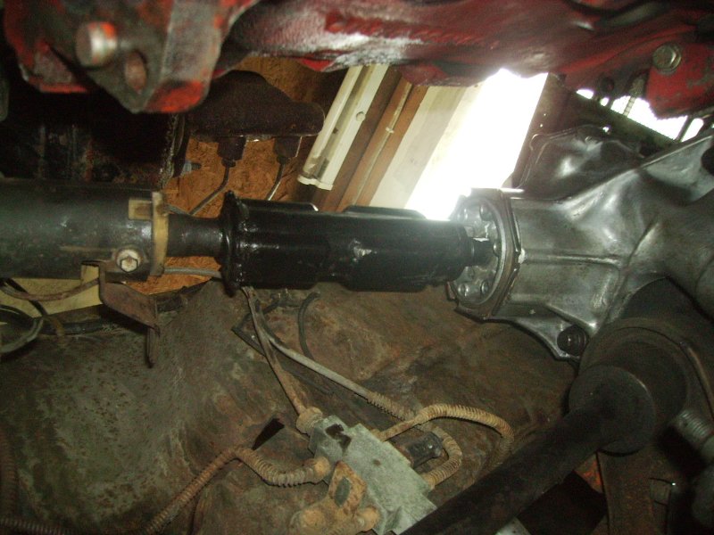

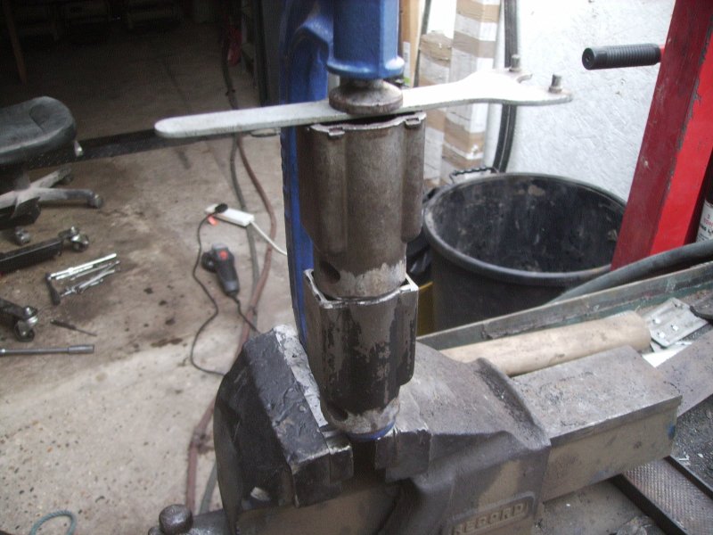

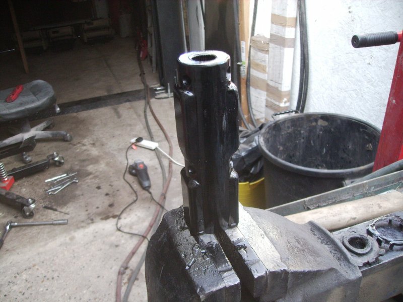

today it was 2 steps forward and 1 step back. to get sensible access to change the steering box i needed to undo the engine mounts (again) and drop the headers which were just hung in place luckily. so with the power box removed and some heat and a puller applied to remove the pitman arm i bolted up the manual box. next issue the column's too short. i was quite happy cutting and extending the column but i though i'd check on the 'for A bodies only' forum i'm on first to see if the collapsible bit would slide out the 3" ish required. the general concensus was 1, a manual column 2, a mancini coupler (longer i assume) or 3, extend the power column. then i remembered my manual box had come with a coupler attached, so i measured it and at 3" it would give me what i wanted once i'd welded the 2 couplers i had together. all done now and next i'll be refitting the headers (again) and bolting the engine mounts down (again). as i said 2 steps forward...............

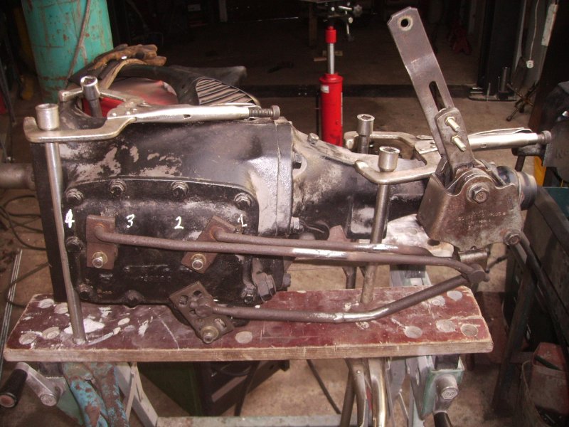

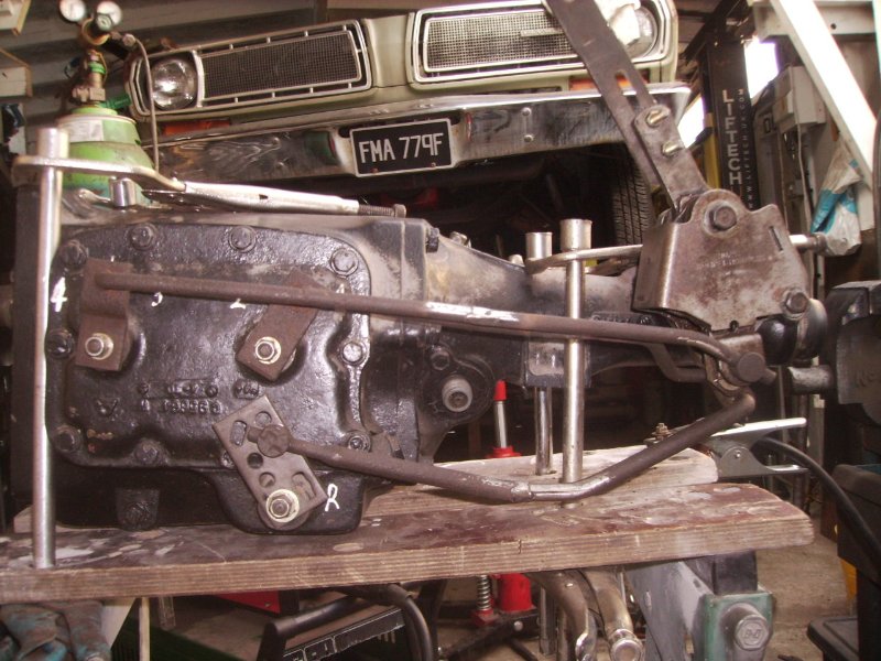

this afternoon i sorted the shifter, rods and levers to set up the hurst shifter i bought a while back. i had a mix of stock and aftermarket levers, rods that were all too long (B body maybe) and the hurst shifter. ''best get this done before it's in the car'' i thought to myself and i'm glad i did as it took me about 4 hours of cutting the rods, clamping the overlapped pieces together, checking the movement etc etc. finally with the overlapped rods tacked and working i removed them one by one and cut them to be butt welded for good. i now have a smooth shift in all gears even with my short makeshift alternator bracket shift handle, lol.
