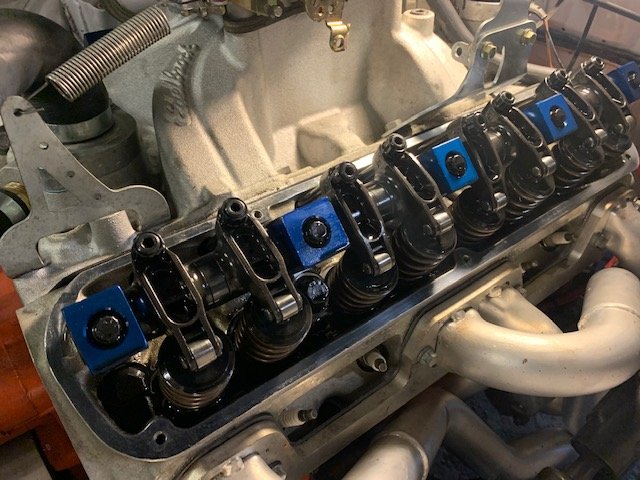

Set the valve clearances for the first time since the engine was new. Most of them were spot on , with a couple of very small adjustments needed for the rest.
Whilt the covers were off I torqued down the heads . Edelbrock 'recommend' the heads are retorqued after a short while, but of course I hadn't done it. Was quite surprised to get around ten degrees movement on some of the bolts.

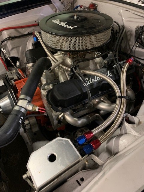

THe PCV system had to go as it was sucking oil into the intake occasionally, mostly at the end of long straights followed by right-handers. No-one seems to use a PCV on circuit race cars anyway.

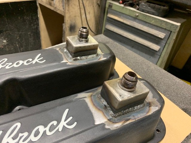

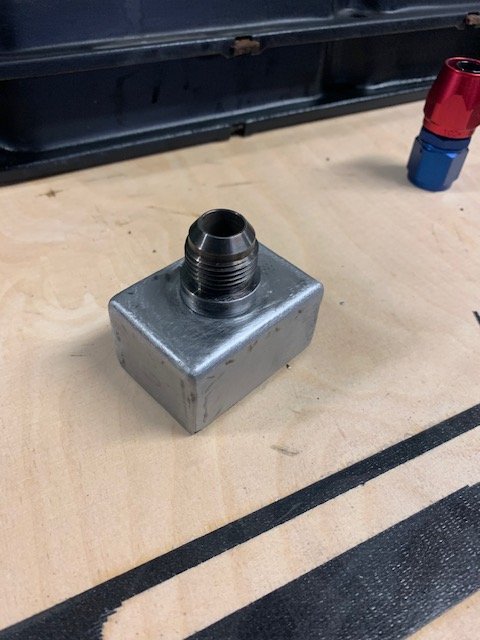

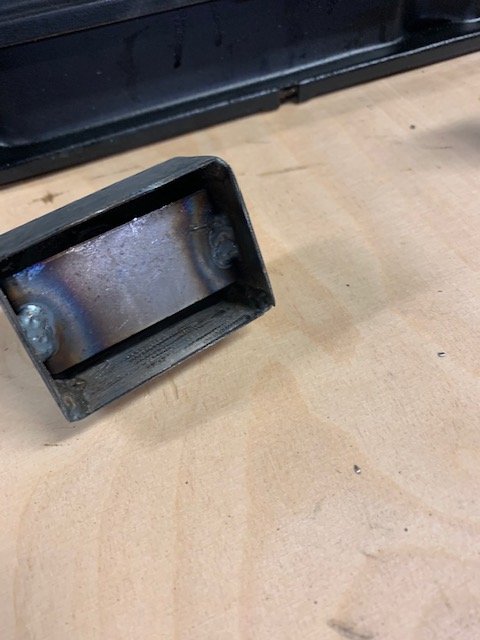

Made up a couple of small baffled -10 fittings to weld to the rocker covers . Other people seem to use -12 but I had the -10 stuff in stock so thought i'd chance it being big enough. Each rocker cover outlet now leads to the catch can by the rad. I still need to add an oil filler neck to one of the rocker covers though, as trying to top up the oil through one of the -10s is, of course, really tedious.

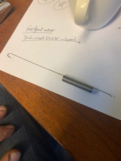

1) Found one of the throttle return springs lying next to the intake manifold, with the end broken off

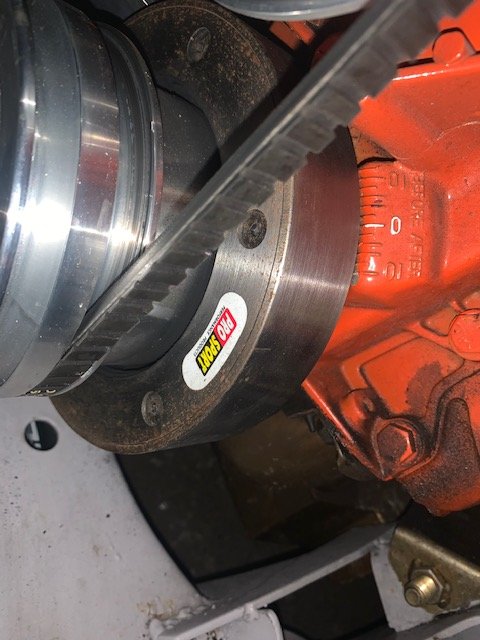

2) And if anyone's thinking of buying a Performance Products crank damper, I wouldn't recommend it. I was checking the car over before venturing out onto a frosty Goodwood, and found the outer ring spinning freely on the inner hub, also with a few mm of radial play. The damper can't have seen more than 40 hours use. Oh well, day cancelled. THe organisers gave me a credit against a future track day, which was very fair of them to say the least.

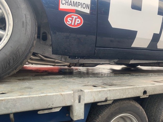

I took the opportunity to measure the tailshaft height of the Tremec installation, compared with stock. THe Tremec output shaft turns out to be sitting 30-35mm lower than stock, with the trans unable to mount any higher, since it's practically touching the TB crossmember.
This isn't quite as bad as I was expecting. Probably not worth the work altering the crossmember. I thought that the gearbox height was creating the problem with ground clearance under the header collectors, but maybe it's mostly that the headers themselves are constructed lower than I would like. Bearing in mind that I would really like the car to sit around a further inch or so lower than it is currently, then I may have to look at different headers.

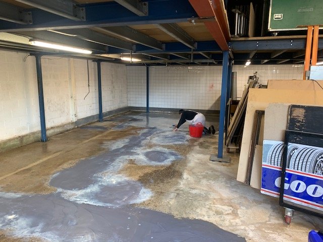

I rent a barn/workshop at the farm across the road from my house, and after 4 years I've finally got fed up with the rough, uneven concrete floor. Bit reluctant to improve somebody else's floor, but eventually decided to treat myself to it. I figure I've got a few more years there, and after all, the rent's reasonable.
Here's the low parts already filled in, with a very thin adhesive screed starting to be trowelled out over the top. Working on about half of the floor at a time, with stuff piled up on the other half.
Should be finished and painted around New Year.
Can't beat ATI, Matt.
I had another SFI approved damper on my grown-up Block and that worked loose as well.. you get what you pay for....
re the header to floor clearance, if you were to modify the tb crossmember to raise the gearbox that would also raise the headers as it would lift the back of the engine too taking the headers with it. just a thought. you'd get the gearbox where you know it 'should' be and get more header clearance at the same time. 2 birds with 1 stone type of deal.
