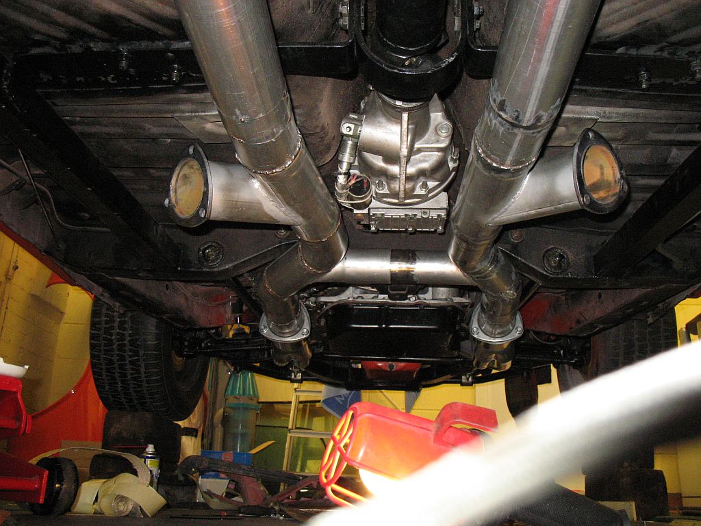

Getting close to finishing.
I had to bend the left side cut-out away from the speedo cable into the GV unit.
Completely ignoring my own advice to only tack weld until the whole length is complete, I had to change the angle of the cut-out after welding it because of the emergency brake being in the way of the muffler so now the left side cut-out turns down over a half inch more than on the right side.
It is annoying but something people probably will not notice with the car on the ground.
Other that that the system has quite good ground clearance despite being somewhat lower that the stock TTI system is supposed to fit.
I might have time to mount one tailpipe tomorrow night.
I also wrapped the speedo cable in protective tape where it comes close to the pipe. You can see how close it is in one photo.

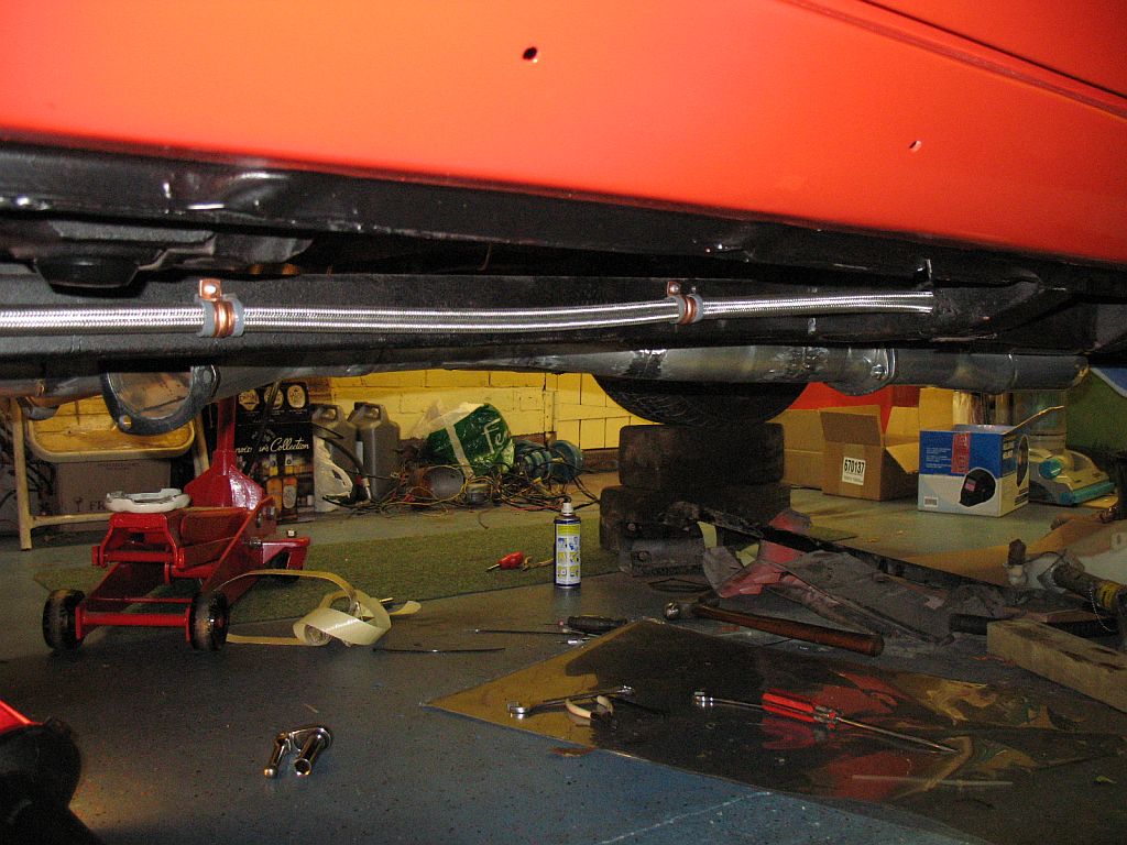

Great work Dave! Can I ask if you are fitting rubber hose round the braided line as it goes through the chassis in case of chaffage due to vibration?

Kev wrote:Great work Dave! Can I ask if you are fitting rubber hose round the braided line as it goes through the chassis in case of chaffage due to vibration?
I have a plan on that front. Some stuff I have here at work.
Although I suspect that it will be the stainless braiding chaffing the chassis rather than the other way around.
Also a length of insulated and armoured cable containment tube that will be ideal for that exposed length on the subframe connector.

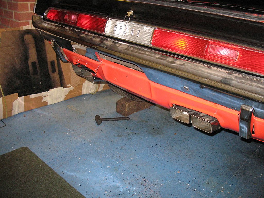

Took a day off work. Finaly got the exhaust fitted.
