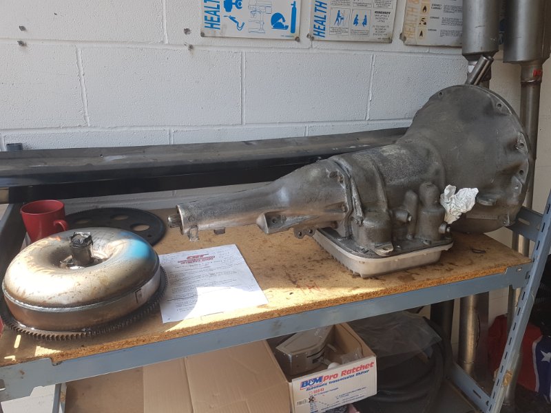

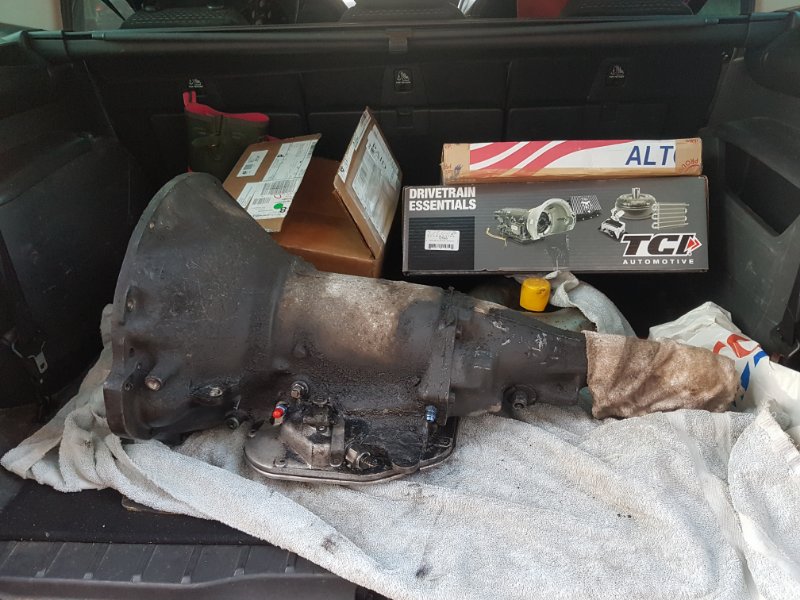

Last week removal and transport of the offending piece up to Crewe for a rebuild along with the all new shiney performance stuff.

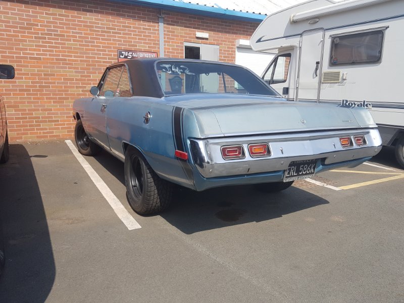

Picked it up today with all the new stuff installed.
Its a little bit cleaner than when it left. Converter was checked and all is fine.
Posts: 7149
Re: Dave's 72 Dart
Sitting a little high, must be missing some weight........more bits to go in and on.

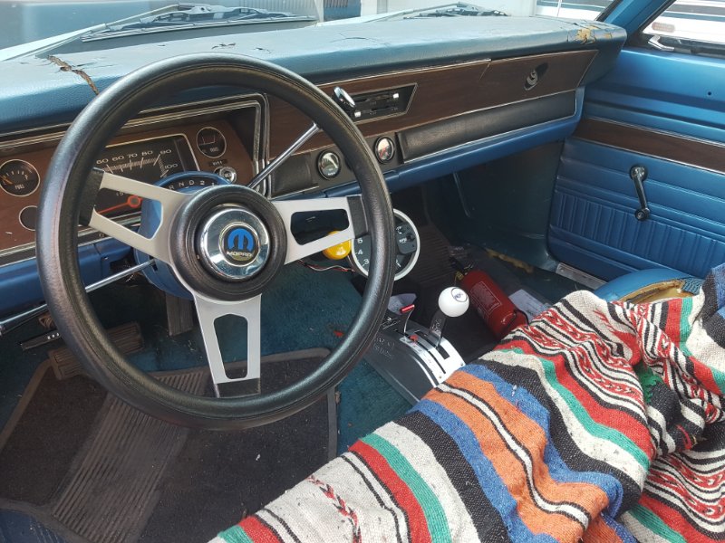

I picked the car up last Thursday after all the work had been completed. Shifter was all in and working.
Posts: 7149
Re: Dave's 72 Dart
So after 8 years the car is now a floor shift car. What i will say is that i only grabbed the column 4 times in 5 mins when moving the car around.........that may take some time to get used to.
The trans......... :shock:
Quite simply one of the best mod to date. Its probably the most mechanically unsympathetic thing ive ever had. The term banging gears is spot on, as the thud it makes on every change is quite something.
Being reverse manual feels quite normal already.
